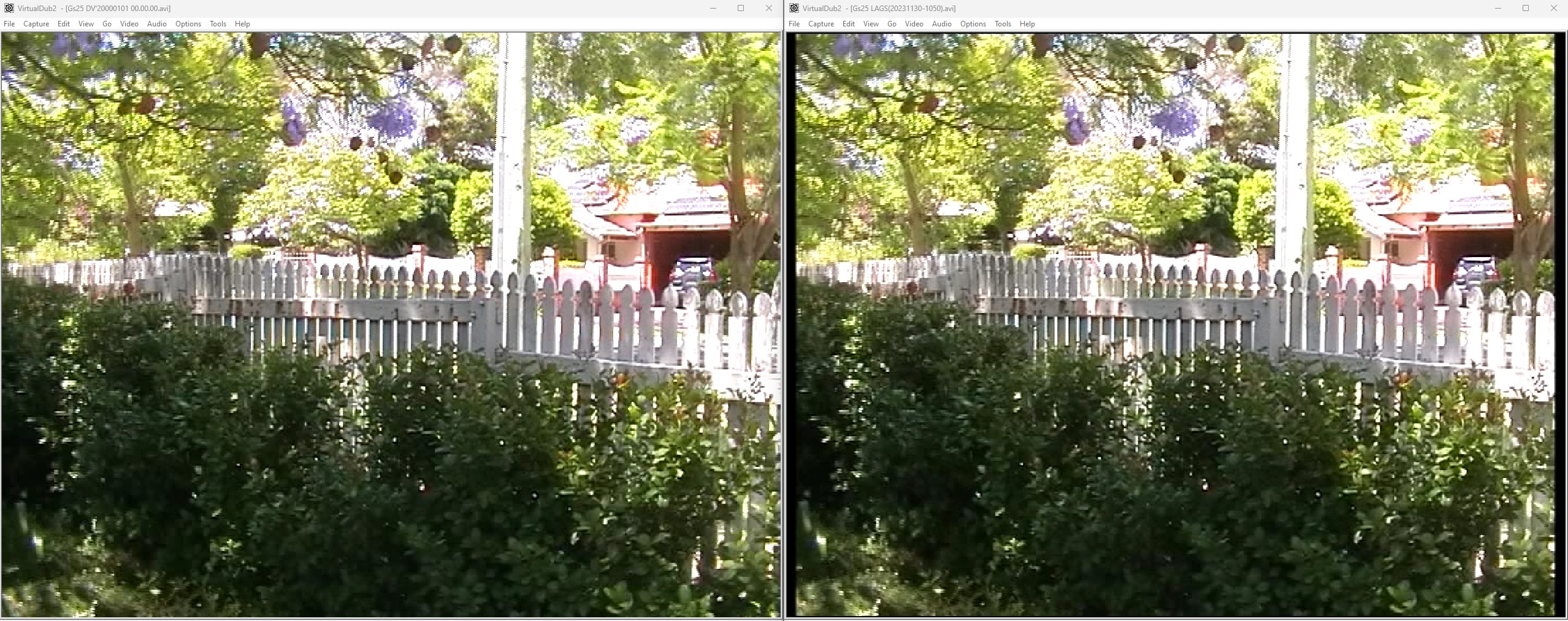

  1. When I capture a Hi8 tape shot in 16:9 aspect ratio via s-video on my Sony DCR-TRV460, everything looks great except pixels are missing on the left and right sides versus capturing with firewire.
    Here's an imgsli for easy comparison: https://imgsli.com/MjQwNTgz.
    Notice the top left of the thumb cut-off in the s-video version on the left, and the lower balcony continuing on further in the firewire capture on the right.
    Here's the firewire capture:
    [Attachment 77070 - Click to enlarge]
    And here's the same frame with s-video capture:
    [Attachment 77069 - Click to enlarge]
    I've tried capturing with the TBC setting in the DCR-TRV460 menu turned on and off, and it doesn't make a darn difference. The pixels are cut off on the left and right no matter what.
    I've Googled my brains out for the last few hours trying to find another soul who has encountered this issue, but so far it seems to be just me!
    Is there any way to avoid this? I do notice that the firewire capture has some kind of noise on the left side, but not on the right, and it's clear that pixels are being cut off on both sides of the s-video capture.

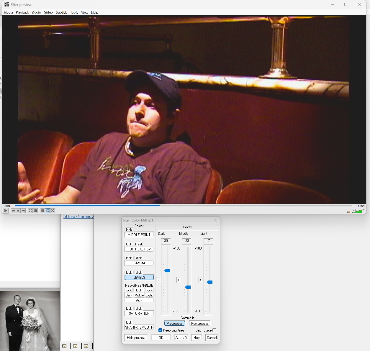

    For the S-Video capture, I used the histogram in VirtualDub to set the brightness and contrast such that the values were mostly in the non-red range. For this tape, that meant brightness=100 and contrast=32. It does seem a bit dark, but if I bump up even to brightness=101, then I get a little red on the far right, and at brightness=102 I get lots of red on the far right.
    Brightness controls the overall position of the histogram so yes, if you increase the brightness, the right edge will go "more red". In that case, just lower the contrast a bit, which controls only the right edge.
    The analogue capture looks good to me; I wouldn't recapture: I'd adjust the levels with Colormill in VDub. With it, you can boost only the darks and leave the brighter areas alone. If you simply use the histogram, you'll brighten the whole screen up.
    [Attachment 77084 - Click to enlarge]
    As for the DV capture, definitely worse in this case. DV struggles with low light and AFAIK there isn't any way of adjusting the levels until post-capture processing.

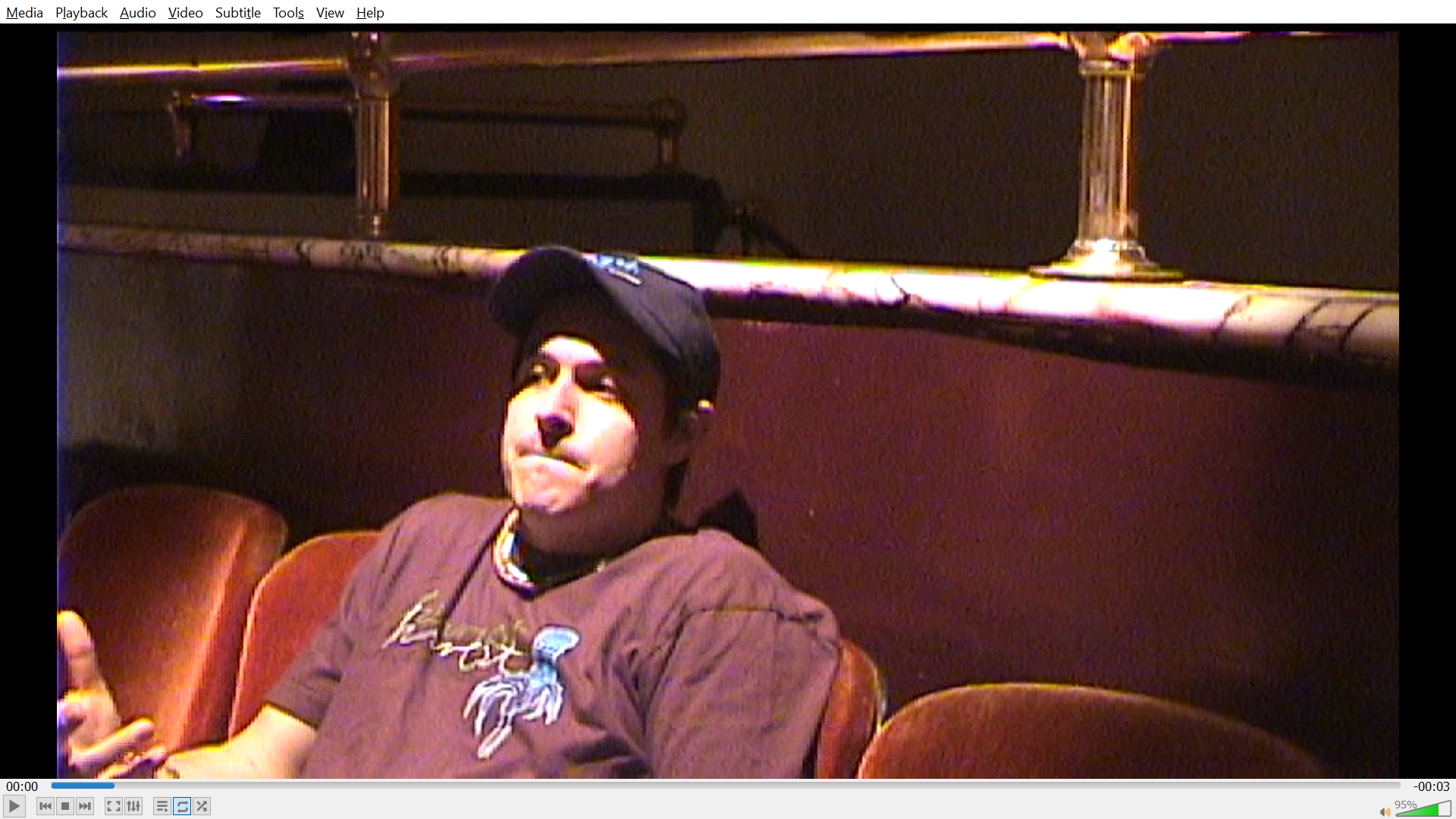

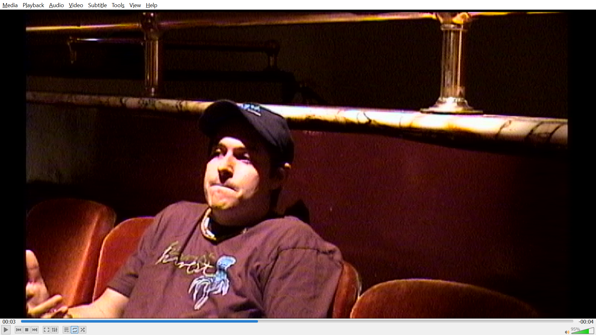

  14. I just did another s-video vs firewire capture comparison with another tape, this one shot in the default 4:3 instead of the "16:9 Full" mode from the previous tape that I posted pictures of. There are still more pixels on the left and right in the firewire than the s-video, but there's no blue artifact on the left, although the overall picture quality is still quite blocky and grainy.
    It's too bad I'm losing pixels on the sides with the s-video capture, but I'll take it over the firewire ick capture.

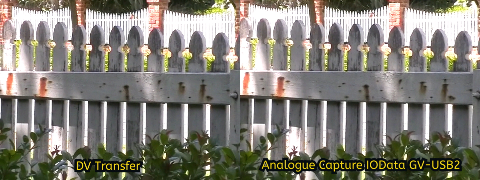

    Fair call. Here is a completely unretouched comparison, DV verses analogue GV-USB2. The pillarboxing (if you could call it that) of the S-Video version is pretty much blanking the area shown by the DV version.
Name:	DV Left S-Video Right.jpg
    Which is perfectly normal and to be expected. The DV frame carries a longer scanline than what the length of the active picture in an analog video signal shall be. To put it into numbers, the DV frame carries a length of 53.333 µs (microseconds) worth of picture in one scanline, but only 52 µs of those are needed (in 50 Hz systems) for outputting S-Video.
