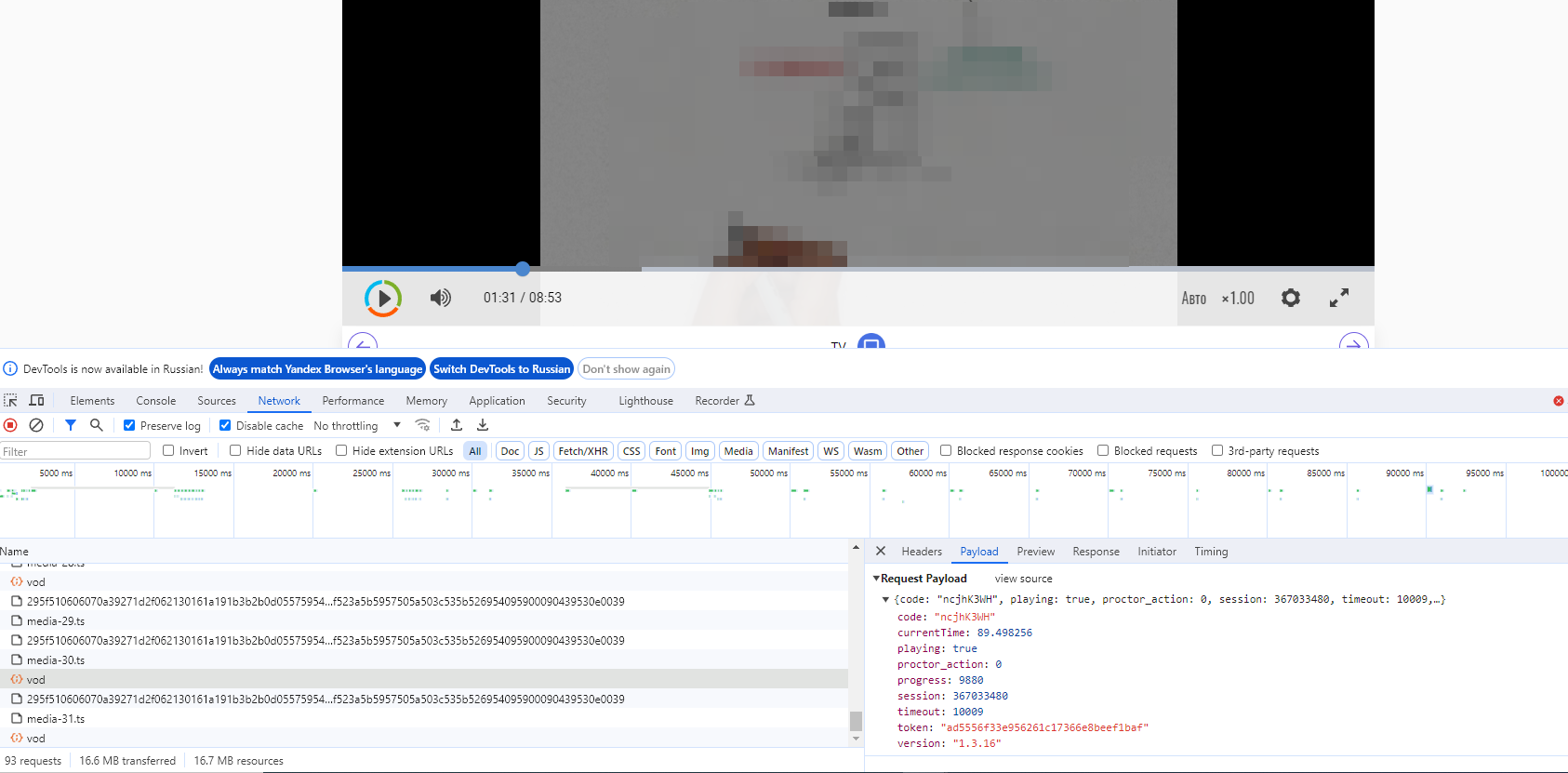

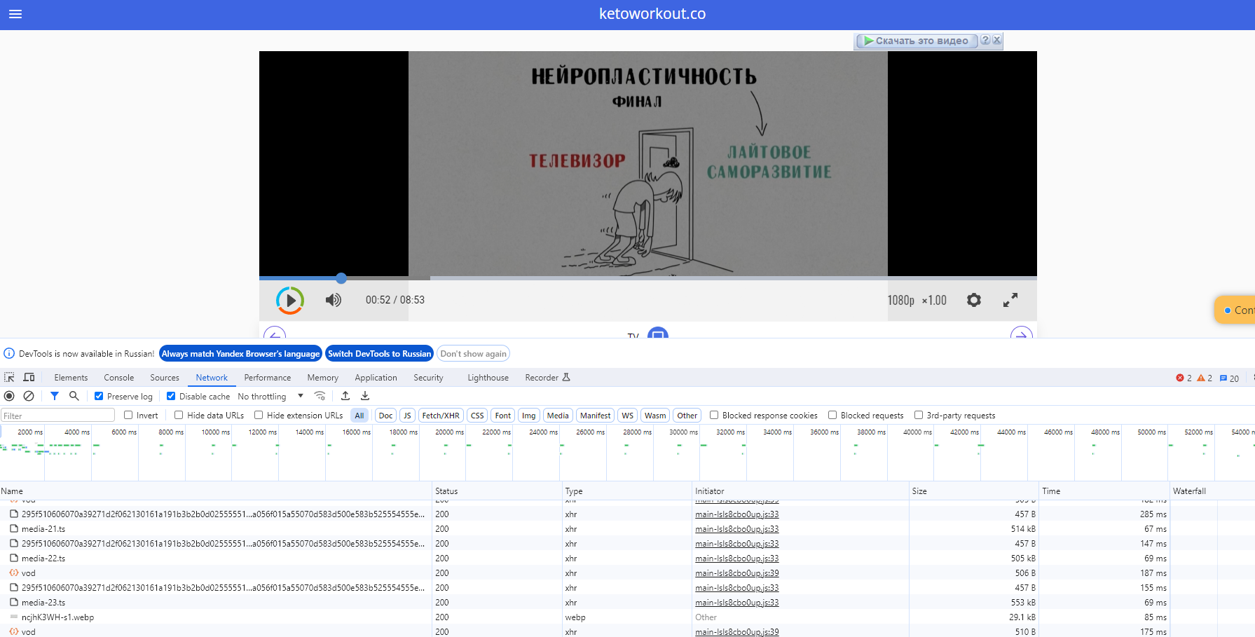

I decided to save another course, but while saving I found a very interesting moment and I think you will find it very interesting because I think Boomstream has implemented a new security system!
Boomstream video player
[Attachment 77049 - Click to enlarge]
If you start the video at this moment, there is a delay code on this segment.
[Attachment 77050 - Click to enlarge]
The coolest thing is that the script ends with an error, but part of the video will be downloaded! the question is how to get around this error I have already tried all the keys. either it requires some kind of delay between fragments, or there is some kind of pre-check with the keys.
What do you think?

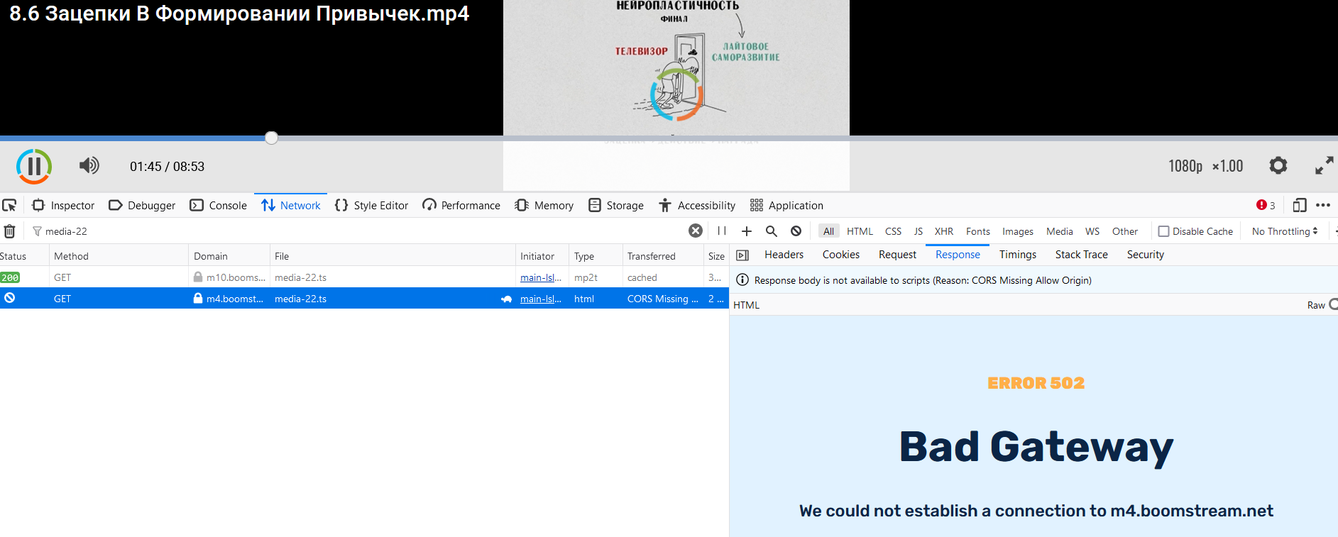

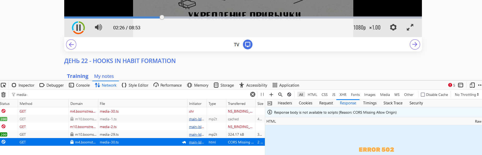

Can you even watch it fully in the 1080p version? I get some dead fragments and I don't know if it's their vod mechanism messing with it, or their server.
I could try downloading a lower resolution but I wanna be sure the 1080p is broken.
[Attachment 77055 - Click to enlarge]
Edit: was this link embedded somewhere before? Could you watch it fully there?Last edited by 2nHxWW6GkN1l916N3ayz8HQoi; 16th Feb 2024 at 15:48.

I have random fragments stuck on Firefox as well.

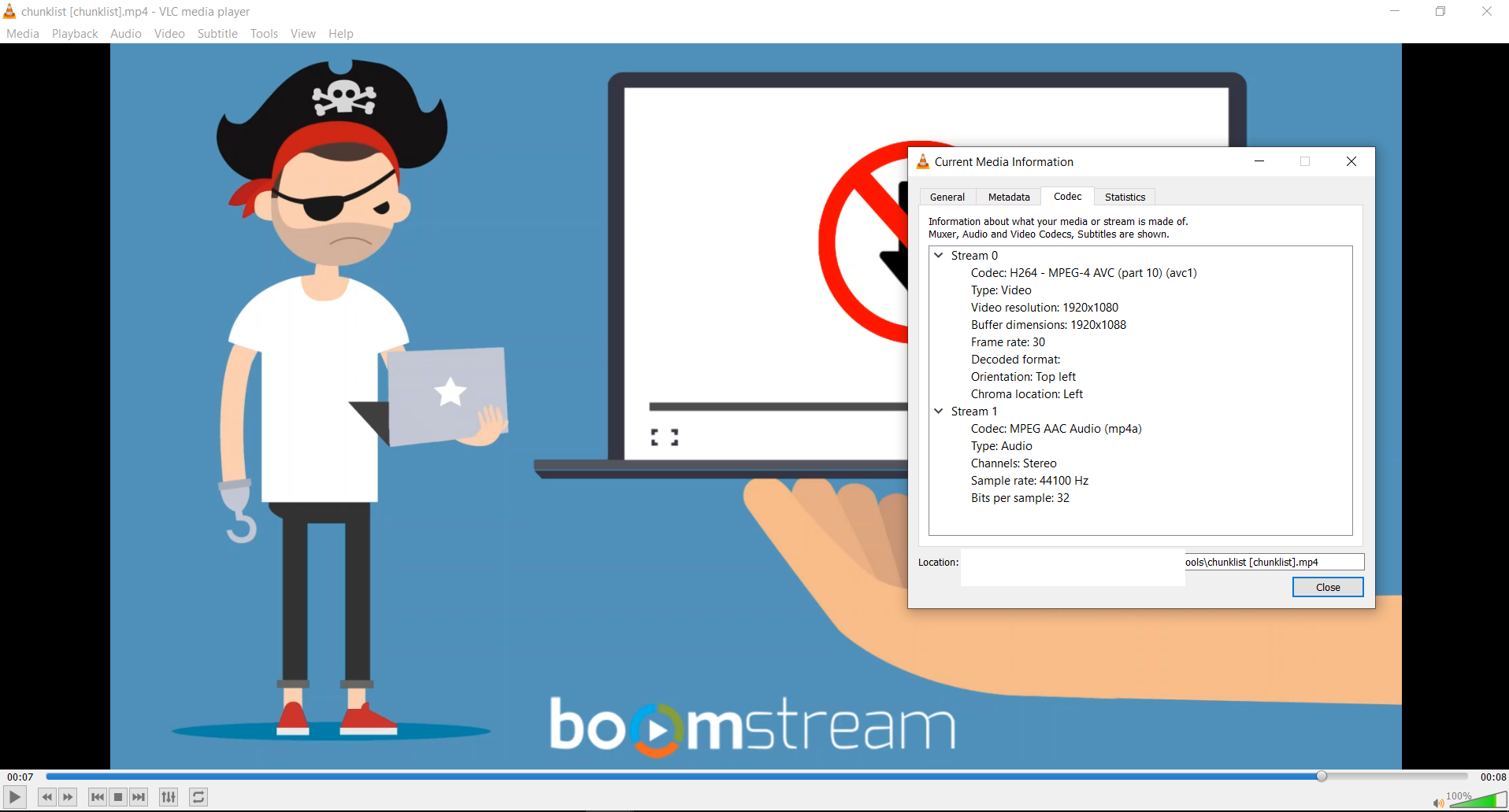

I really don't know if it's me or their "pinging" vod mechanism. There is a "fix" though at least. If you generate via a script, a proper m3u8 file using the right key and iv, and replace those "dead" fragments with other ones from lower "acceptable" resolutions (like 720p), the downloading works. However that brings another problem. How can you fix a video with multiple resolutions in the same video track?
VLC is smart enough to play it, though when it changes the resolution for some random frames, it is temporarily a black screen while the audio is playing uninterrupted. The black screen isn't from the video data, but rather because VLC does a transition. The codecs used by both resolutions are the same, the same fps, etc. Only the resolution differs. I guess you could fix it using ffmpeg and resize only those parts and leave the main ones the same, but I'm not knowledgeable enough to do it.--[----->+<]>.++++++++++++.---.--------.
[*drm mass downloader: widefrog*]~~~~~~~~~~~[*how to make your own mass downloader: guide*] -
[Attachment 77072 - Click to enlarge]
Same problem (on any browser), though now it seems there are other fragments dead. Kinda hard to figure out their mechanism when the video doesn't even play on its own and is stuck loading
And funny, pretty much any resolution they offer is stuck on random parts. Oh well.
I don't think it's a satisfactory solution but rather a cheap workaround. Maybe Silver can get it using Tubedigger. You shouldn't settle for lower resolutions. Even if you get the video, it has multiple resolutions in the same video stream and needs resizing.
If you wanna see what kinds of problems you can get from multiple resolutions in the same video you can check it:
https://www.transfernow.net/dl/20240217cgUog89r
VLC inserts blank screens when it changes resolutions and that's why I wouldn't settle in any way for this.

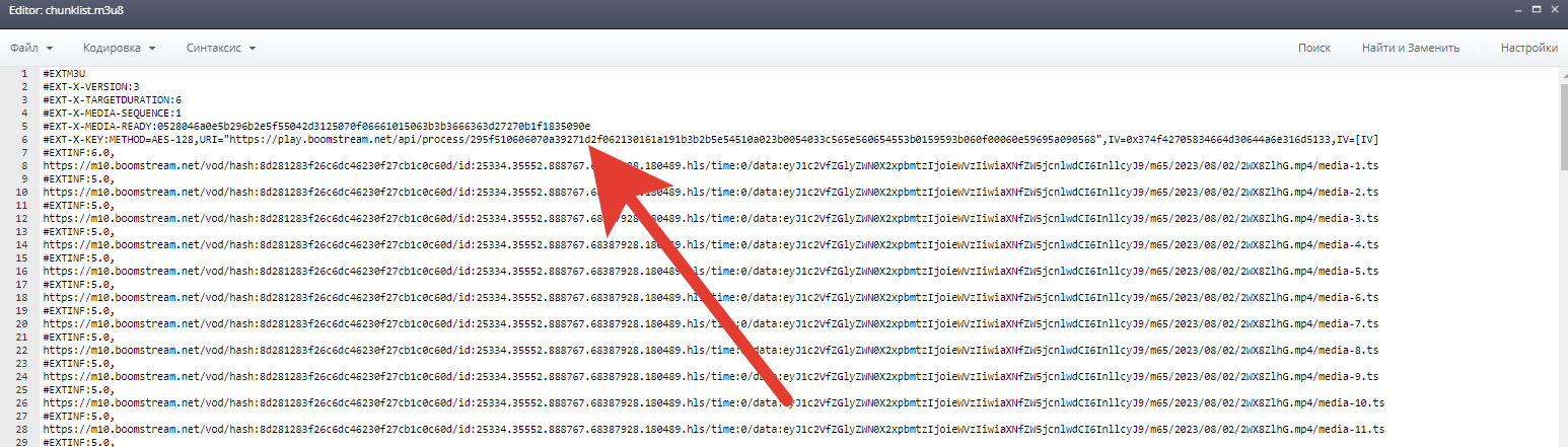

Edit: If you do indeed claim you can watch the ENTIRE video without problems on max 1080p you could try this. Download the m4 chunk m3u8. Edit it in notepad and replace this line:
Then upload that file somewhere like https://tmpfiles.org/Code:#EXT-X-KEY:METHOD=AES-128,URI="https://play.boomstream.net/api/process/295f510606070a39271d2f062130161a191b3b2b5c03550f023c045c513e535f55565953395259533b0354520055563b5b5c5966",IV=0x6862756169474e525539516f626c6959
And use yt-dlp on the generated link.Last edited by 2nHxWW6GkN1l916N3ayz8HQoi; 17th Feb 2024 at 02:47.

https://play.boomstream.net/api/process/295f510606070a39271d2f062130161a191b3b2b5c03550f02 3c045c513e535f55565953395259533b0354520055563b5b5c 5966",IV=0x6862756169474e525539516f626c6959
how to work with it and where to put it.Last edited by vvv84; 17th Feb 2024 at 02:10.

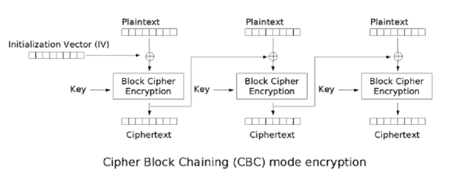

IV means initialization vector. AES-128 Encryption, CBC mode, uses a pair (key, iv) to encrypt* stuff. You can't do anything if you only have one element of that pair. You get that IV value by debugging the javascript code of that page. I'm sure it can be automated if you understand that code but I was lazy so I just extracted it directly.

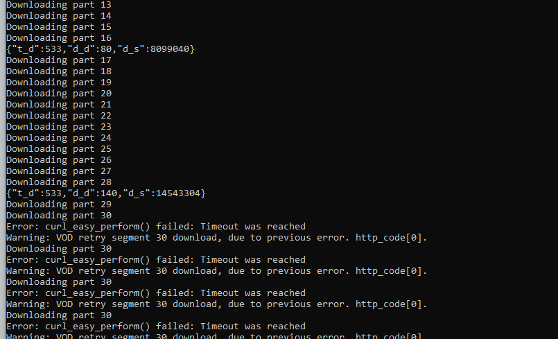

Yes, the fact that downloaded with cut fragments is not good I agree, but the point was that remove the fragment about which the script stumbles can download the video, so the problem is exactly in these fragments and there is some other algorithm to apply.

the script stumbles at frame 25.
and the video in good resolution at 25 frames also stopped and won't load any further
what else can I do?
