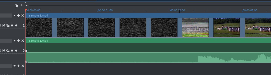

    You can hear it because there's no other sound; when the audio comes in, the thumping is smothered. As I say, I think it's a system sound; it's not part of the recording or static, per se. I'm thinking that I may have heard that type of noise before. You can see it on the timeline:
    [Attachment 77046 - Click to enlarge]
    IMO your only options are to either zero the volume until the soundtrack starts or crop the start/static off.
