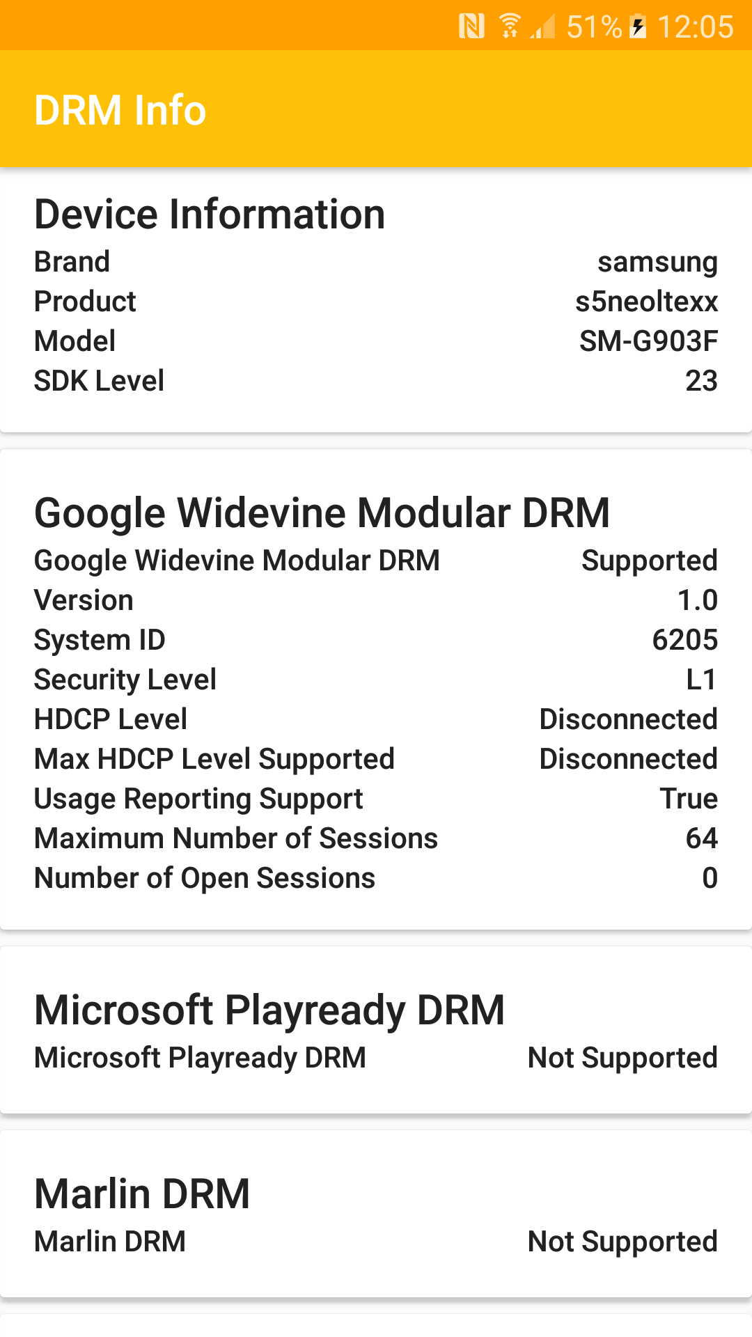

first of all, since your device use so old Android version, you must ensure your phone has CDM, and security level should be L3, download drm info app from Google play or other place, check your phone's info.
[Attachment 77015 - Click to enlarge] Seems it is but i cant update the Andriod version
Maybe not L1 only perhaps -
yes, it is L1 and you can use some scripts to force use L3. but you need update system now, if no official update, try some third-party rom, at least update to android 7 as @2nHxWW6GkN1l916N3ayz8HQoi said.
