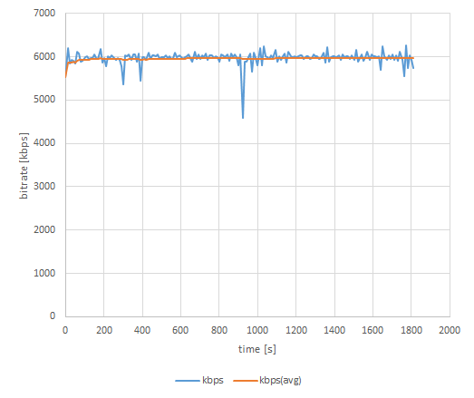

    I think I have a problem with the maximum bitrate of the videos because when I view the video on my TV in some places it freezes. I use a wifi to transmit.
    I am then trying to codify with different methods until they find a solution.
    I would like to view the bitrate produced according to the time to choose the best even in quality.
    Once I used Bitrate Viewer, but with the new codecs it doesn't work.
    I saw this graph.
    [Attachment 76994 - Click to enlarge]
    Someone recognizes what program was used?
    Alternatively, what do you suggest to use free?
    Do you also have advice on how to limit the Max Birtrate without the quality falls?
    PS: i have tryed FFBitrateViewer but it is not very precise

  9. I found the program that checks the bitrate: https://github.com/rigaya/checkbitrate
    But it is too stained to create the graphic.
    Create a CSV file but then you have to make the graph and the operation is not immediate.
