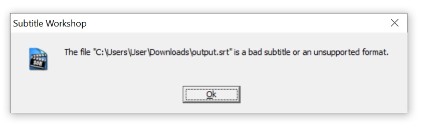

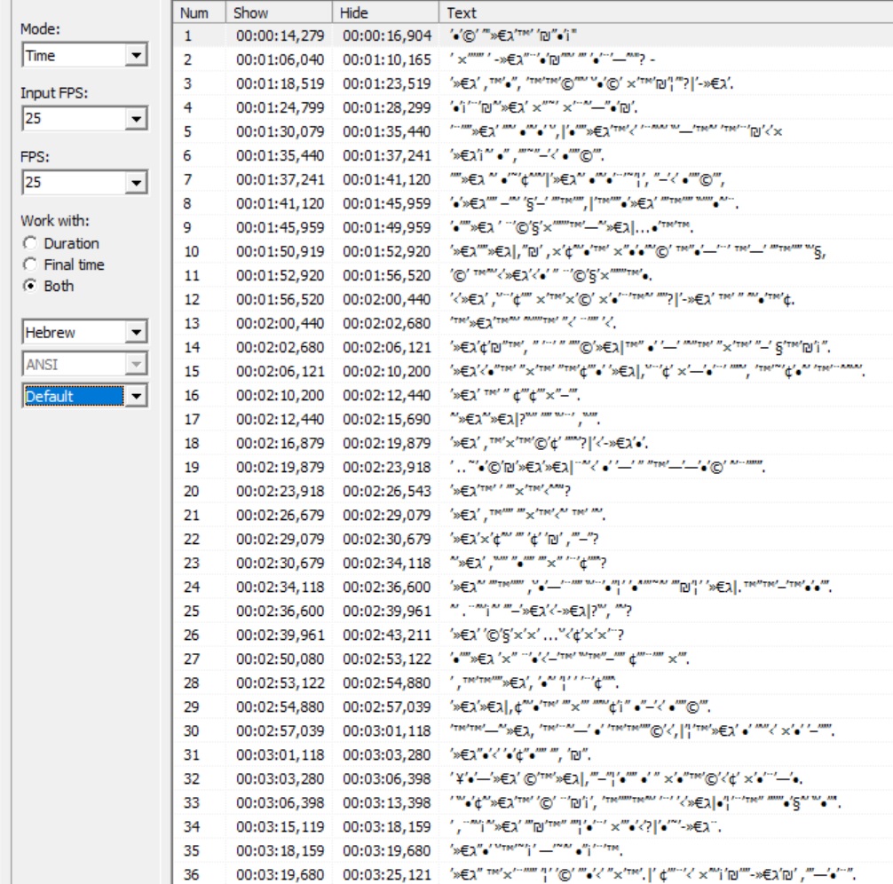

  26. by the way , after i succeed to save the dvbsubtitle to srt file . it's out of sync , and on subtitle workshop it's open like this...
    [Attachment 77027 - Click to enlarge]
    while it should be hebrew letters...
    i tried to fix it with subtitle edit, but still no luck

  30. Originally Posted by 2nHxWW6GkN1l916N3ayz8HQoi View Post
    Is this acceptable/decent enough? I don't know hebrew so I only compared the characters visually. There will never be 100% accuracy unless you write it by hand.
    [Attachment 77030 - Click to enlarge]
    thank you for the help... the problem i can't run it on subtitle workshop... i get an error... any idea why or how to fix it ?
