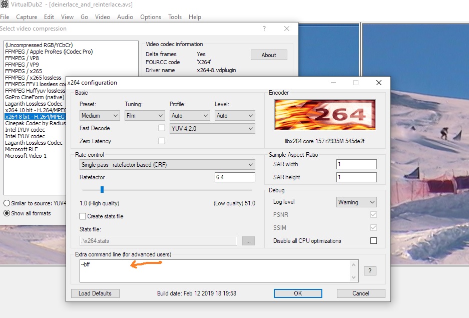

  7. It's still rendering as Progressive.
    In Vdub2 ? You have to put the field order in the vdub x264 settings box, either --bff or --tff

  12. Originally Posted by davexnet View Post
    In FFmpeg i meant. Thanks for that though, it did the trick. I suppose there's not much difference in quality between x264 and FFmpeg? Also how do you set the aspect ratio flags in x264? or is it better to just let the tv do that?
