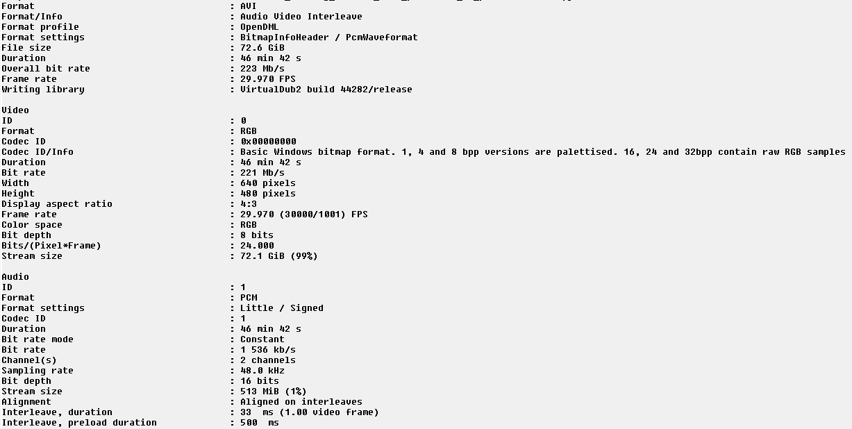

  1. I'm wanting to compress losslessly a 72 GB AVI video clip to (hopefully) less than 1 GB playable video clip.
    Output format/container doesn't really matter.
    What is the best software to compress the 72 GB AVI video to a much smaller size without quality loss (as far as possible)? And what settings should be used within the appropriate software?
    Here is the MediaInfo of the 72 GB video clip -
    [Attachment 76923 - Click to enlarge]

    What's happened is that you've converted the MP4 into "uncompressed" AVI format; that's the reason it's so big. That's indicated by video format from the Mediainfo readout: RGB. If you want to create a lossless, compressed AVI file, on the Save Video screen in VDub, with the Compression button, choose a lossless codec such as HUFFYUV or Lagarith, or whatever others you may have installed such as UT Video.
    That will yield you a file of around Jagabo's size, 24-32GB.
