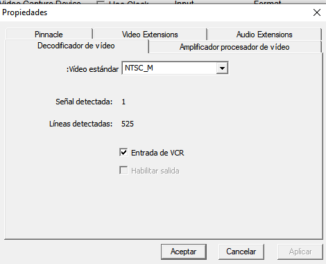

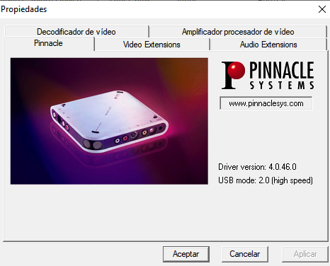

    What screen you get when you click on device setting on the Pinnacle 700-USB?
    I get this:
    [Attachment 76963 - Click to enlarge]
    Here are the video standard settings:
    [Attachment 76964 - Click to enlarge]
