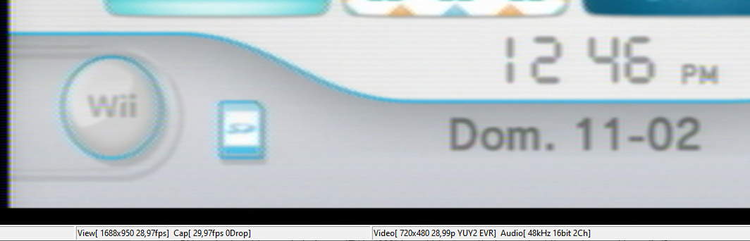

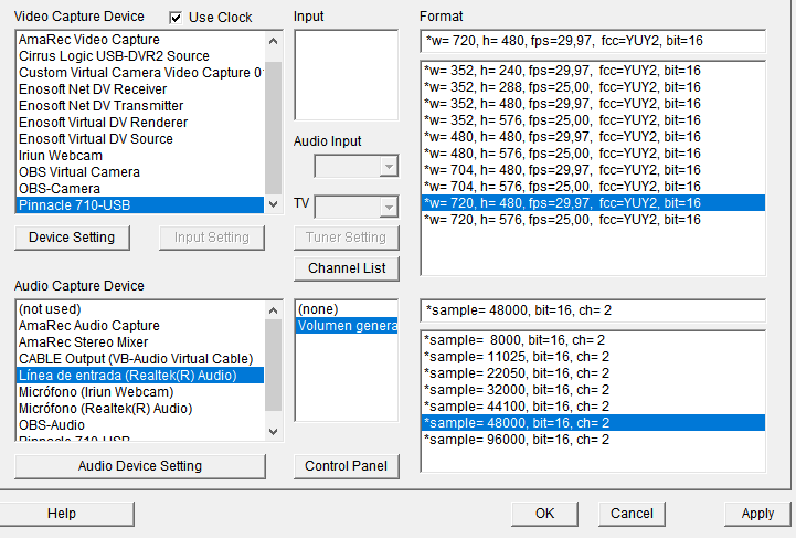

    Here are some screenshots.
    Here is the capture card selection/standard selection. I have it set to 720x480 at 29.97i. I also have the capture card set to NTSC-M.
    [Attachment 76950 - Click to enlarge]
    But as you can see in the "Video" section below the capture preview (which i assume is what the program is telling the card to output) it says 720x480 at 28.99p.
    [Attachment 76952 - Click to enlarge]
    And once you start recording, it makes a 29.97i AVI file, but there are frame drops/skips. You can notice it more on things like scrolling text or slow moving objects.
