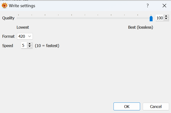

    Are all avif files YUV444? The second one I sent you has these settings.
    [Attachment 76881 - Click to enlarge]
    By the way, did the first one look better than both webp files?
  8. Originally Posted by Jay123210599 View Post
    No
    Maybe the program isn't sending the proper commands
    The 1st AVIF definitely looked "better" than the 1st webp in terms of "more similar" to 00214.png; and in many ways better than the 2nd webp . The main negative of the 1st AVIF is smoothing of textures. If you had an anime source style with fine textures, there would be a larger visible difference. It's still pretty good for the filesize. When using lower bitrate ranges smoothing is arguably less bad than edge artifacts - it's a good tradeoff for most people especially on this type of anime style

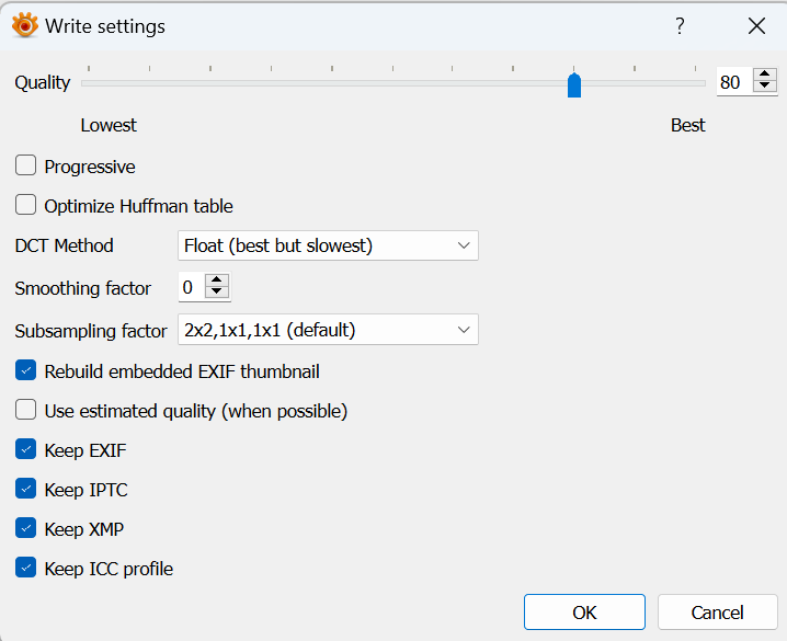

    How about this? I converted the png to jpg using these settings.
    [Attachment 76890 - Click to enlarge]
    [Attachment 76893 - Click to enlarge]

  14. The jpg is not good - typical jpeg artifacts .
    The jpegxl image looks very similar, just some very minor differences. It's the closest out of the bunch. The 2nd avif is next closest
