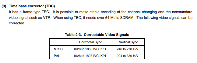

    Lordsmurf, I am interested to understand how the NEC AIO chip µPD61181 differs from the ICs in a TBC like the DataVision TBC-1000 (Phillips SAA7111/Conexant Bt864A). See attached NEC datasheet referencing the frame-type TBC on page 17.
    Image Attached Thumbnails NEC chip datasheet.pdf
    Originally Posted by AndyO6322 View Post
    Lordsmurf, I am interested to understand... TBC on page 17.
    Define TBC. Therein lies the problem. There is no industry standard definition. So what many of us understand as "TBC" may be entirely referenced differently by a manufacturer. This has caused confusion for decades now. Some considered mere frame syncs to be TBCs, and yet the "TBC" (frame sync TBC) did not re-time or mistimed the output. So TBCs are tested for common fail points, to define them within our context of what a TBC is and needs to be, for our goal of consumer format SD analog ingest (without frame drop/insert issues).
    Even so, let's assume that NEC chip really is a frame sync TBC to our definition. Now then, look closer at that Toshiba recorder, pull up the spec sheet. Does it contain 64mb+ RAM? Is that RAM shared with other processes (NR, etc)? Meaning the TBC is underbuffering. -- Now then, I'm not sure if this is the case here (specs not met), as I don't have XS35 specs nearby, nor do I have time to tear my own machine apart. But this is an example of what you do often find is the case.
    This is where details matter, when it relates to claims of "TBC" in items. Too many TBC newbies focus on chip spec sheet claims, and not enough to real-world performance, or even the implementation in the chips. Very often, the mere spec of the item (forget the chip) shows it to be impossible or nonsense. Marketing depts loved to claim BS that did not exist in the 00s, for digital video products, simply because it was on the spec sheet of a component.

    The way I look at it, Any chip that rewrites the timing signal is considered a full TBC, VCRs with LTBC chip are full line TBCs because they regenerate the HBI signal, Devices that regenerate the VBI signal are considered full frame TBCs such as the TBC-1000. Frame synchronizers are just frame buffers, they rely heavily on a good VBI signal to determine the start of the frame, they always follow a frame TBC, Alone can't work. I don't know how DVD recorders and video mixing consoles work so I cannot define what TBC functionality they have.
    From the info from elsewhere and from my own experience:
    • Digital TBC originated as a buffer of just one and a half lines, which grew to 8, 12, 16, 32 and more lines. These TBCs line up H-Sync pulses only, this is a "normal" TBC or "Line TBC" in the parlance of this forum users.
    • It is possible to have a TBC with a full frame buffer that does not line up V-Sync pulses, so this would still be a "Line TBC" but with an option of dropout compensation (DOC) for a whole frame. A full frame repeat does not look pretty on normal video.
    • Frame Synchronizer is a device that lines up V-Sync, it does not necessarily line up H-Sync, which this video clearly illustrates.
    • A so-called "Frame TBC" - the term that is often used on this forum - is a device that aligns both H-Sync and V-Sync pulses, so it combines functionality of a "normal" TBC with frame synchronizer. Unlike a "normal" frame synchronizer, which aligns V-Sync of one or more video signals to an external reference signal, possibly from another VTR or from a sync pulse generator, a "Frame TBC" aligns V-Sync to a built-in sync pulse generator.
    Because of the above, "Frame TBC" includes "Line TBC" functionality. Hence, one does not need both a "Frame TBC" and a "Line TBC", just a "Frame TBC" is enough.
    OTOH, frame synchronizer does not necessarily include "Line TBC" functionality, thus a "Line TBC" and a frame synchronizer complement each other.
    "Line TBC" and "Frame TBC"are not industry-standard terms. I suppose those who use these terms imply that "Line TBC" == "X-line TBC", and "Frame TBC" == "Full-frame TBC".
    Feel free to correct me if you have better info.
