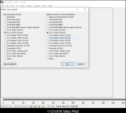

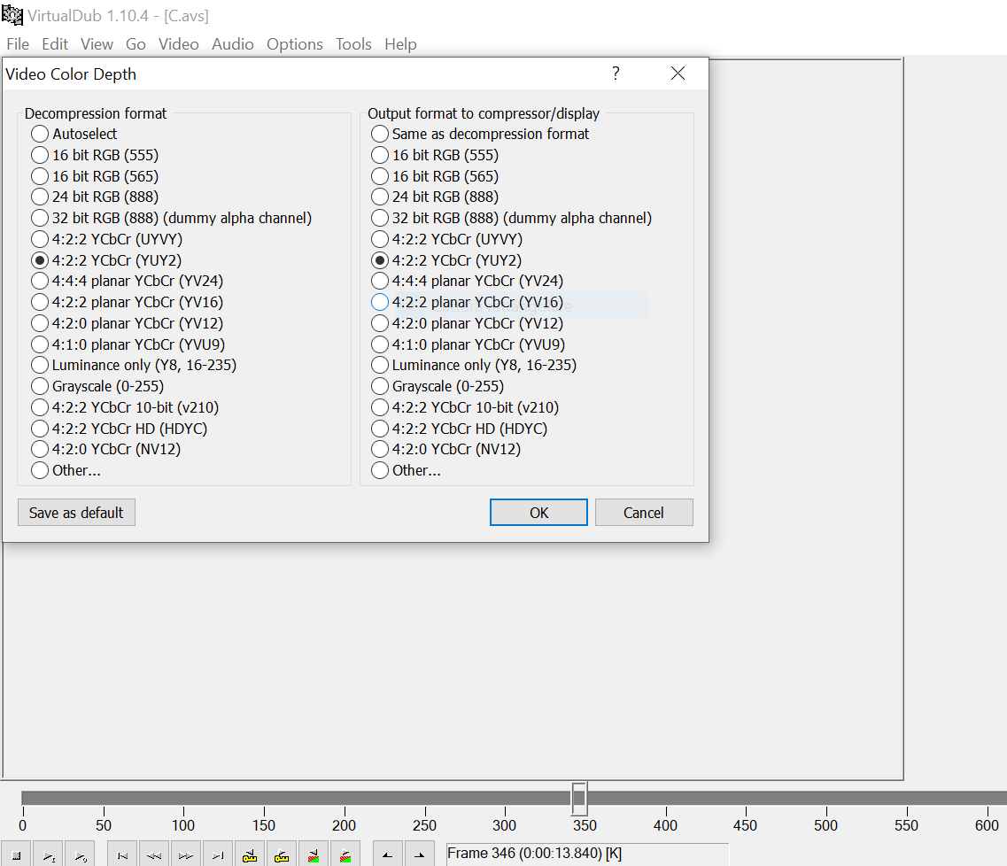

  9. Captures & Restoration lollo's Avatar
    Jul 2018
    Italy
    I meant the folowing for input processing, just in case:
