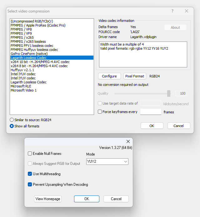

    I watched a tutorial on YouTube I'm thinking of using this codec (Lagarith Lossless Codec) with the settings from the tutorial. Is 720x576px and YUY2 correct?
    However, I want to ask if any of the other codecs are better and with what settings?

  9. VirtualDub 1.10.4
    Lagarith Lossless Codec with YUY2 mode
    Format 720x576px and YUY2
    Audio 44.10khz, 16bit

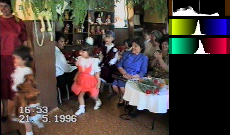

    Your capture suffers of "flagging(tearing)". You need a TBC correction, if you can't have a high-end S-VHS machine with T.B.C, add a DVD-Recorder in pass-through mode, such as Panasonic ES_10 or ES-15:
    [Attachment 76955 - Click to enlarge]

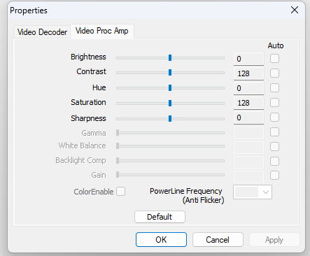

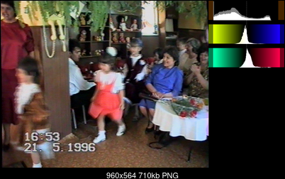

    it also suffers of "crushed" blacks, try to tune the procamp of your card:

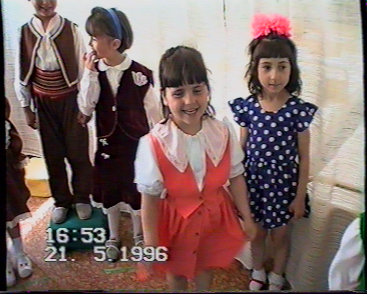

    Here a restoration attempt using classics approach
    AssumeTFF().QTGMC(preset="slow", matchpreset="slow", matchpreset2="slow", sourcematch=3, tr1=2, tr2=1, NoiseTR=2, sharpness=0.1)
    TemporalDegrain2(degrainTR=3)
    LSFmod(defaults="slow")
    and compressed to h264 for size reduction: rest.mp4
    Some of the frames with lines dropout (defect on tape) can be replaced with interpolated frames.
    In your original script AssumeBFF() is wrong, and BilinearResize(720,540) is useless and lossy

    How do I tune the procamp and how do I know it's good?

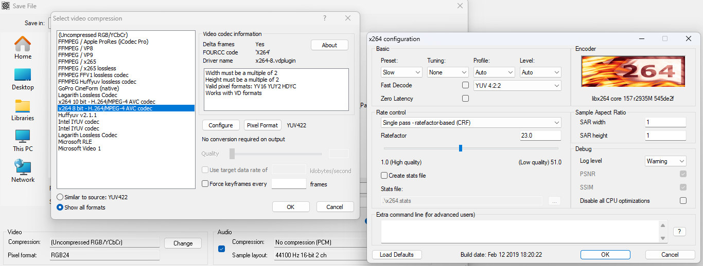

    And finally to ask what settings to use for encoding. Is it ok in .MKV?
