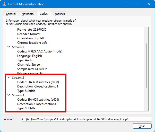

  29. Originally Posted by the_steve_randolph View Post
    Clearly I am having issues with finding the right file. But, coming at it from another angle, is there a player out there that does identify EIA 608 closed captioning AND can turn it on or off?
    VLC player, Tools, Media information, Codec.
    [Attachment 77121 - Click to enlarge]
    OK, I seem to be unable to find my original file that had the EIA 608 closed captioning. Seeing this post, I have a few questions:
    1. can you upload a clip of that file with the EIA 608 closed captioning so that I have something to work with?
    2. where in VLC can I turn on or off those EIA 608 closed captions?
    3. what switch in ffmpeg would show me that the file contains EAI 608 closed captions?
    4. what ffmpeg command can be used to extract the closed captioning into a text-based subtitles file?
    5. what ffmpeg command can be used to eliminate the EIA 608 closed captions?
