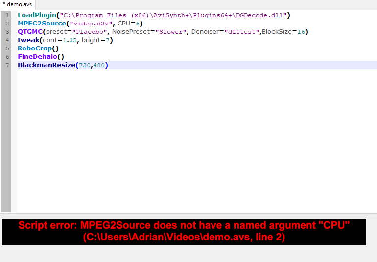

    None of the other parameters work on MPEG2Source, pls help ty
    [Attachment 76824 - Click to enlarge]

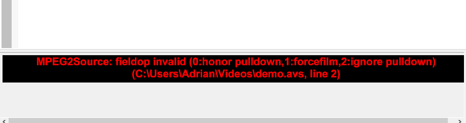

    edit: now I just wrote on the highlighted parameter (like not writing cpu= just the value)
    and this pops up:
    [Attachment 76825 - Click to enlarge]

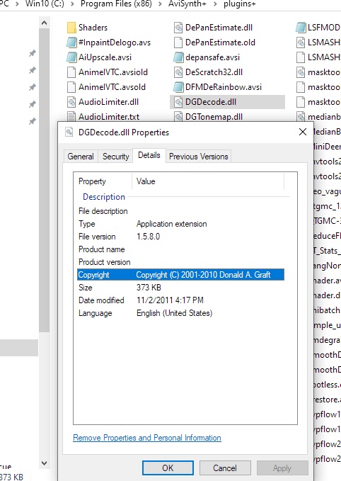

    The properties of dgdecode.dll should look like this for the 32 bit version.
    What does your say?

  5. Only the x86 version of dgdecode.dll has options like CPU=
    You can use most x86 plugins in x64 avs host with mp_pipeline

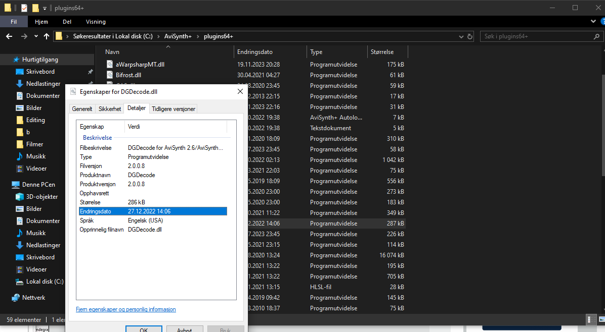

    Here a screenshot of my DGDecode.dll which is in plugins64+
    [Attachment 76837 - Click to enlarge]
    using d2v sources in mpeg2source works fine but not the other parameters of it

    As PDR mentions, those options are not available in the 64 bit version.
    If you want to try that option, switch to the 32 bit environment
