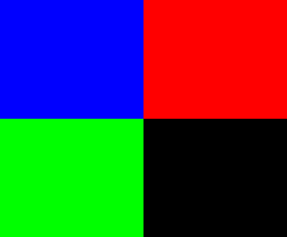

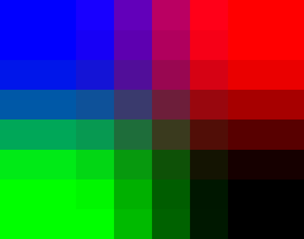

  4. Imagine image 2x2, your original,
    first you resize it using Bicubic resize to 8x8, new pixels are created with different colors, it is in no way same as original, but you might say it looks better. But same thing could actually do a web browser resizer or mediaplayer resizer. Why to make it bigger. Only you want to enhance something, maybe.
    than you resize to 8x8 but using Point (nearest) resize, You make image 16 times bigger but no new information is made, in theory, colors are the same but it makes no sense

  5. original 2x2

    @_AI_, the test for those things is fidelity to the ground truth source (or what the gts would be if if was that size originally), so no I don't think you could say that's better.
    Point resize works great for special cases of block graphics, but lots of other cases not so much.
