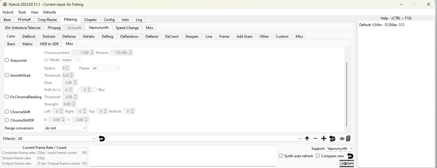

    How do I shift the chroma up for interlaced video such as the go fishing clip in this thread?
    [Attachment 76859 - Click to enlarge]

  8. In Hybrid you can insert custom filters, change the filter order etc.

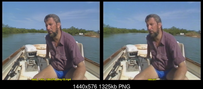

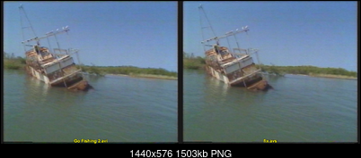

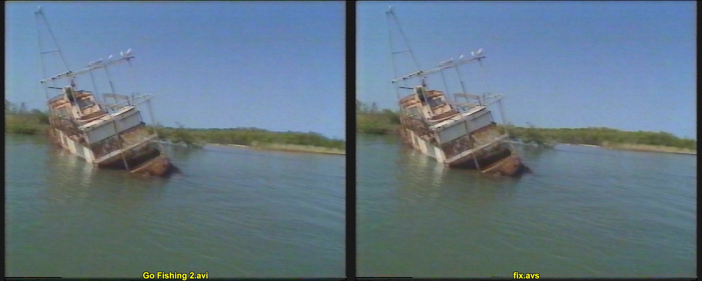

    A comparison between the original source and a version with chroma shifted 2 pixels up. You tell me who is good and who is not (I know the answer).
    with image slider: https://imgsli.com/MjM4Nzc0
    here the script I wrote to shift chroma for interlaced source (let me know if you see any error):
    video_org=FFmpegSource2("tmp\Go Fishing 2.avi")
    # separate fields tff
    video_org_sep_tff=video_org.AssumeTFF().separateFields()
    # parameters
    v_shift=2
    # shift chroma up
    video_org_sep_tff_chroma_shift=MergeChroma(video_org_sep_tff,crop(video_org_sep_tff,0,v_shift,0,0).addborders(0,0,0,v_shift))
    # shift chroma down
    #video_org_sep_tff_chroma_shift=MergeChroma(video_org_sep_tff,crop(video_org_sep_tff,0,0,0,-v_shift).addborders(0,v_shift,0,0))
    video_rep=video_org_sep_tff_chroma_shift.Weave()
    return(video_rep)

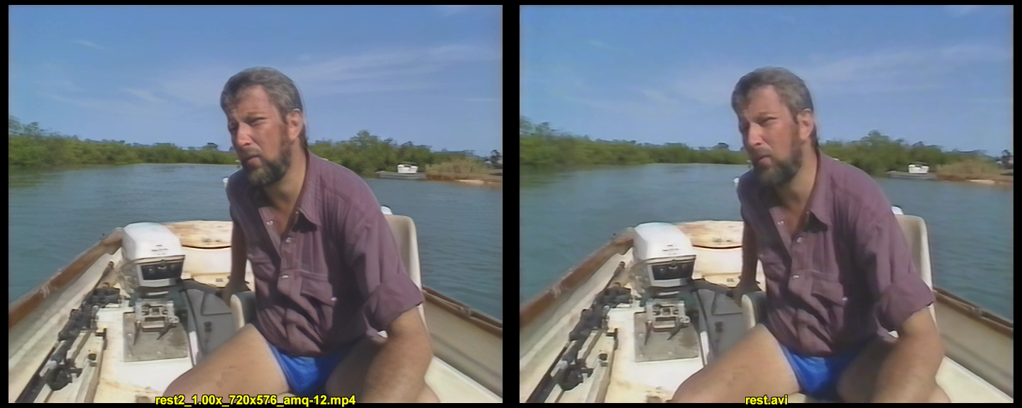

    Italy
    Off topic
    You all know that I think "There is nothing Topaz VEAI can do that cannot be matched/beaten by AviSynth/VapourSynth" as well as "A combination of AviSynth//VapourSynth and Topaz VEAI as upscaler or sharpener can produce sometimes excellent results", as we discussed in the famous thread https://forum.videohelp.com/threads/399360-so-where-s-all-the-Topaz-Video-Enhance-AI-discussion with @JoelHruska (if my friend lordsmurf says differently, just ignore him).
    This is one example, as shown by @rgr. Thanks to him for his contribution.
    I repeated the experiment, using the following AviSynth script:
    AssumeTFF()
    QTGMC(preset="slow", matchpreset="slow", matchpreset2="slow", sourcematch=3, tr1=2, tr2=1, NoiseTR=2, sharpness=0.1)
    TemporalDegrain2(degrainTR=3)
    # no sharpening
    and then a simple TOPAZ VEAI (amq model); the result is nice (some over-sharpening, maybe).
    On the left the result of the above script + Topaz VEAI, on the right the result of above script with the addition of LSFmod(defaults="slow"), so basically is a comparison between LSFmod and Topaz VEAI
    video comparison:
    comp_last.avi
    image comparison:
    image slider comparison https://imgsli.com/MjM4ODUw
    P.S. #1: this is not a comparison between AviSynth/VapourSynth and Topaz VEAI; to do that, the first workflow should use some of the available tecniques for image improvement (VSGAN and all the others). I used AviSynth just as preparatory step for Topaz VEAI.
    P.S. #2: it is clear that the final judgement depends on personal taste; some may prefere a blurred image rather than a "visually better" image where the additional details have been recreated, and could be false, or non existent, or existing in a different shape in the real world. But the pleasure of the "watching" is there.

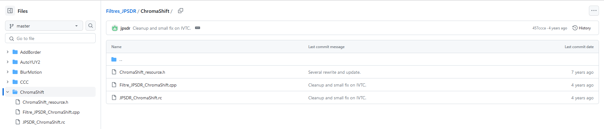

  21. Originally Posted by Bogilein View Post
    I usually correct the chroma shift when creating my working copy in one step at the same time as I cut out the unnecessary parts such as the beginning, end and commercials using the chroma shift filter from JPDSR in Virtual Dub which works in the YUV color space.
    https://github.com/jpsdr/Filtres_JPSDR
    Sorry if I'm being stupid here but I cant work out how to download the chromashift filter.
    [Attachment 76906 - Click to enlarge]

    @Leanoric, you're not the only one! QED though; go here:
    https://github.com/jpsdr/Filtres_JPSDR/releases/tag/20221120
    Download and unzip that 7z file. You'll see a set of folders for x86 and x64; in there is the VDF file with all the filters which will appear in the VDub filters list when you drop it into your plugins folder and start VDub.
    I'm using W11 64 so I chose the W7_AVX2 folder.
    Drop the resulting file into your Plugins folder.
    The single file contains all the individual plugins, which includes Chromashift. It's actually a very nice filter and works in a similar fashion to Flaxen.

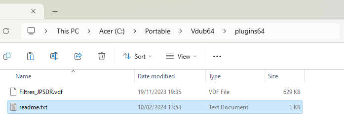

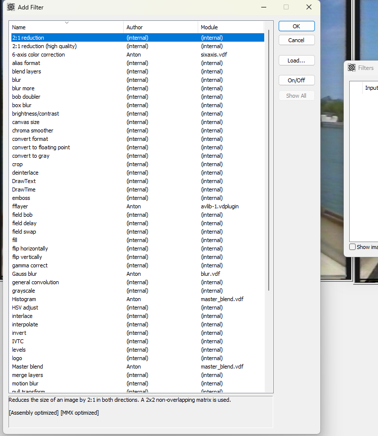

  25. I cant get the filters to show up in vdub.
    Like Alwyn Im using win11 64, so I chose the W7_AVX2 folder.
    Ive copied the vdf file into the plugin folder but it doesnt show up in filters. Ive tried it for both vdub and vdub2. Ive also tried a couple of the other ones but none of them show up in filters when I open vdub.
    Im not sure how you can tell what those different versions are, is there another one that I should try?

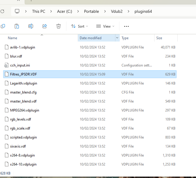

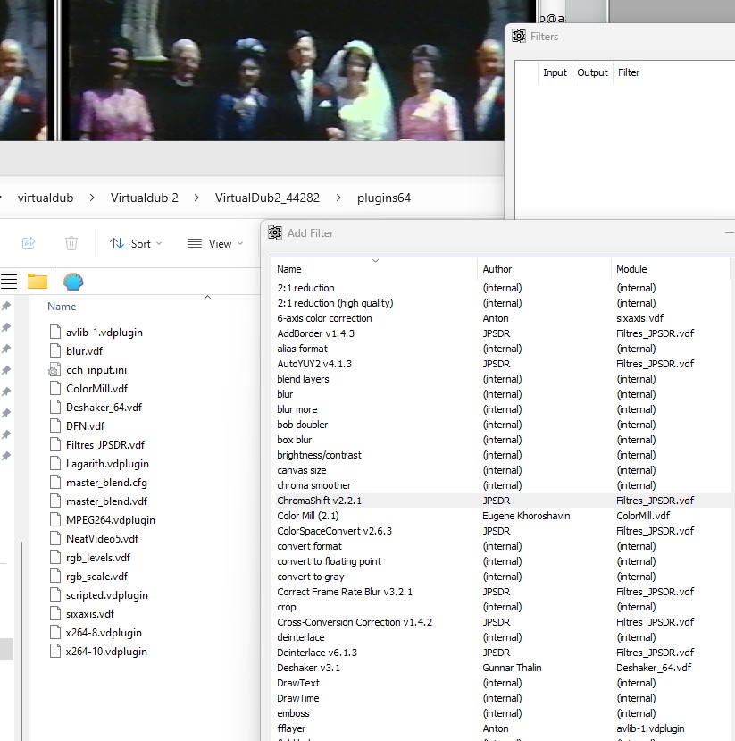

  26. Member
    May 2005
    Australia-PAL Land
    Attached is the "Filtres_JPSDR.vdf" I'm using (I had to rename it to ZIP because the forum doesn't accept VDFs as attachments...Baldrick?).
    I have put it into my VDub2 Plugins64 folder. Once you've downloaded it, just change the file extension to VDF.
    Here it is in my plugins64 folder, and you can see the various JPSDR filters scattered through the overall list.
    [Attachment 76915 - Click to enlarge]
    Added: looking at your plugins folder, you should have more VDFs in it. Compare it with mine; perhaps do a search for the MPEG264 (which was in the folder when I set up my copy of Vdub2) to find the correct plugins64 folder.
  27. That pic of the empty folder was vdub1, Ive just added your file to the plugins folder for vdub2 and still nothing

  30. Member
    May 2005
    Australia-PAL Land
    still nothing
    That's weird! You are running the 64bit EXE file? Check Help>About. The 64bit version is identified by "Compiled with MS Visual Studio 2008 for AMD64" in the blurb.
