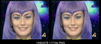

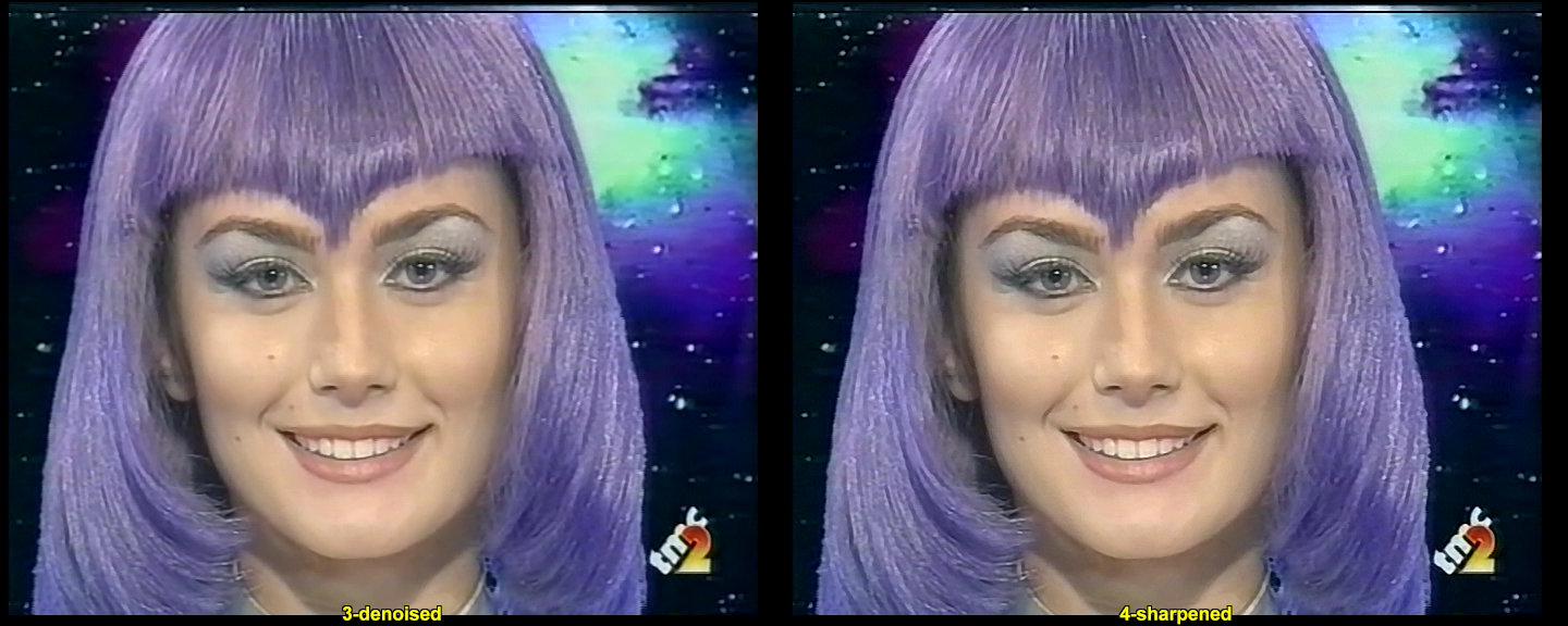

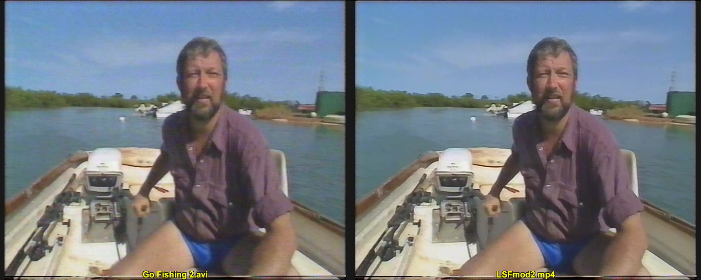

    Here a comparison using
    LSFmod(ss_x=1.5, ss_y=1.5, secure=false, Spwr=2, SdmpHi=0, soothe=false, keep=25, edgemaskHQ=true)
    on a denoised video; the effect is evident.
    LSFmod is designed to do not introduce excessive halos.
    For latest versions I use
    LSFmod(defaults="slow")

    I was probably expecting too much, especially as the video is bad quality to begin with, its from an LP recording.
    The first clip is what Im working with, The second has been denoised and sharpened with Lollo's settings. Im not sure if the video is benefiting from the sharpening or not?

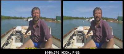

    Even if original is a bit washed-out, I do see a difference:
    video comparison
    comp.avi
    image comparison (interlaced versus progressive, but look the static portions)
    image slider
    https://imgsli.com/MjM4MjMx
    Processing:
    QTGMC(preset="slow", matchpreset="slow", matchpreset2="slow", sourcematch=3, tr1=2, tr2=1, NoiseTR=2, sharpness=0.1)
    TemporalDegrain2(degrainTR=3)
    LSFmod(defaults="slow") ### no chroma sharpening, injected back pre-sharpened chroma

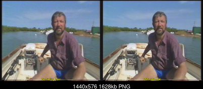

    edit: even looking to your attempt the difference is there:

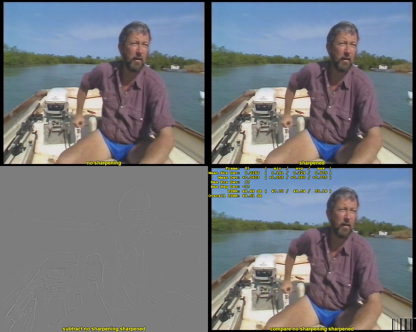

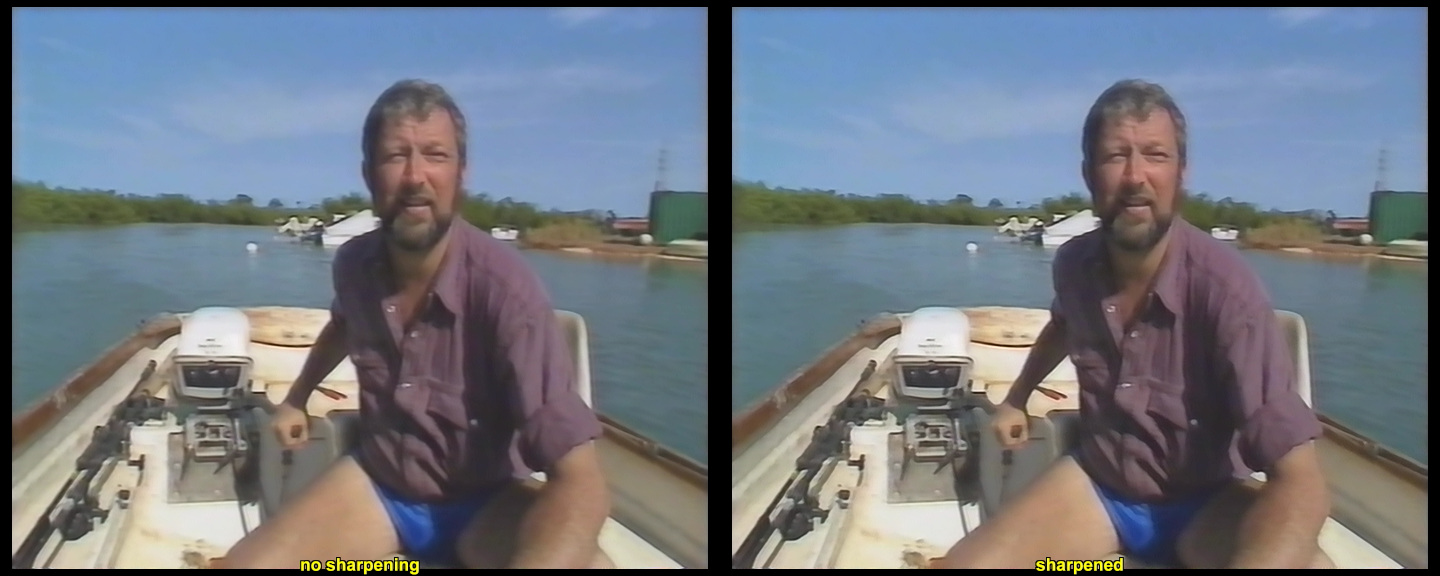

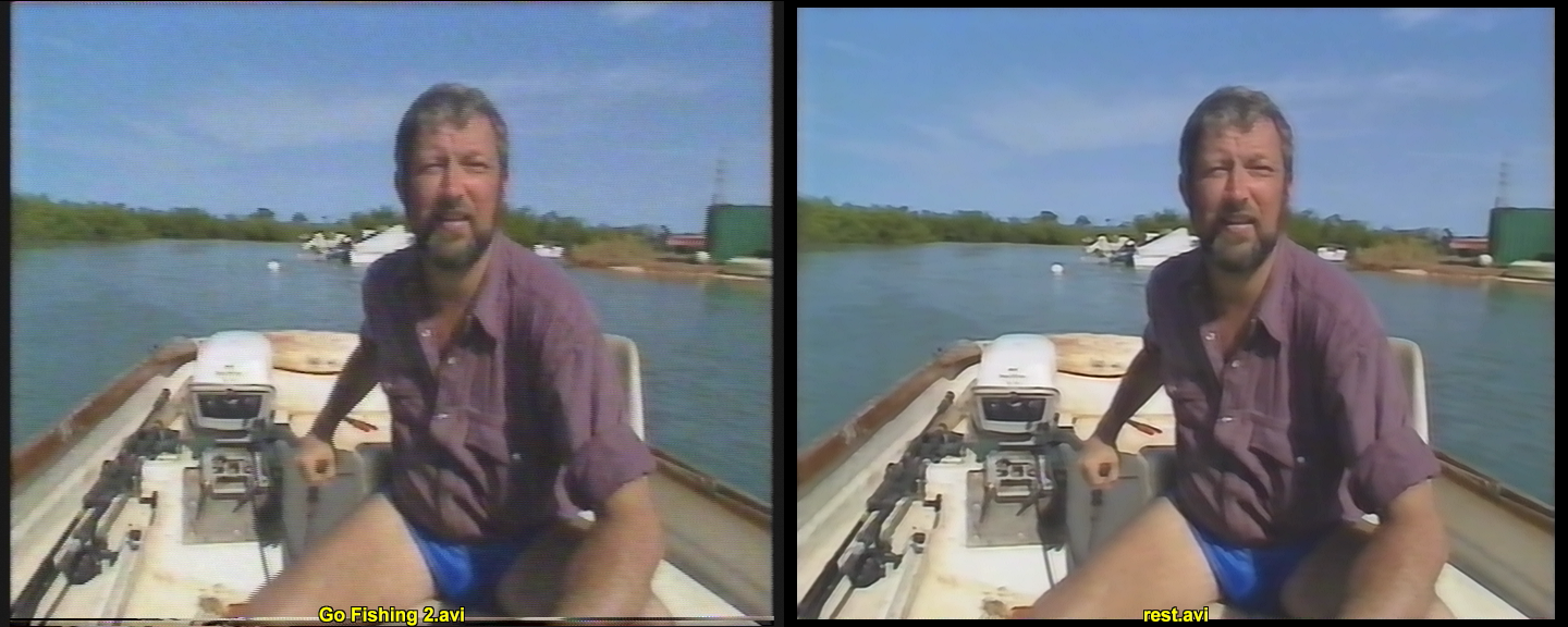

    As per Alwin request, which is appropriate, here a comparison with the above processing without and with sharpening (both deinterlaced and denoised):
    video comparison
    comp2.avi
    image comparison
    image slider
    https://imgsli.com/MjM4MjUw
  14. Are my eyes deceiving me or has the sharpening made the sky slightly lighter in colour?
    May 2005
    Australia-PAL Land
    The fisherman looks pretty similar but the images in post #4 definitely have different colours: the one on the right is more saturated. Is that LSFMod doing that?
    Still can't open your fisherman AVI. AVISynth says it can't find a decompressor. One of your earlier clips, Clip (1) opens OK.
  16. Captures & Restoration lollo's Avatar
    Jul 2018
    Italy
    I do not see nor measure any color deviation after LSFmod processing:
    https://imgsli.com/MjM4MjU4
