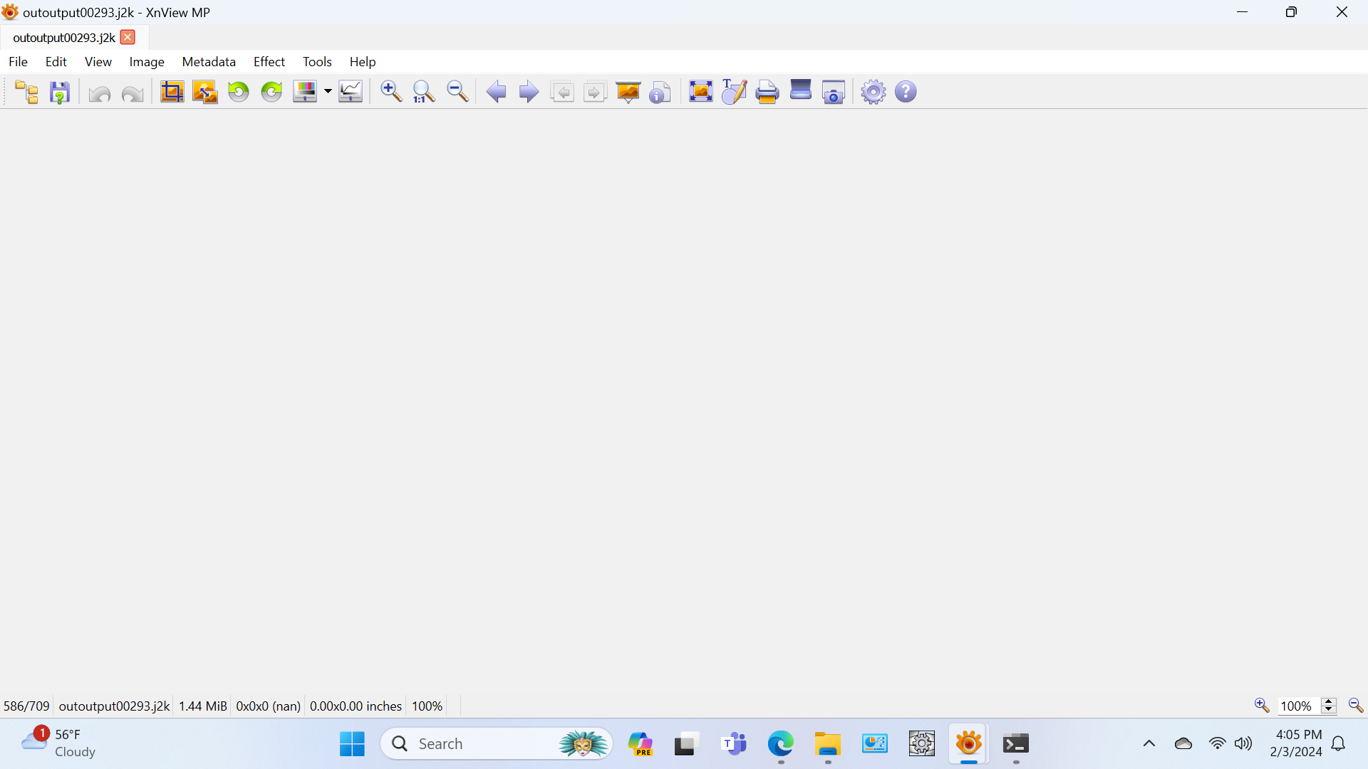

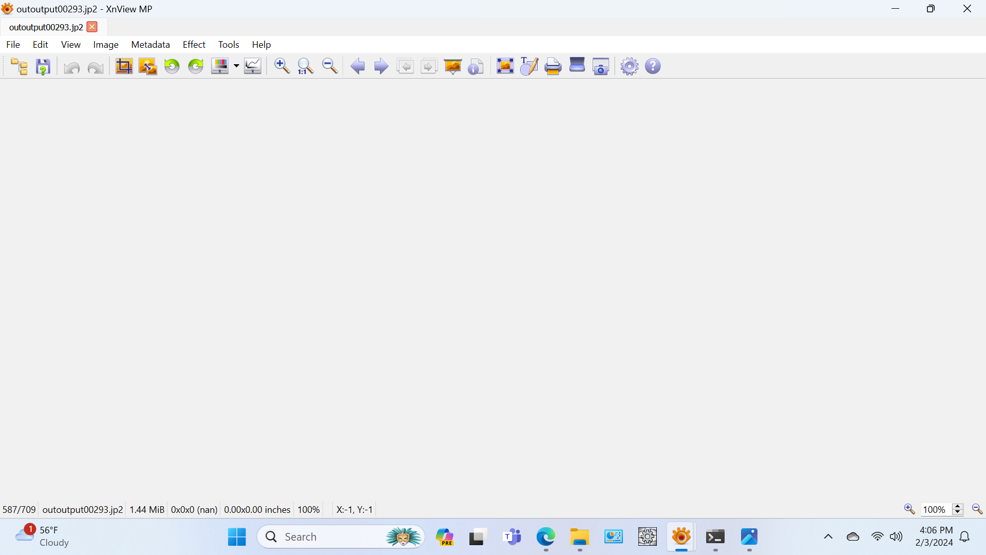

  1. I converted a video to image sequences of lossless jpeg2000 (both jp2 and j2k) files, but when I opened them in XnViewMP, I got this. Is there a way to fix this?
    [Attachment 76767 - Click to enlarge]
    [Attachment 76768 - Click to enlarge]
    Here's my command lines:
    ffmpeg -i input.mkv -pred 1 output%05d.j2k
    ffmpeg -i input.mkv -pred 1 output%05d.jp2
  2. Probably 16bitRGB jpeg2000 is not supported by XnViewMP . You can convert to 8bit RGB using -vf format=rgb24 . Or ask a XnViewMP developer to include support
