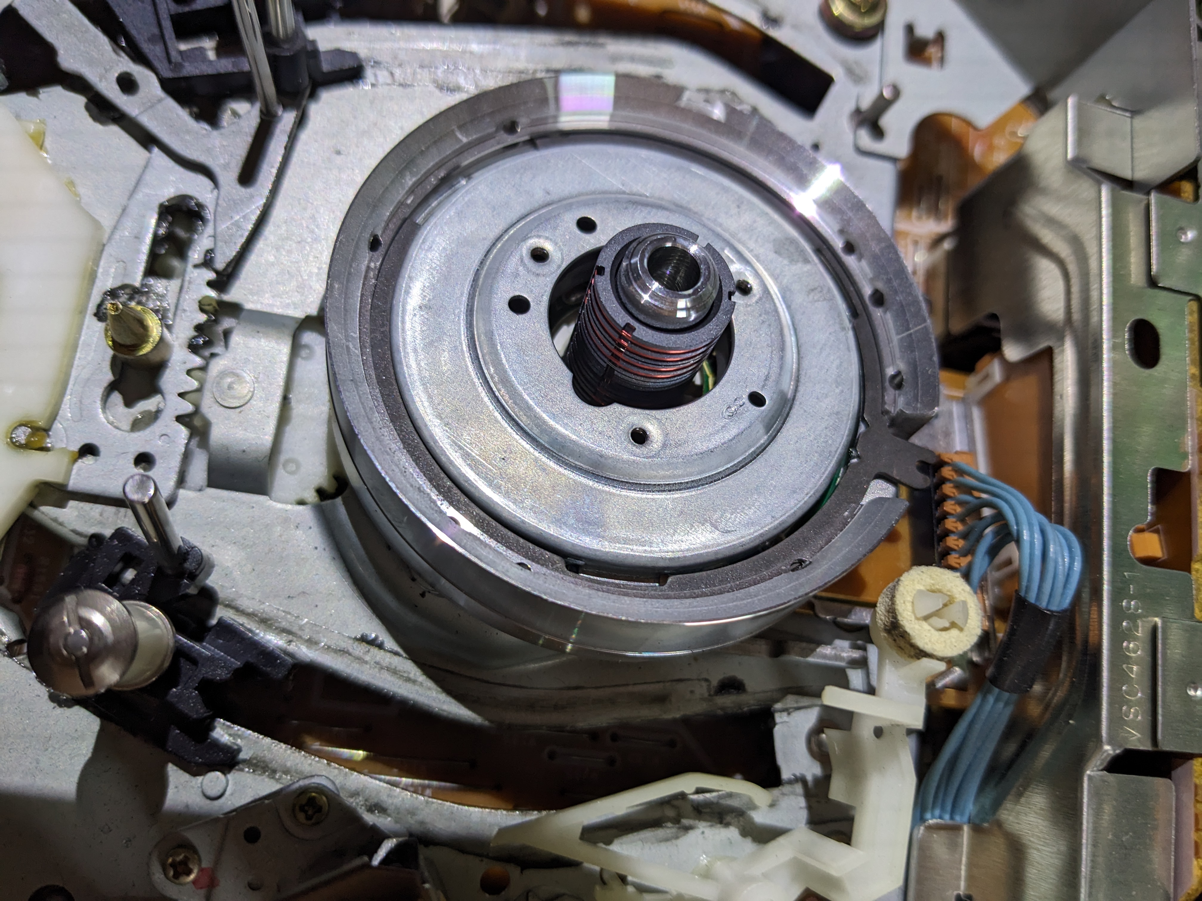

  1. Hi, I've an 860, panel lights up as normal when powering on, but nothing moves inside. Pushing in a tape doesn't seem to move any of the mechanism, but the motor does seem to be spinning. The drum doesn't spin at all so something is well broken on the loading side of things.
    Any suggested steps for a newbie to try to diagnose further?
    I took off the head (which doesn't look in great shape at all from a visual perspective) and it seems to be the rotary transformer that is stuck. It looks like the darker grey "pin" should allow this to be released but I cannot remove it. It seems to be sitting lower than the proper guardrails that it runs on.

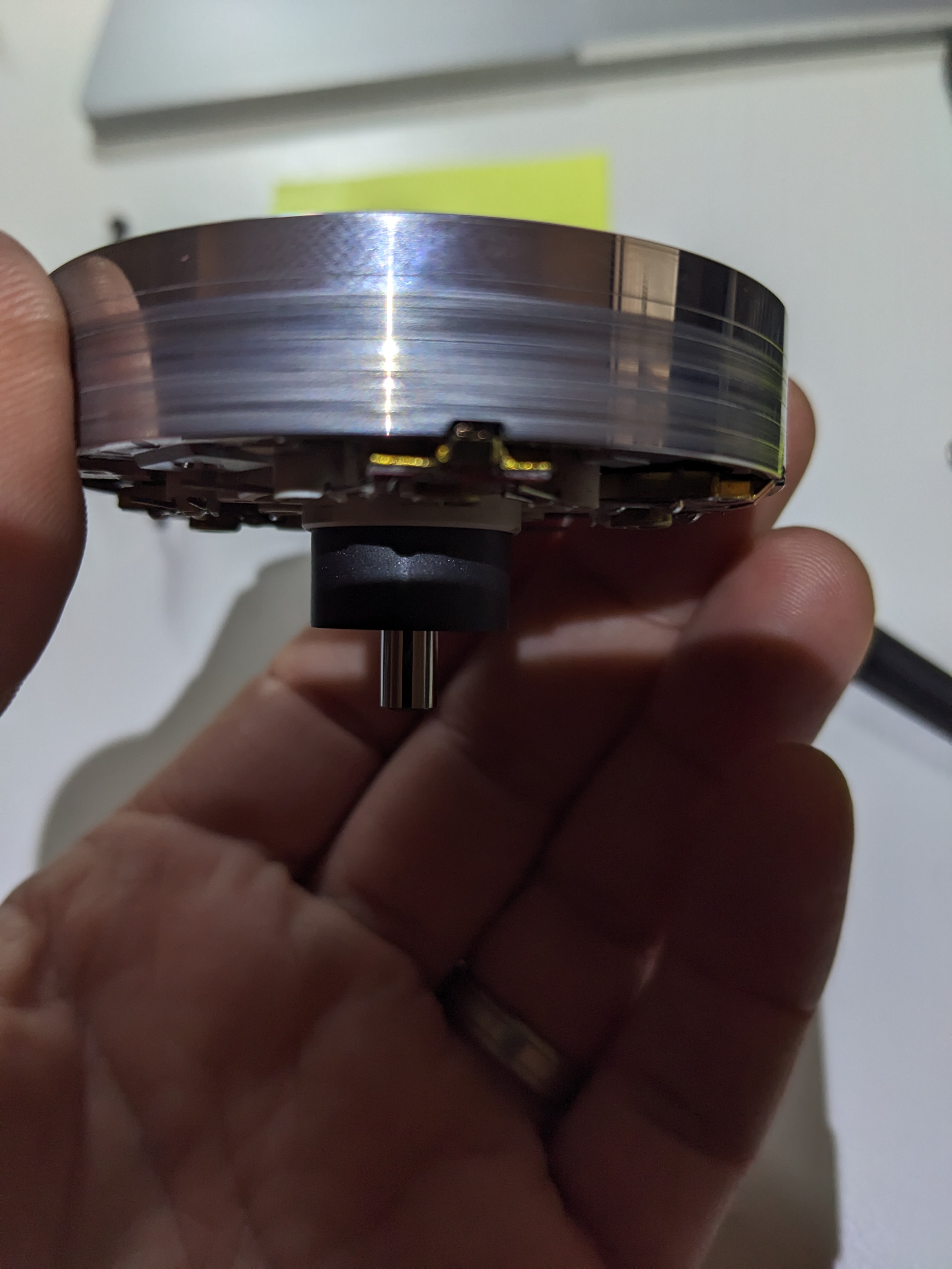

  2. Update, I did take off the head and managed to unlock the lower part of the drum. Just refitting this seemed to do the trick. Is the part in image 2 supposed to be lubricated where it spins?
    Tape loading is a big problem - I'm wondering if the machine is stuck in the wrong mode? The idler mechanism seems to be spinning before the tape is even fully inserted. Maybe a mode selector clean down may help (if I can find it).
    Is there a recommended way to remove the connectors to the circuit board? The connector with blue wires is really difficult to disconnect and want to make sure I am doing it right. Any clips to remove?

    Save your time and effort, that VCR is shot, the head is too far gone and cannot be repaired, The drum is severely scored, the heads are chipped, I guess someone was using it as a bench grinder, just find another VCR and move on.
