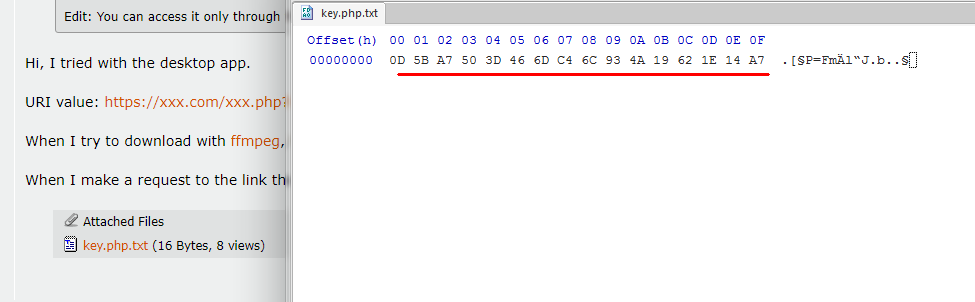

Hi, I tried with the desktop app.
URI value: https://xxx.com/xxx.php?c=xxxxxxxxxxxxxxxxxxxxxxxxxxxxxxxx
When I try to download with ffmpeg, hlsdl and yt-dlp it gives 403.
When I make a request to the link the php file is downloaded. -

Is there a command that works with the key.php file so I can use mp4decrypt or how can I get the hex value from the key.php file? -
this should be the key (the key file in hex)
Code:0d5ba7503d466dc46c934a19621e14a7
Code:mp4decrypt --key kid:0d5ba7503d466dc46c934a19621e14a7 encrypted_file.mp4 decrypted_file.mp4
Code:mp4decrypt --key 0:0d5ba7503d466dc46c934a19621e14a7 encrypted_file.mp4 decrypted_file.mp4 mp4decrypt --key 1:0d5ba7503d466dc46c934a19621e14a7 encrypted_file.mp4 decrypted_file.mp4
