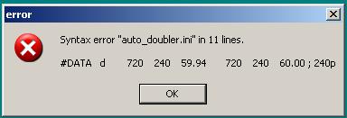

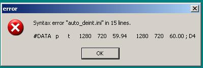

    When I open AmaRecTV for the first time on WinXP, I am greeted with the following two "error messages":
    [Attachment 76671 - Click to enlarge]
    [Attachment 76672 - Click to enlarge]
    After clicking them away, the program seems to open up, but not sure if I can just ignore these messages?
  2. Member DB83's Avatar
    Jul 2007
    I would say that you can ignore them.
    Taken on face value they refer to deinterlacing which you should not do at capture level and doubling frame rae which is also related to deinterlacing.
    But not seen these msgs when I installed/ran the program

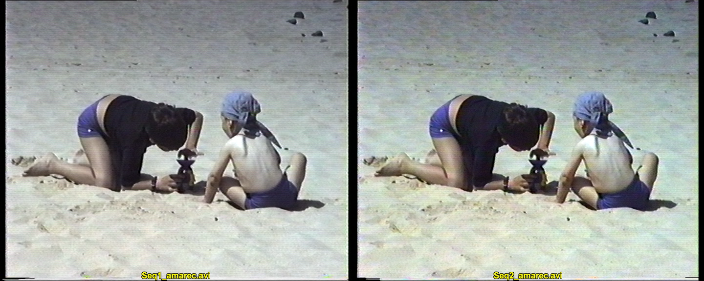

    one last attempt, this time using AmaRecTV. It mentioned 0 drops during capturing, also the text file mentioned 0 drops.
    Captured right into HuffYuf.
    As usual, please compare the two files with regard to picture (noise, artefacts, colours, details, brightness, sharpness etc).
    One is the 2008 DV capture, the other I just captured myself like I mentioned above. If there are drops / errors / faults again, then I really don't know what else to do.
  8. [tangent]
    Originally Posted by Marvolo View Post
    Something about the origin of these error messages is posted here, albeit I don't quite understand what to do. Apparently, it's got to do with geography / Europe's way of expressing decimals.
    https://forum.speeddemosarchive.com/post/amarectv_colour_problem.html
    Ah that explains why I also get these errors. Many European countries use "," as a decimal point instead of "." , and some text/number conversion functionality, like some functions in the C and C++ programming languages take the system locale settings into account which people often are not aware of so they end up being used in a way they shouldn't be.
    So e.g the program will correctly interpret e.g "2.2" from a text file on a English-language system but on say a system set to use Norwegian locale the it expects a decimal number to be formatted as "2,2" instead and the code to read the text file into numbers in the program fails in a way the developer would not have expected.
    Since the developer wasn't aware this behaviour it you end up with the program randomly failing on some people's systems. (I don't know if this specific failure was because of the C/C++ function as I think in that case it only happens on Linux and Macos and not on windows but not sure.)
    [/tangent]

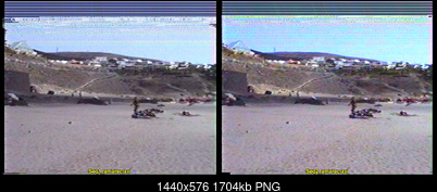

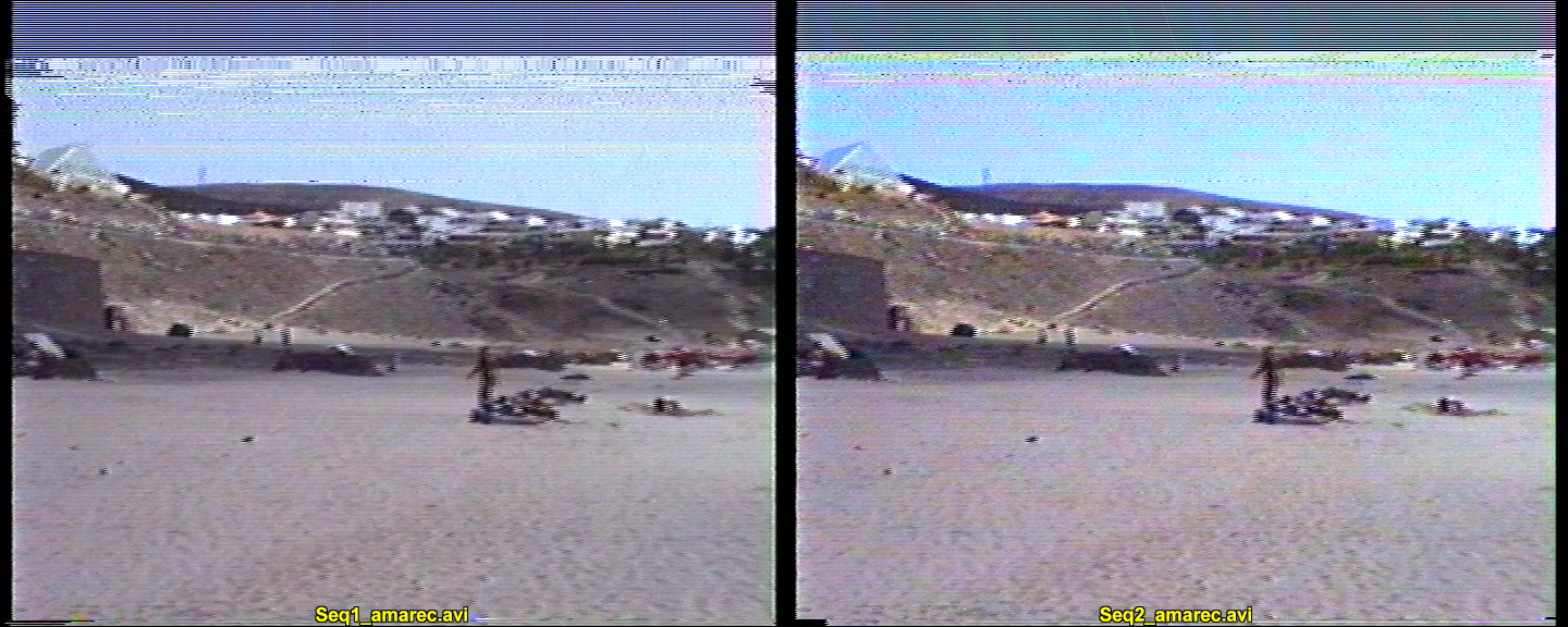

    Frame number 74 is corrupted, and many present the "noisy white lines" pattern:
    Looking the fine details the lossless (HuffYUV) this time is slightly slightly more defined (objects in the sand) but they are quite close:
    with image slider: https://imgsli.com/MjM3MDg1

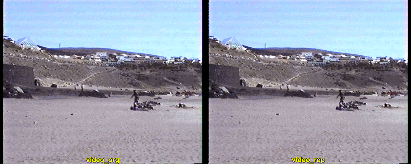

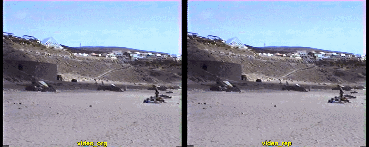

    Do not know what to say. Eventually you can use an AviSynth script to detect the bad frames and replace it with an interpolated one. An example here:

    Well, AviSynth is not doing magic, just creating a non-existing frame by interpolation of previous and next and replacing it to the faulty one.
    The failure is on the DV capture also (a gltch in the tape) and you can't use it as replacement.
    Photoshop is a good complement to AviSynth for defects not easily fixable

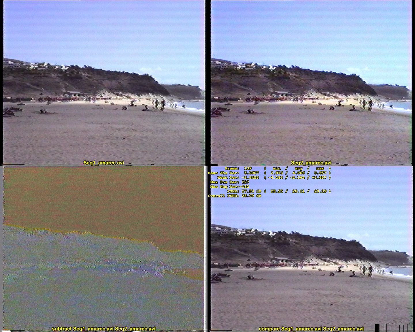

    I did the same as Lollo, aligned the two files and then compared the two files using the difference filter.
    Do you see a difference between the two files yourself?
    (Frame50,74..........)
    or are you relying on the experts? I don't see any magic in Amarec TV capture compared to Virtual Dub Capture.
    Perhaps use a different player, external "TBC" or capture card.

    The difference I see is that the colours are a bit more stronger in my capture compared to the 2008 DV capture.
  17. Originally Posted by Marvolo View Post
    The color difference means nothing: it can easily be corrected in post. There is, however, a significant differences in midtone levels which you will see if you zoom in and then move the slider between the elbow and the kid's face. I am not sure which is correct or which is "better," but they most definitely are different. It is the only difference in that one sample that is worth talking about.
    Again, you are not getting any big "Wow!" factor with your more complicated captures. If you could show any sort of detail that wasn't there before, or a major reduction in artifacts, or something similar, I would be jumping up and down encouraging you to go through the agony and effort of recapturing all your tapes.

    Bogilein,
    Marvolo called Seq1_amarec what in fact is the DV capture not the Vdub2 capture. Seq1_amarec (DV) and Seq2_amarec (HuffYUV), differ but really on a fixed frame analysis or on a metric measument:
    In term of "quality" of the capture, there is no difference if you use AmarecTV or VDub2 or VirtualVCR or a customized Graph, all rest being equal. But, apparently, Marvolo had dropped frames with the second and not the first, which is something else. HOwever is difficult to generalize judging oly two short sequences.
    Overall, as johnmeyer properly said, only a real quality-obsessed user would recapture the tapes (I am one of them, especially if a post-processing is planned, but that does not matter)
    edit: the difference at frames 50, 84, 184 between DV and lossless is because the lossless capture has a shift of the even and the odd fields, not present in DV capture. Even this defect can be fixed with a simple AviSynth script:
