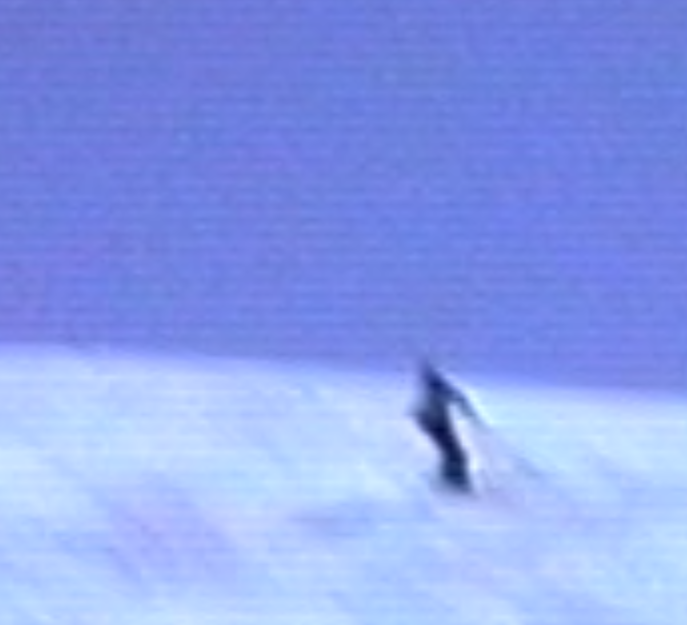

    What's with those horizontal alternating bright lines? Are they in the viewfinder?
Name:	Screenshot 2024-01-31 103348.png
    Those horizontal lines must have been recorded by the camera. I can't explain what they are, how they came about and why they're there. Nearly all of my Video8 tapes have them.

  23. Originally Posted by dellsam34 View Post
    I have often seen these lines for SONY analog PAL video. Usually fixable in Avisynth with
    separatefields()
    vinverse()
    weave()
    No idea what's causing these stripes. Something like Hanover bars?
    separatefields()
    vinverse()
    weave()
    The original camcorder which recorded those tapes was a Blaupunkt CR-8000. I always assumed that the cam was faulty.

  29. Originally Posted by dellsam34 View Post
    You have to use the Destripe filter in avisynth:
    Before/after:
    https://imgsli.com/MjM3MDE2
