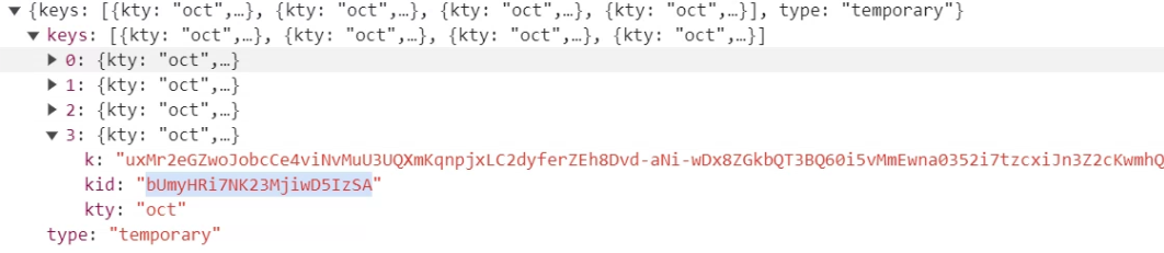

  11. The 'k' value changes regularly for each KID
    This is also in the payload as Javguy noted before. The spki appears to be the same throughout.
    {kids: ["bUmyHRi7NK23MjiwD5IzRQ", "bUmyHRi7NK23MjiwD5IzRg", "bUmyHRi7NK23MjiwD5IzRw",…],…}
    kids

    spki
    "MIIBIjANBgkqhkiG9w0BAQEFAAOCAQ8AMIIBCgKCAQEAr9K1i5hBJSGi_m-wtfOKNZ4OY8BEzFYr16UA5VHAXpIHV_NB_n-UutvooNLsZOjKHMoJHvfnFYWDA5SZDxUHma9MUpR6ZSwsQg4h8reaHVTVWQXMynYFv6wW0LbHSVIvfH_r8BNCFlozX_sk9fN-YjPxLJ6Eb-bAX65n75tCkbEWCT9L0_k3ULZpzFvUSeXZyxAOEJQiaoAvEnCI9nKZp1ZlKt9G_AC7hIBXY6qAx_1SW5waGUbrNWNlRj2-xKZGqWmAZX9Em4AbwDtUouByUvG5SUc_QmEP1RVXaRrugEvzonW_7SkcqTsK5tiCcqbxOA3iSo9fEMjKbjUknsvk3wIDAQAB"
    type
    "temporary"
  12. carrion is correct in that shaka seems to at least tell you the correct KID because when I tried to use the first three keys it gave me the error
    [0130/044509:ERROR:decryptor_source.cc(55)] Error retrieving decryption key: 14 (INTERNAL_ERROR): Key for key_id=05A3A0A978BC3CF182C211CD7CCCEEF7 was not found.
    it wasn't until I did the last key that it at least attempted to decrypt the video but alas, the final product was still garbage.
  13. It seems like the long k values have to be decrypted in order to get the correct one to convert from base64 to hex - which would yield the correct key
