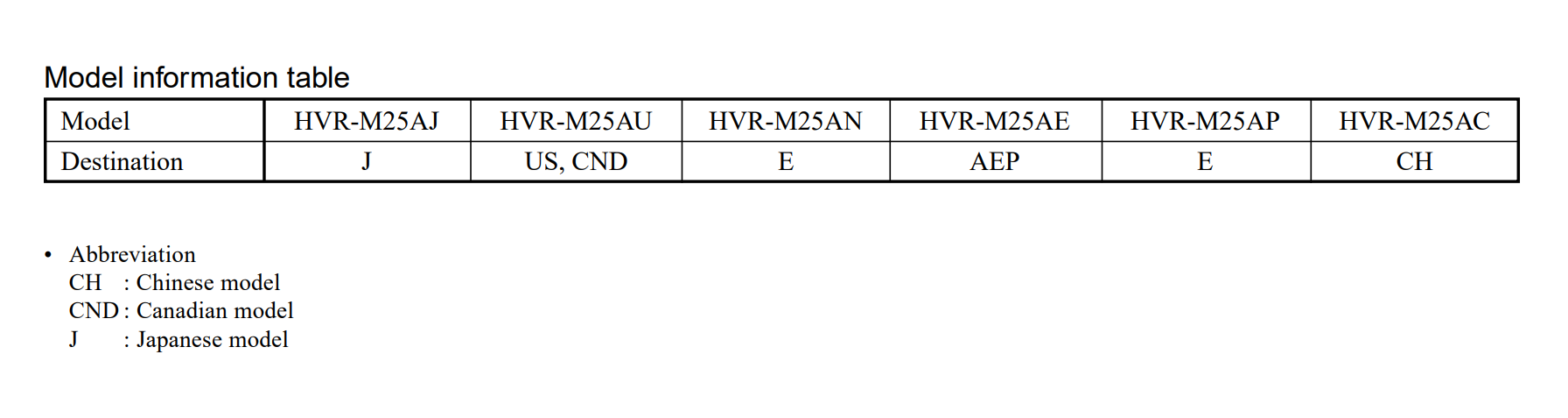

  6. Capturing Memories dellsam34's Avatar
    Jan 2016
    Pray tell what a HVR-25AJ is.
    But you sure hardly have DV video now. Maybe HDV ?
    I think he has a Japanese version, But all versions playback and record DV/DVCAM/HDV in mini and full size cassettes:
    [Attachment 76502 - Click to enlarge]
