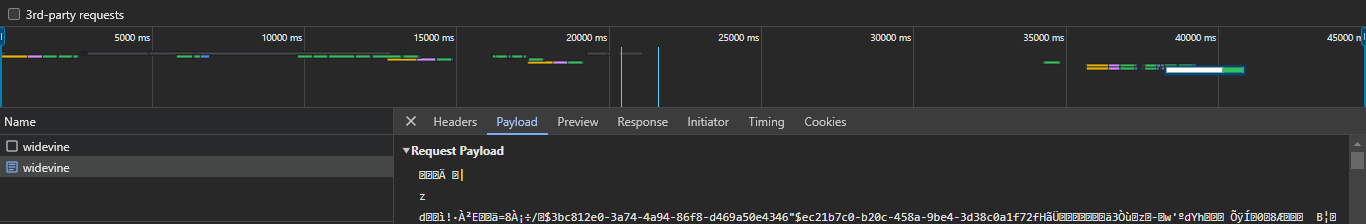

    [Attachment 76474 - Click to enlarge]
    License url,
    There is only 2 license requests (Method: OPTIONS and Method: POST).
    Only browser cdm data in the payload ( no widevineChallenge or any other data in the payload).

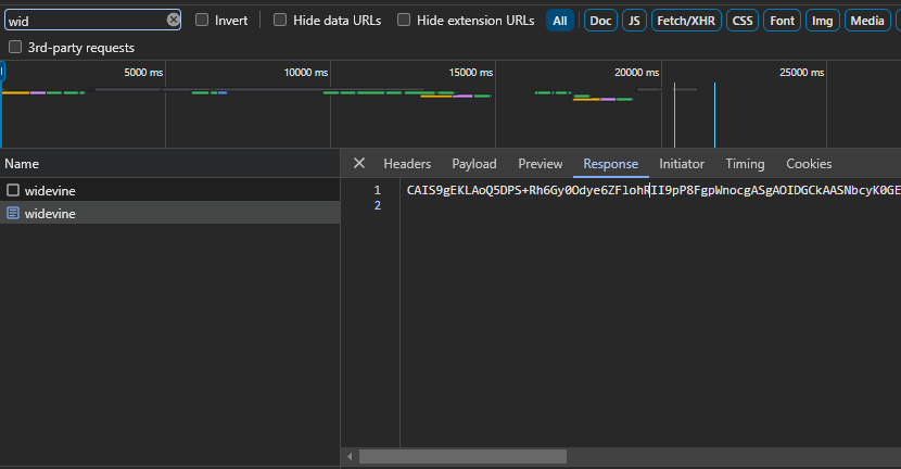

    [Attachment 76473 - Click to enlarge]
    with pywidevine
    Error:
    500 internal server error
    I'm able to get the license response with WKS-KEYS
     widevine_license = requests.post(url=lic_url, data=wvdecrypt.get_challenge(), headers=headers, proxies=proxies, auth=proxy_auth)
    License Response:
    CAIS.................................
    but I can't extract the decryption keys from license response received from the License Server.
    I need help with this process.

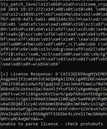

    [Attachment 76484 - Click to enlarge]
    def WV_Function(pssh, lic_url, cert_b64=None):
        wvdecrypt = WvDecrypt(init_data_b64=pssh, cert_data_b64=cert_b64, device=deviceconfig.device_android_generic)
        print(f"\n[+] License Request: {widevine_license.request.body}")
        print(f"\n[+] License Response: {widevine_license.content}")
        license_b64 = b64encode(widevine_license.content)
        wvdecrypt.update_license(license_b64)
        Correct, keyswvdecrypt = wvdecrypt.start_process()
        if Correct:
            return Correct, keyswvdecrypt
    correct, keys = WV_Function(pssh, lic_url)
    print()
    for key in keys:
        print('--key ' + key)

  7. Originally Posted by PETA View Post
    didnt work. still unable to phrase
        if Correct:
    print()
    for key in keys:
    Your response is already in base64 so you just need a slight modification to your code
    replace this:
    with this:
    license_b64 = widevine_license.content
    (or if that doesnt work, try this)
    license_b64 = widevine_license.text
