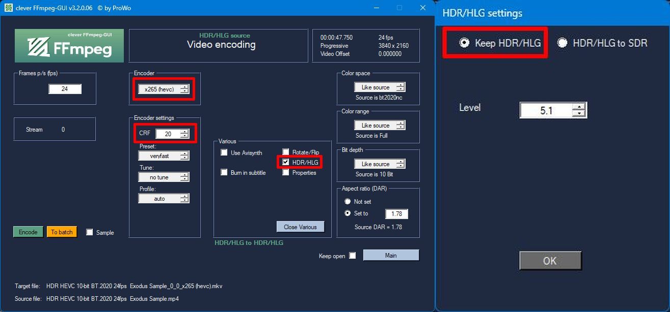

You can try clever FFmpeg-GUI.
Load your 4k HDR video, click main, click encode video stream, click keep size, set x265 as encoder, set crf 20, click various, check HDR/HLG, in the next screen check Keep HDR/HLG, click ok, click to batch.
[Attachment 76369 - Click to enlarge]
Click Batch tasks and click execute.
Since 4k HDR 10bit encoding is slow, the batch way is better because the computer does not switch to standby mode until the end of processing, so complete processing is guaranteed.

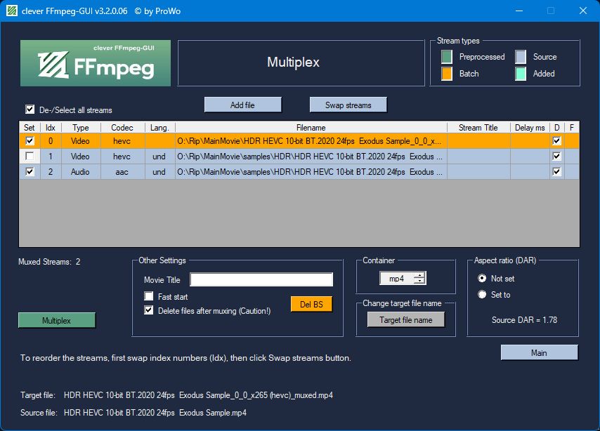

After the batch task is finished, click multiplex, the newly generated HDR video stream is displayed in orange.
Check all streams on the left except the original video stream (the blue one) and click multiplex.
[Attachment 76370 - Click to enlarge]
Done. -
