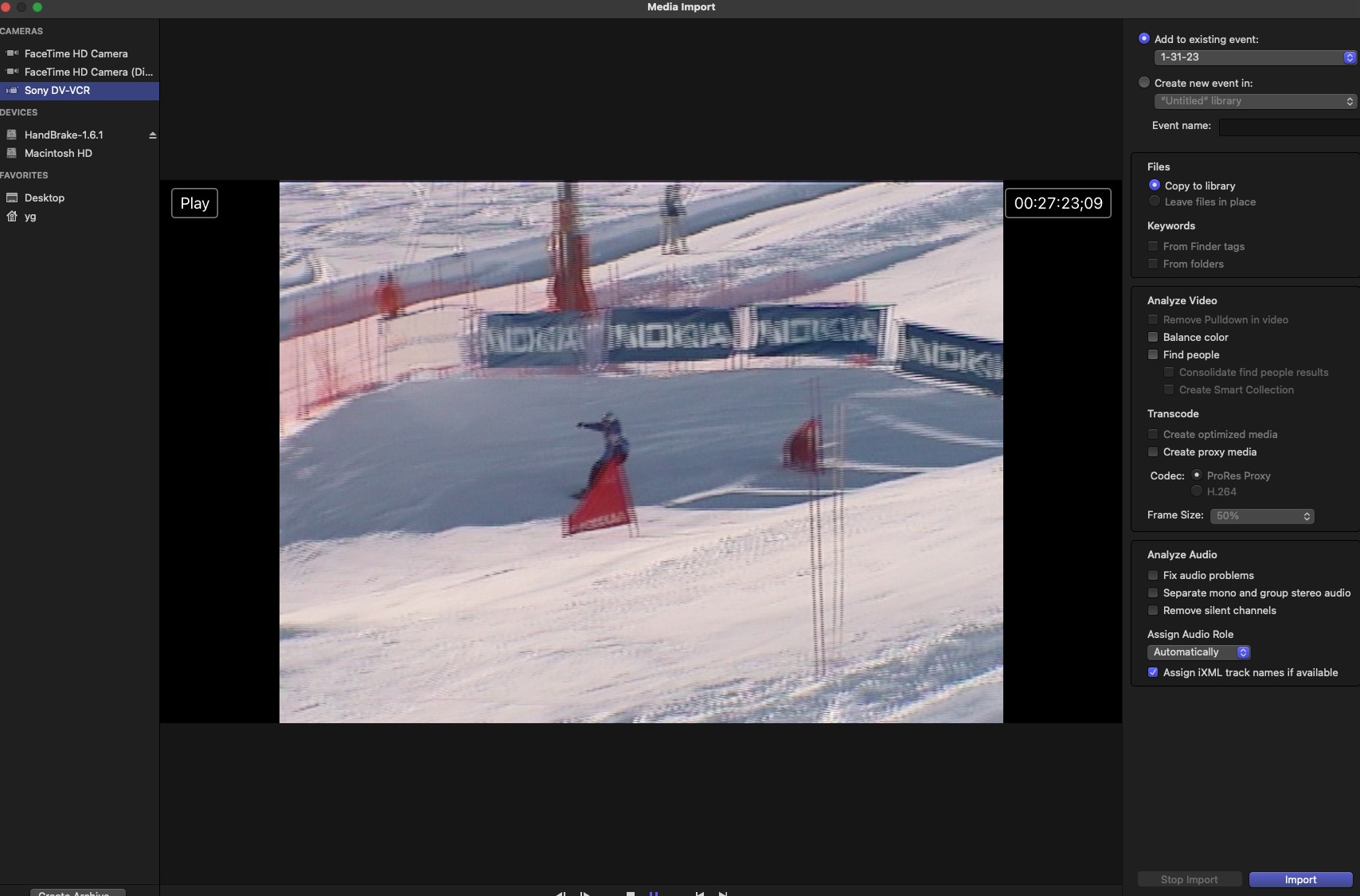

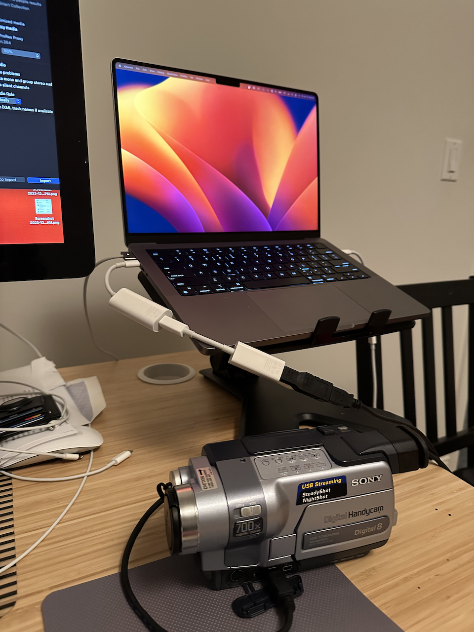

    Finally, after chasing a used camera (mine broke), finding my dv cable and connecting 3 adapters, I can finally capture to my MacBook Pro.
    I was very happy to see Super Cut immediately recognizing the camera with both video and audio.
    • Is there anything I need to do to get the best import quality?
    • Should I be using a different software?
    • Are there easy solutions for upscaling the video and/or improving quality?
    I appreciate your help.

  7. Member DB83's Avatar
    Jul 2007
    Well video is standard DV - that screenshot of the software I assumed you were using sure threw me.
    Audio is somewhat over the top since you only need 2 channel @1536 kbps and not 4
    Oh. And I assume you are in NTSC land (French commentary ?) since you have not stated your location etc.

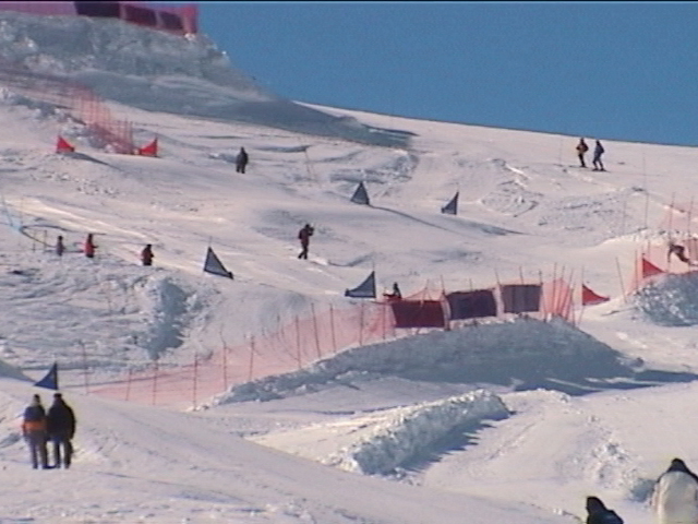

  8. Yes, it's standard DV - I am capturing with FCPX. Since the quality from DV is so low compared to current, I am wondering what's the best way to capture to minimize any more loss. If the default setting will do it?
    There was multi-language commentary since was an international competition, but that was in South America. It's NTSC.
    One problem I am having is that it's often making a bunch of very short capture clips (2 or 3 seconds), even if I leave the import turned on. What could be causing this?
    And is there any software for upscaling?
  9. Banned
    Nov 2022
    Is this a true DV recording? I wonder does it show "D" icon or maybe "Hi8 -> D"?
    If this is a Hi8 tape, there are no four audio channels there, at best there are just two. Some will suggest capturing analog recording from SVideo instead of Firewire, but I think this looks pretty good, I would keep your setup and capture as DV-MOV as you did. I would shift chroma one pixel up and one pixel left.
    I am sure FCPX has an option to split scenes/takes into separate files, or to capture continuously into one file.
    Vegas was able to load four audio tracks, the first two are slightly different, the other two have no audio.
    You were advised above to use an Avisynth/Vapoursynth script:
    de-interlace with QTGMC, resize to 1440x1080 while setting rec.709, You can do optional color correction or restoration. From here you can upload directly to a video sharing platform or encode to h.264 for manageable HD files for direct file playback.
    Deinterlace into 60p and upscale to at least 720p to force YouTube to enable 60p.
