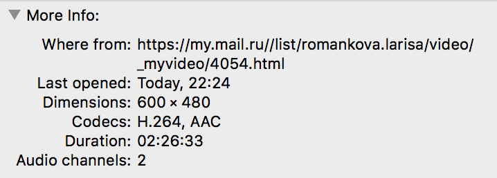

[Attachment 76761 - Click to enlarge]I downloaded this one,(using Uniconverter) and the end credits show that it is a (tv) ZDF/ORF production, so that could also be a source.
[Attachment 76762 - Click to enlarge]
Looks like that upload is a NTSC capture…. not PAL…
also it looks like it comes from a German webstream LB BW is a commercial for a German bank company. (why it's in NTSC i don't understand…)Last edited by Eric-jan; 3rd Feb 2024 at 17:04.
