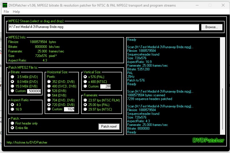

    If your files are MPEG 2, DVDPatcher will rewrite the file header data to change from 16:9 to 4:3.
    Beware: it overwrites the original file, so until you get the process sorted out, I suggest you work on copies.
    It wouldn't work on some of my "home made" MPEGs , probably because they were dodgy (written years ago) but it worked nicely on a VideoRedo MPEG 2.
    Here's how I set it up (the movie was originally 16:9; here I'm changing it to 4:3).
    [Attachment 76306 - Click to enlarge]

  30. Member
    Jun 2022
    Dublin
    Am I missing it or has the OP supplied a sample vid clip ? If so it would take a lot of the guesswork out of all of this.
    I'm also struggling with a black bars on all 4 sides of lots of pre recorded movies issue and so my interest in all of this.
    Thanks Sharc for very useful #9 post. I have already done (prepared but waiting for inspiration) most of #12. From a previous post, another thread ? I got tip of simply dragging in sides/top/bottom to establish if the black bars are really part of video or not, not if the image doesn’t change/squeeze. Important to make sure that MPC or VLC have already got Aspect ratio set to default / DAR.
    Both players have an option for displaying full screen, but this doesn’t fix small vid display on TV, has no zoom. I'm pretty sure that I encoded these incorrectly. Don’t mean to derail this threads topic, carry on.
