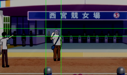

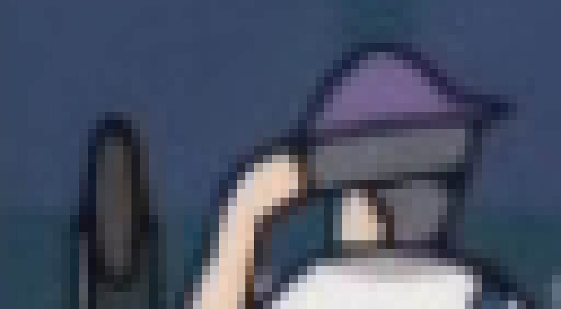

    Comparison of details between those two images,
    click on each image about three time to get full size into a browser tab, then clicking those tabs you see differences. Each little square represents actual pixel.
