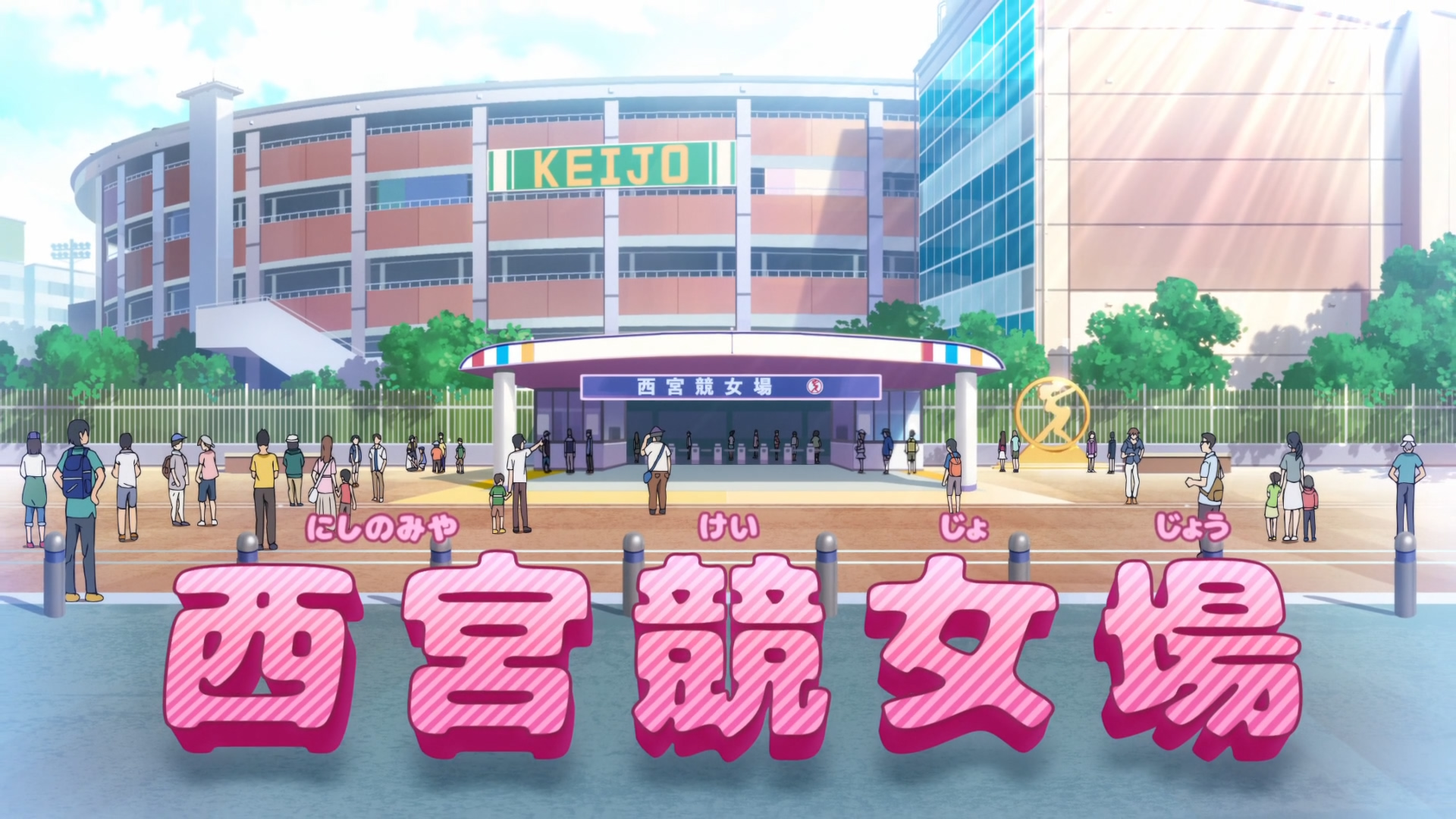

    Believe it or not, VirtualDub2 can make lossless jpeg files. If you don't believe me, check this out.
    [Attachment 76229 - Click to enlarge]
    [Attachment 76230 - Click to enlarge]
    But there's one problem. As I mentioned before, it is VERY slow when making image sequences. If there a faster way to do this (with smaller file sizes, if possible)?
  2. visually they are close, but it's not lossless . You can zoom in and see differences
    You can do a difference or test PSNR to confirm - the jpeg is lossy
    For vdub2 , if you have idle/slack resources such as CPU, drive I/O, memory - you can run multiple concurrent instances of vdub2 to process faster

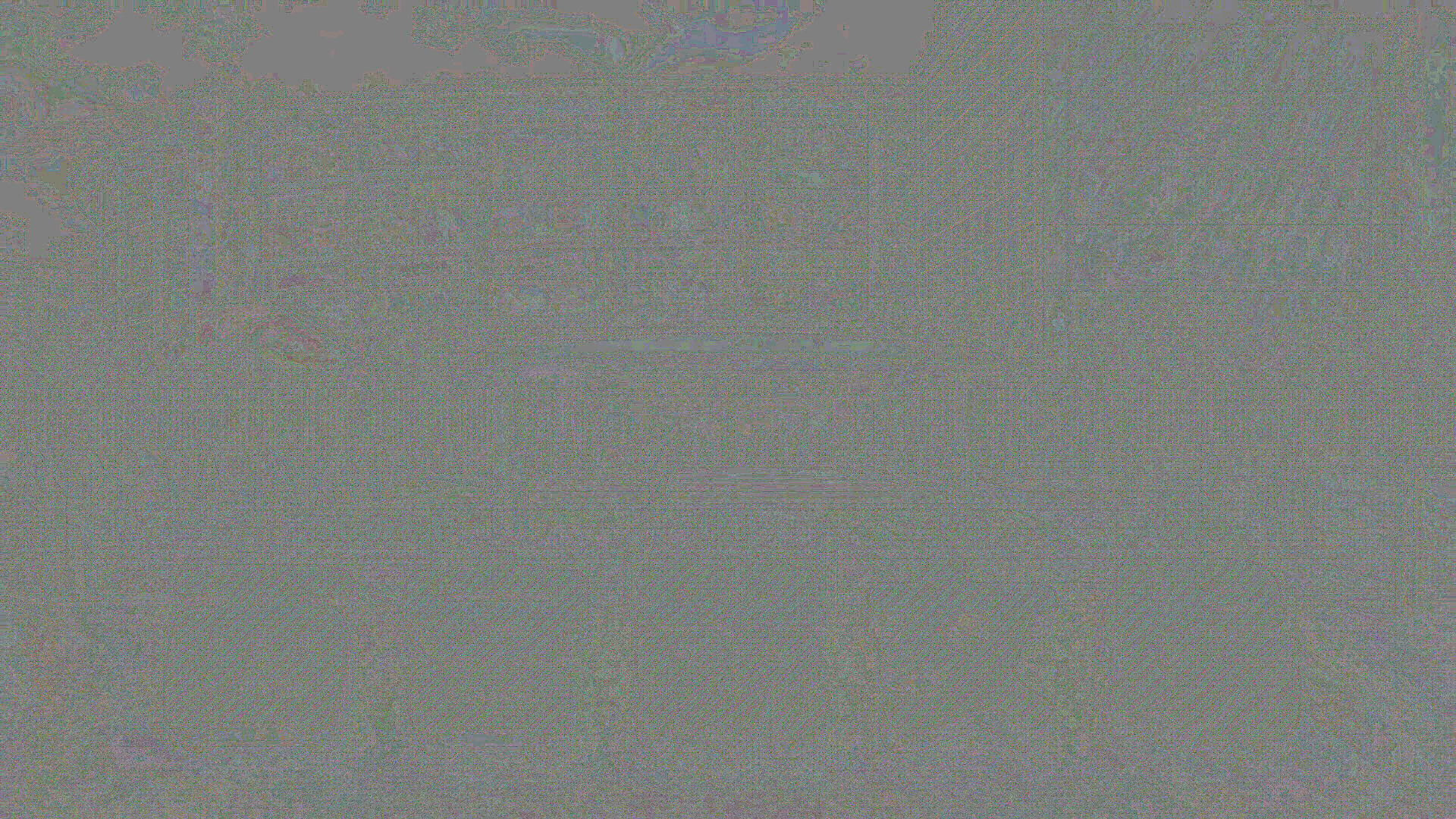

  5. Originally Posted by poisondeathray View Post
    Yes. The difference * 32:
    [Attachment 76231 - Click to enlarge]
    Identical images would have been a totally flat grey.

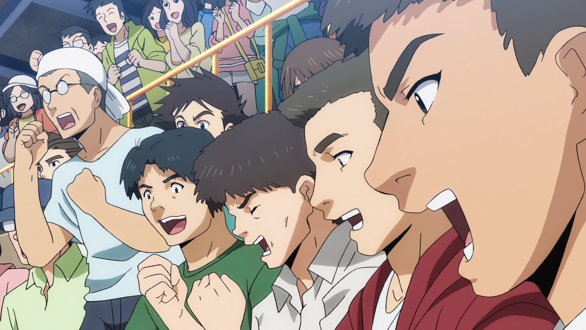

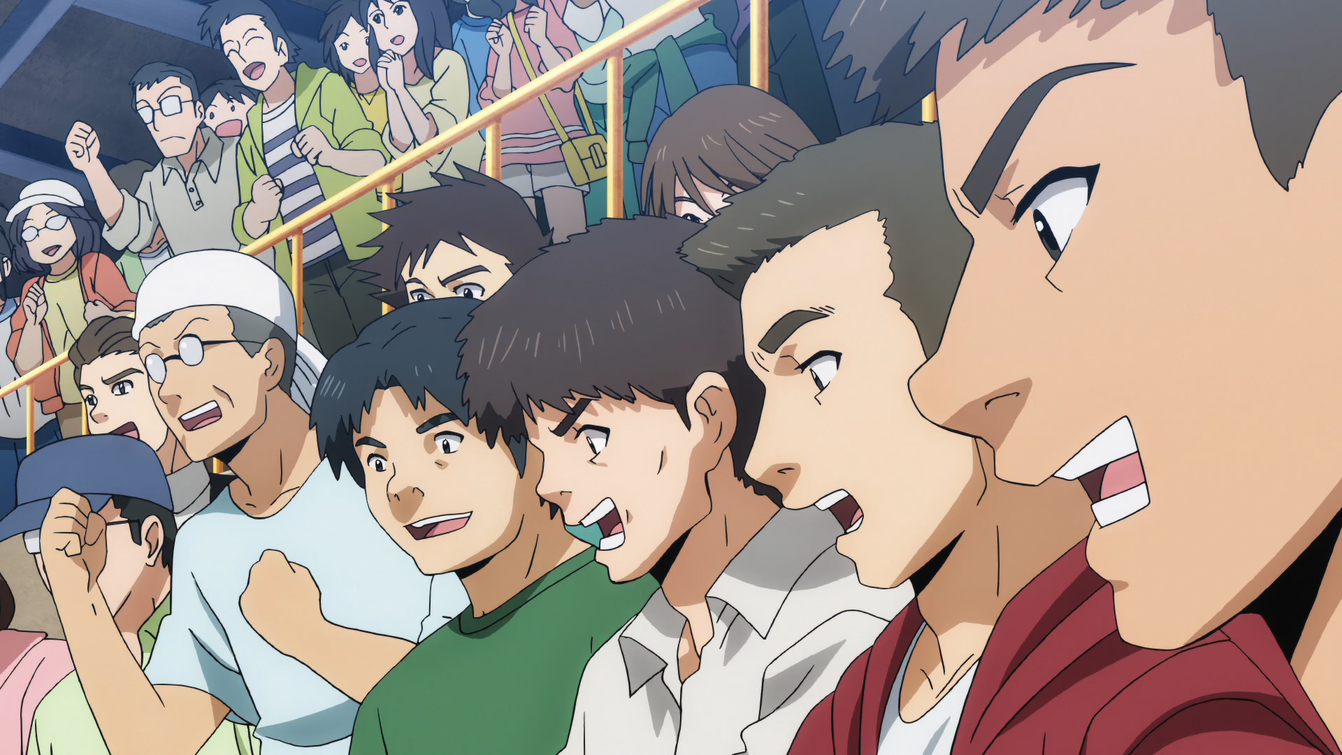

    But you can clearly see the difference.
    [Attachment 76234 - Click to enlarge]
    [Attachment 76235 - Click to enlarge]
  9. That color difference is a wrong color marix error for YUV / RGB. A 709 vs 601 mismamatch. Not a jpeg error
  10. Banned
    Oct 2023
    Los Angeles
    How do I fix the colors so that it will be visually lossless and match the input video?

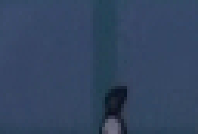

  12. jpg vs. png difference:
    crop of those two images from the first post (width=64, height=36, left=928, top=544)
