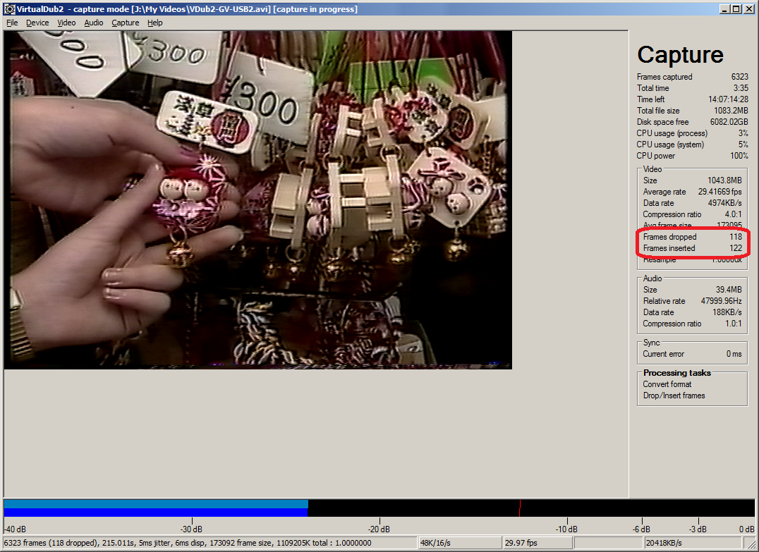

    I am playing a tape on a camcorder with built-in TBC. The left edge is rock solid, the right edge is ever slightly jittery. Capturing with the VDub2 (if you are going to suggest to use 1.9.11 then explain, how exactly this is going to help).
    With the DVC100 I easily get zero dropped or inserted frames, but I see that the Resample number (what does it mean?) is within ±0.00005 from 1, audio sync error is ±20 ms for composite, ±5 for SVideo, no audible A/V desync.
    With the VC500 I have 2 frames inserted in the beginning, and no new dropped or inserted frames.
    With the GV-USB2 I have 3 frames inserted in the beginning, then frames are dropped and inserted almost in equal numbers, about one per second (one dropped and one inserted).
    How exactly the card determines a dropped frame? I assume, it expects video to come regularly, and if the video is slightly off compared to the built-in clock, then the card registers a dropped or an inserted frame? Mind you, the built-in TBC is on, and the picture looks quite stable. I'll post samples later, I am just wondering about how dropped and inserted frames are generated/counted.
    Does anyone have similar experience?
    After playing the same segment several times and capturing it with the GV-USB2, I managed to get just 4 dropped frames in a 3-minute capture (3 dropped at the beginning, and 1 dropped sometime in the middle). So, it looks like this is related to the playback machine/tape, and I think it confirms my suspicion that the GV-USB2 is too strict regarding timing errors and is not as tolerant to timing errors as the other two dongles. So, it needs to be fronted with a very high-quality TBC?

    How do you check for dropped/inserted frames? Frames can get dropped outside of the capture card/SW which would not be noticed/reported by the capture device. Use AmarecTV for capturing rather than Vdub2 which is notorious for frame dropping. The log of AmarecTV helps to identify glitches.
    I check the number of dropped and inserted frames, reported by VDub, also I can observe glitches when the video plays.
    I wonder why AmarecTV produces fewer dropped frames - any technical reasons for that? Also, am I right in my understanding how VDub counts dropped and inserted frames? Basically, a card expects V-Sync timed to its internal clock. It would report a dropped frame if it does not get a pulse in time, and would report an inserted frame if the pulse comes earlier. Seeing both dropped and inserted frames indicates that V-Sync is not rock stable, right? Since the clock is in the card, not in the software, this count should be produced by the card and the driver, not the capture software. So, how AmarecTV is better?
    It seems that the DVC100 allows for some leeway. It seems that the DVC100 - or the combination of the DVC100 with VDub2 - results in the least number of dropped frames - reported as well as noticed visually, while the audio never drifts far away.
    For the VC500, no drift is reported, it is always 0, which is suspicious. I think, the card just does not report it. Same for the GV-USB2.

    Capturing via VDub2 is unstable. Can be 0 or 4 or 7 or more than a 100 drops/inserts for a four-minute video. Drops/inserts usually come in pairs, which to me indicates tiny inconsistency of V-Sync. AmarecTV consistently reports 0 drops. VDub2 reports zero drops on the same tape using Dazzle DVC 100. Go figure.
    I am capturing into Cineform despite having issues with Cineform in Vegas. I am using native Cineform with VDub2. V9.2.1 crashes it. OTOH, I am using V9.2.1 with AmarecTV. There are settings for AR and interlacing, but when I set interlaced to true, AmarecTV crashes. So, I capture as progressive, but then handle it as interlaced, it works.
