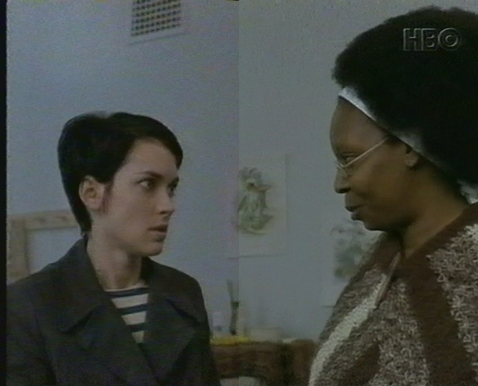

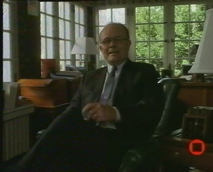

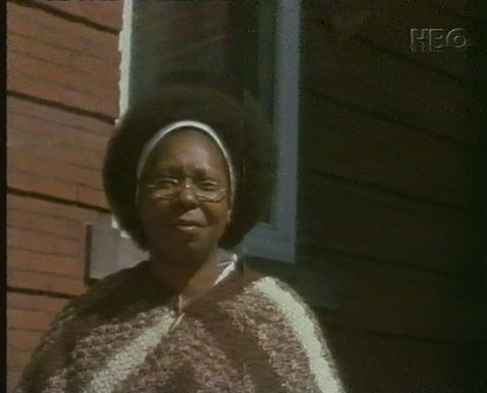

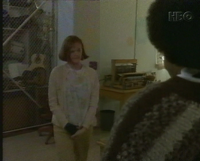

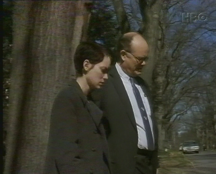

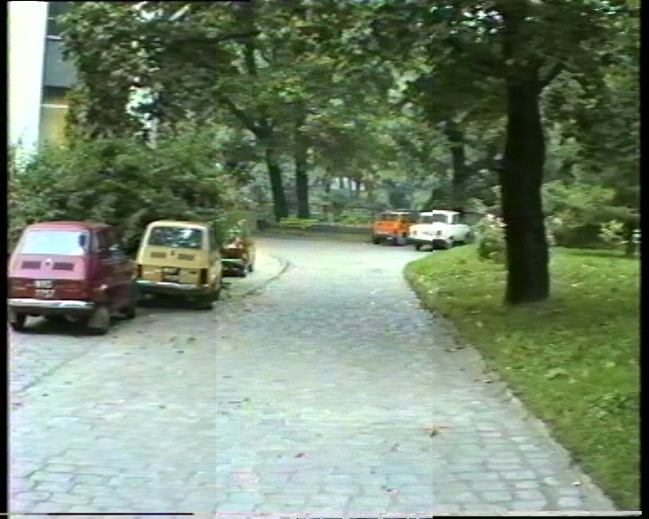

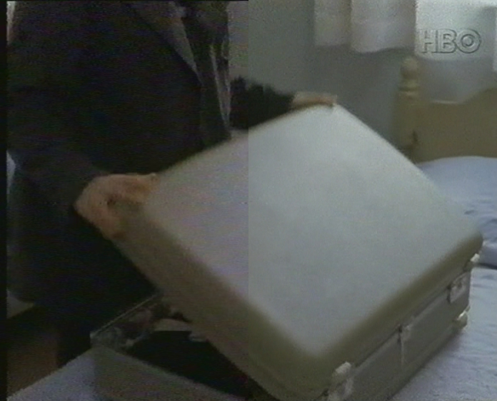

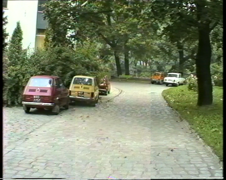

    1. JVC HR-S6850 (mode: edit) -> (SVHS) DMR-EH585 -> AverMedia ER330 (HDMI capture, HEVC 11mbit) + deinterlacing made by DMR-EH585 because Avermedia doesn't record 576i
    2. JVC HR-S6850 (mode: edit) -> (SVHS) DMR-EH585 -> (Video) DVD Recorder Ferguson (LSI chipset, MPEG-2 10mbit) + deintelacing "QTGMC preset=slower"
    Sample screenshots attached.

    Aug 2018
    Wrocław
    Another screenshot.

    The answer is pretty obvious.
    There is something seriously wrong with the HDMI workflow; I suspect it's the ER330. My HDMI captures with the Startech USB3HDCAP appear to be much better than this. This quality is what you'd get from a cheap HDMI converter.
    I don't think so - it's probably a matter of good processing by the LSI Logic chipset in the DVD Recorder (I checked - it gives clearly better quality than DMR-EH585).
    I have a cheap HM grabber MS8129, maybe I will compare it.

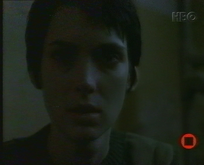

    This time I'm adding a cheap MS2109 HDMI stick for comparison:
    - AverMedia ER330 (H265)
    - MS2109 (MJPEG)
    - MPEG2 from DVD Recorder
    The source tape is of low quality as can be seen in the attached video.

    Additionally, versions after QTGMC (inputtype=1 for progressive material from HDMI devices, TR2=3)
