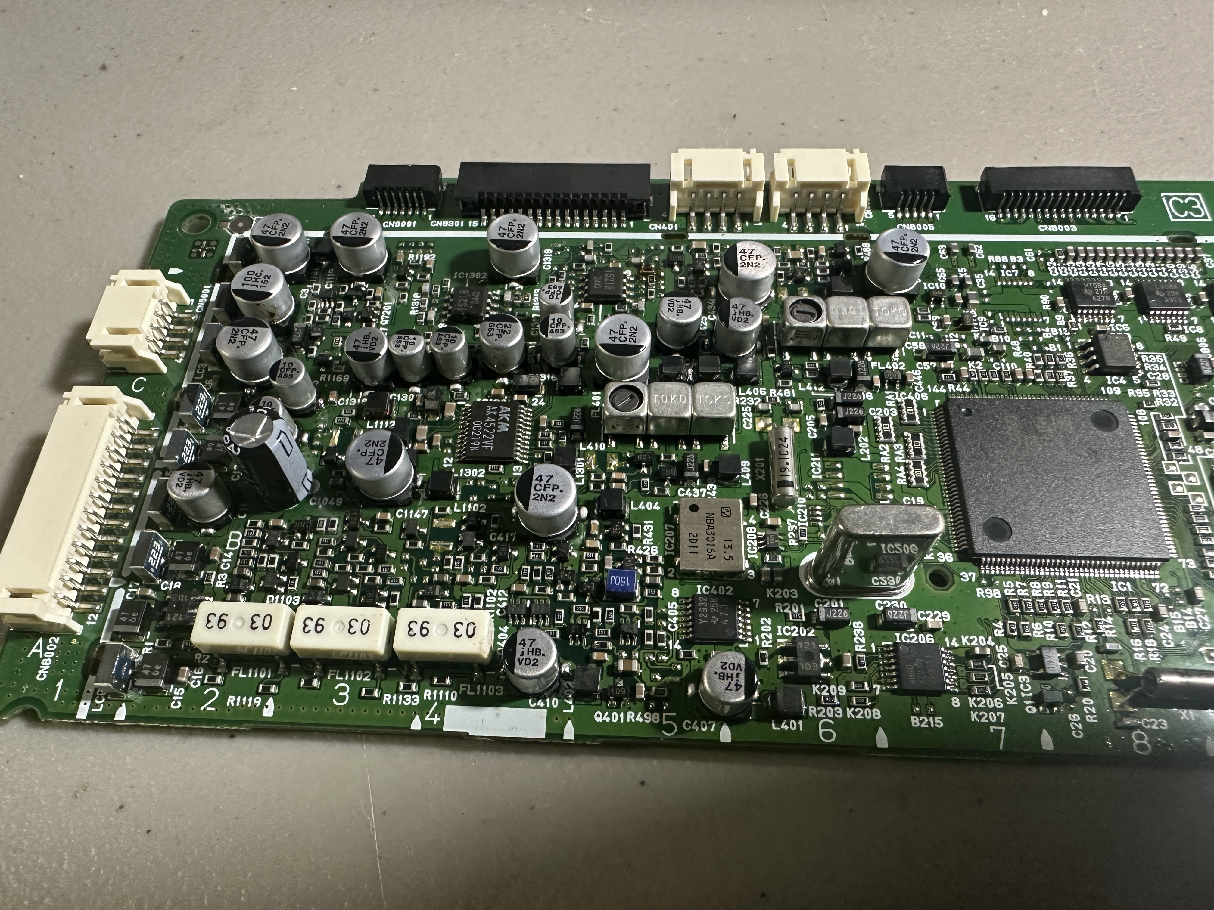

  12. Can't say much about the 30000U, but I did just restore a 40000U and I do plan to see what the MPEG2 stream is like since that could be captured simultaneously along with S-Video out. It can also do component out I believe.
    What I will say is that if the 30kU is similar to the 40kU, it'll have a bunch of bad SMT caps in the digital card which does the MPEG2 conversion and timebase correction and that could be causing issues potentially. There are about 25 of those SMT caps in the 40kU. I replace all of them because it's not worth having to take it apart later as more fail over time. There's also a few caps near the large heatsinks on the main board that are almost always completely open or very high ESR due to that localized heat from voltage regulators that should be replaced as well. The machines will often run with them being bad, but hard to say what functions will be impaired with them being bad. Picture below is after the recap of the SMT caps. I chose to remove the outer shielding during the recap to have more room to work, but it's also kind of annoying to get that shield off without damaging anything too.
