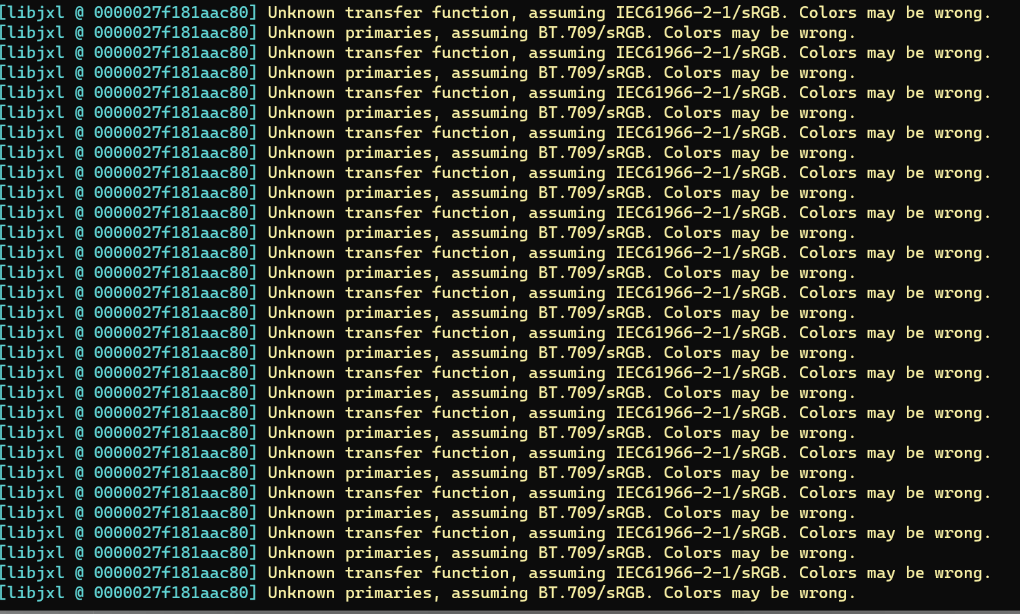

    By the way, I keep getting this for JXL. How do I fix that?

  12. Originally Posted by Jay123210599 View Post
    Those are probably correct assumptions for a typical HD source
    Otherwise you probably need to set the primaries and transfer as mentioned earlier for YUV to RGB conversions
    It looks like you need browser addons for JPEGXL support (does not come by default) . Many people will not have this and will not be able to see your images - I would avoid JPEGXL too for that reason
