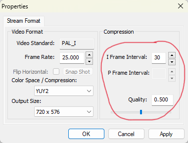

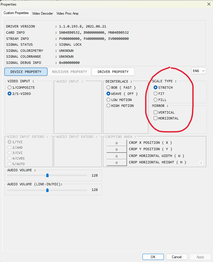

  4. Just received my GV today, my initial impression is that its much better than the Elgato. Only had a quick go with it so far but it seems to have eliminated the dot crawl that I was getting with the Elgato.
    Theres one setting that Im not sure about, just wondering if this is ok to be left at default?
    [Attachment 76339 - Click to enlarge]

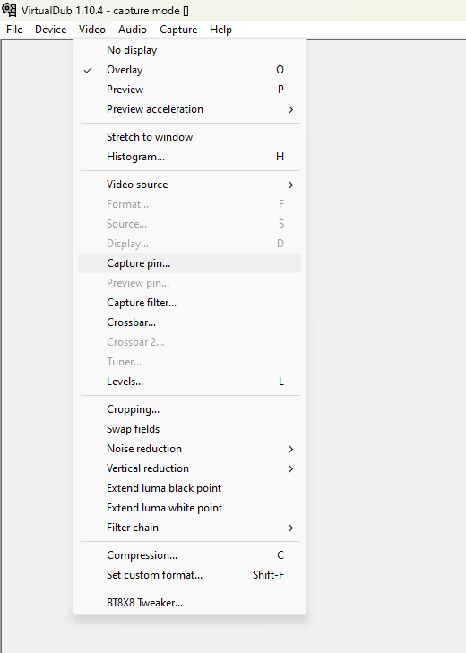

  5. Hmm... What SW is reporting these Properties? What codec are you using? Don't you capture into a lossless format?
  6. Yes I capture with Lagarith. That setting is within the capture pin option in the video tab.
    [Attachment 76346 - Click to enlarge]

  9. Forgot to mention scale type, wasnt too sure about this one either.
    [Attachment 76347 - Click to enlarge]

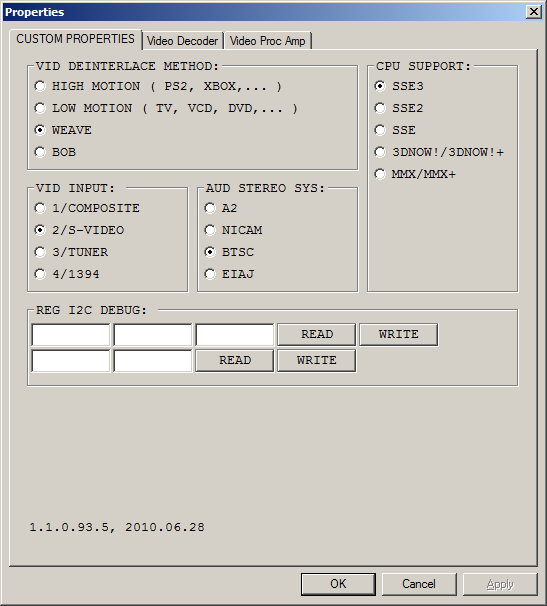

    Interesting. My GV-USB2 shows different custom properties panel - it looks identical both in VDub2 and AmarecTV.
    Mine shows 2010, yours is 2021. Clearly, judging by the CPU support section, mine is way old.
    Did you buy yours from Amazon Japan? I wanted to buy from Japan, but in the end I bought from a reseller on Amazon US.

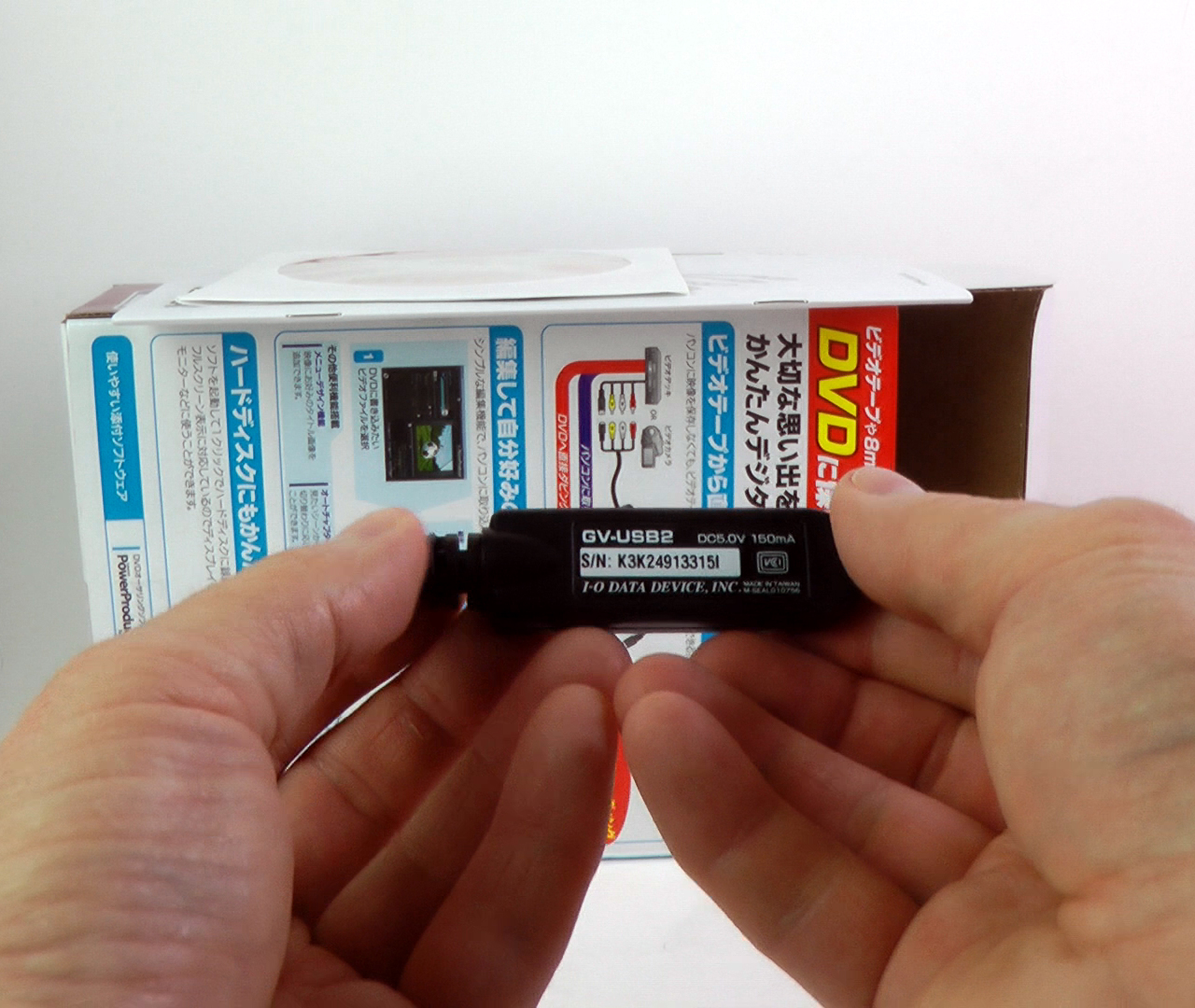

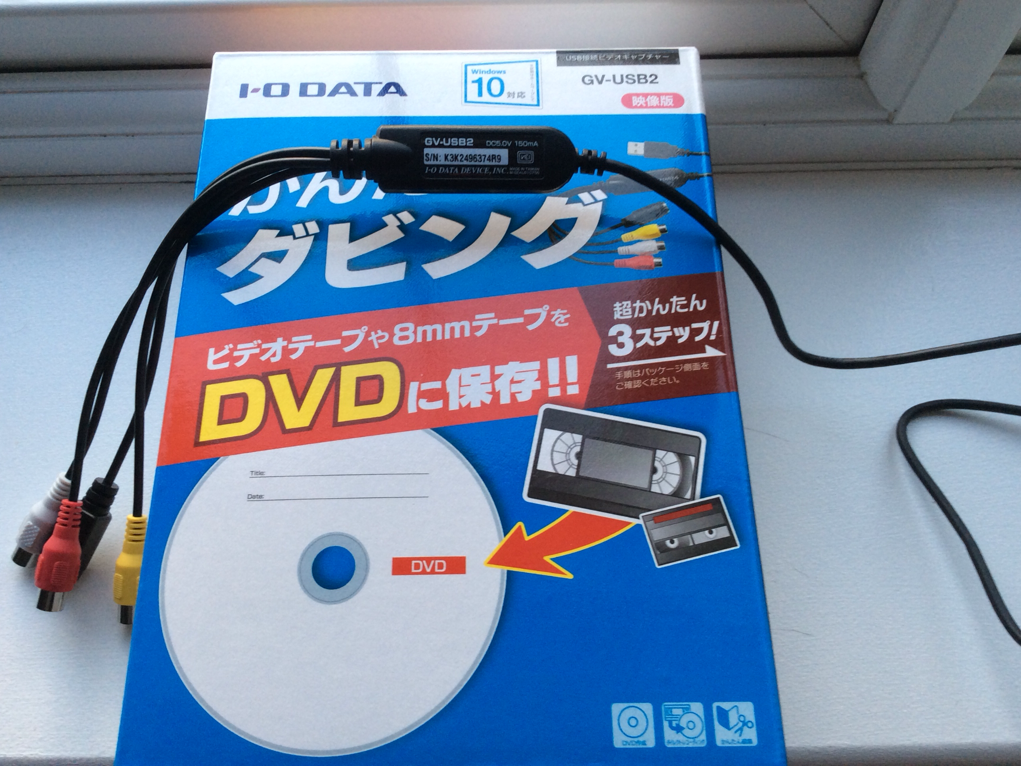

    Also, does yours say GV-USB2, or GV-USB2/A, or GV-USB2/E or GV-USB2/HD? Can you post a picture of it, from both sides?

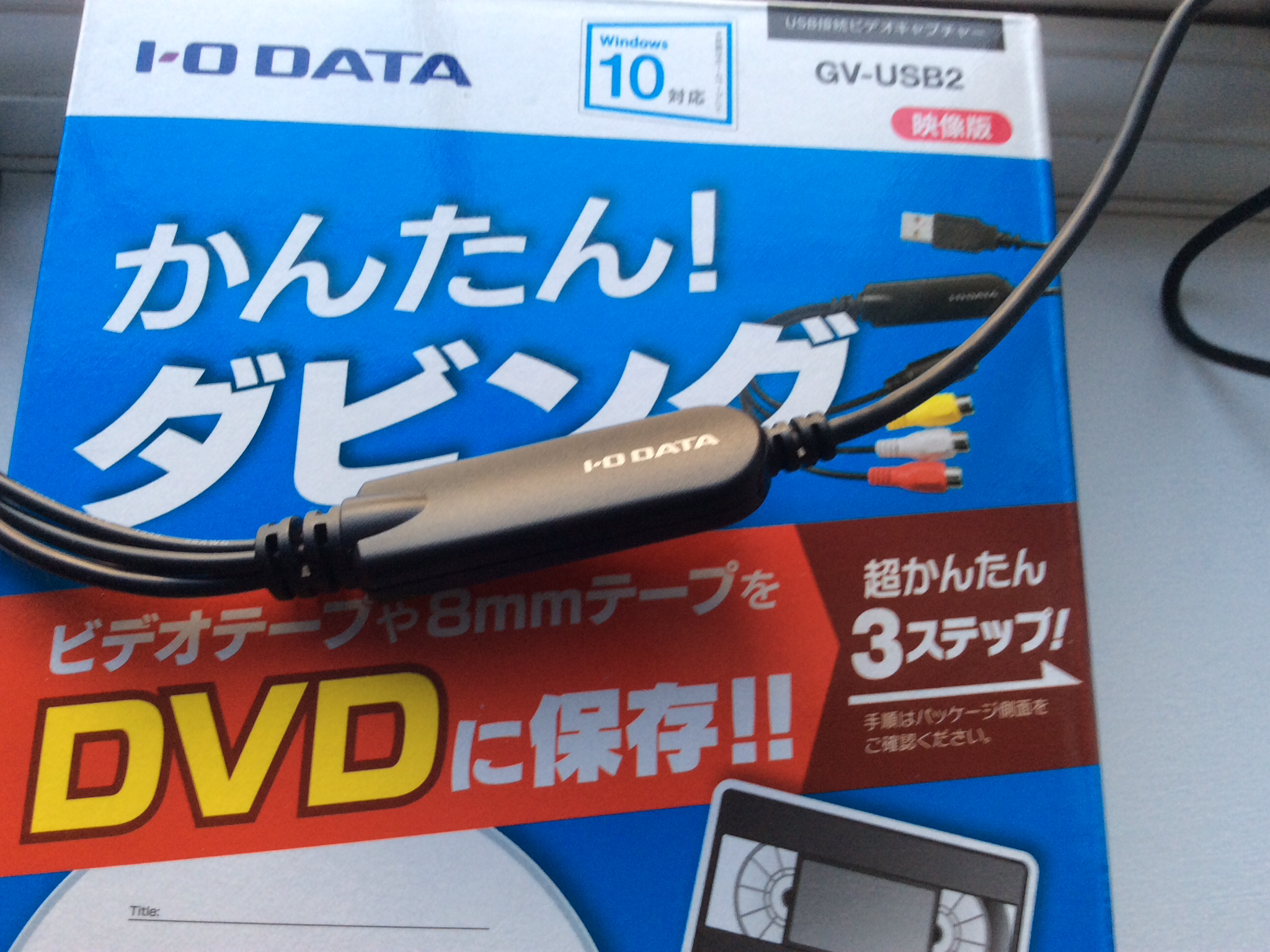

  11. Mine just says GV-USB2. It came from Amazon US. Yours doesn't have windows 10 on the box then?

    It does. Hmm. Have you installed the drivers from the bundled CD or downloaded from their website? I installed from the CD. Also, I use Win7. I guess I need to try installing on Win10.
  13. Mine looks exactly like Bwaak's (slightly different S/N of course). Same Properties, same Version and Date. I ordered it from Japan.
    I use(d) it on W7, W10 and W11.
    Your driver is newer, but I think it's ok and you can leave as is. Maybe upload a short capture.
