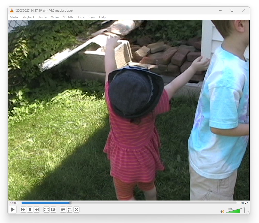

    Here is a link to an AVI file I captured : https://drive.google.com/file/d/1lnzIRW-dUVXZNd1mqbt5mJEKzJDlb3P-/view?usp=sharing
    Hopefully that works. I'm new to this.
    And one more thing I noticed - that video that had the frame that stopped but the audio kept going was not a problem with sclive. That's the way the tape plays. I have no idea why that happened. Ghost in the machine.
    I am starting to feel like I'm on the right track with the DV videos. Baby steps...

    You've nailed it. That clip is great, and looks very much like a standard DV clip. Mediainfo shows normal DV-AVI characteristics. In VLC Player with all the sides pulled in, this is what it looks like:
    [Attachment 76147 - Click to enlarge]
    There are no side bars, so there's no encoded black video there, and it's a proper 4:3.

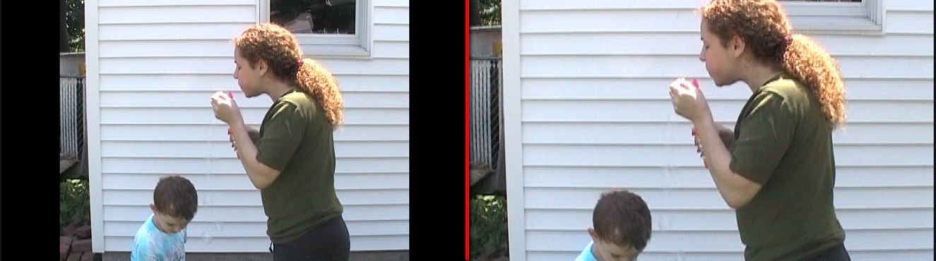

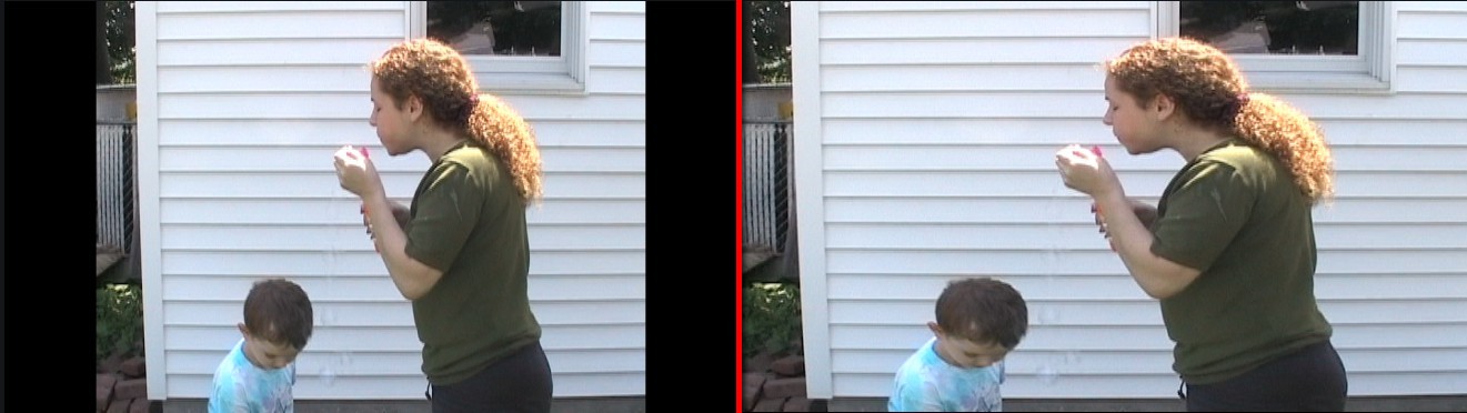

    The great 4:3 on a 16:9 screen conundrum. You've got two options. The below images are 16:9 screen aspect.
    1. Crop off the top and/or bottom to make the frame fit into a 16:9 aspect, while maintaining the correct proportions:
    [Attachment 76149 - Click to enlarge]
    2. Stretch the video laterally to make it fit the 16:9 aspect but make the video objects look wider:
    [Attachment 76150 - Click to enlarge]
    On your TV, you should be able to achieve both options by either doing a straight Zoom or using Stretch to Fit or similar.
    Option 2 is the worst because the video is distorted. Option 1 can work, and I have done it before, when there's no meaningful video at the top and the bottom.
    Also, the HD Tape that I converted to mp4 has no side bars. I guess that's because it is not 4:3.
    Correct. HDV is 16:9 to start with so it will fit with no bars.

    Strangely when I created the final mp4 file merging all the .avi files it produced a smaller .mp4 than Elgato did.
    For this tape using WindDV creted about 10 GB of AVI files that compressed down to about 750 MB with no loss of quality that I can see.
    Elgato produced a 1.3 GB mp4 using the analog out to the Elgato card. Looking at both videos on the Samsung I don't see any difference in quality. The only difference is that I was able to delete some dead frames and there are no blue screens in the mp4 I created using WindDV and Moavi.
    So it seems that for the DV tapes I can get away with using Elgato which is easier.
    I would appreciate your thoughts on why there is no visible difference in quality between the analog and digital conversions for this tape which is a "DV" tape.
    The HD Tape came out much better using HDVSplit. That one was drastic.
