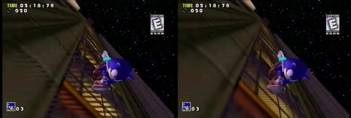

  9. In some of the shots interlaced frames were resized vertically without consideration for the interlacing. That causes the problems you are seeing when deinterlacing. It's one of the reasons I suggested just using QTGMC -- the problem is a little less noticeable with the doubled frame rate.
    Another way of dealing with that is to blur the two fields together.
    QTGMC on the left, fields blurred together on the right:
    [Attachment 76154 - Click to enlarge]

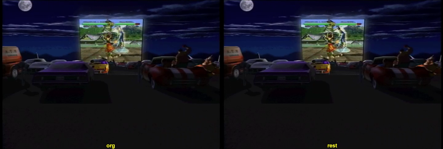

  10. just for fun: QTGMC_BasicVSR++_NNEDI3 => too smooth
