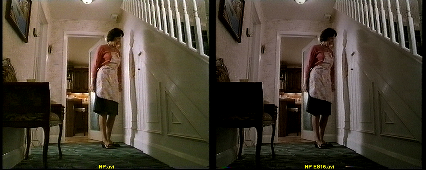

    My quick contribution.

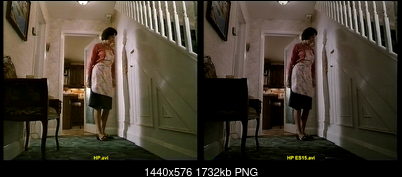

    You capture is fine.
    The ES-15 does not bring any advantage (did you turn off the TBC of the 7600 while using it?):

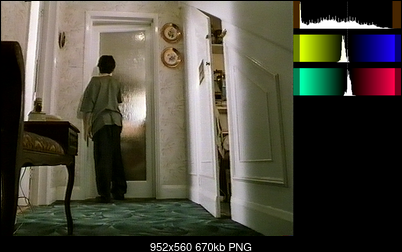

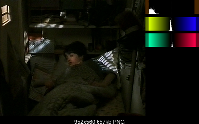

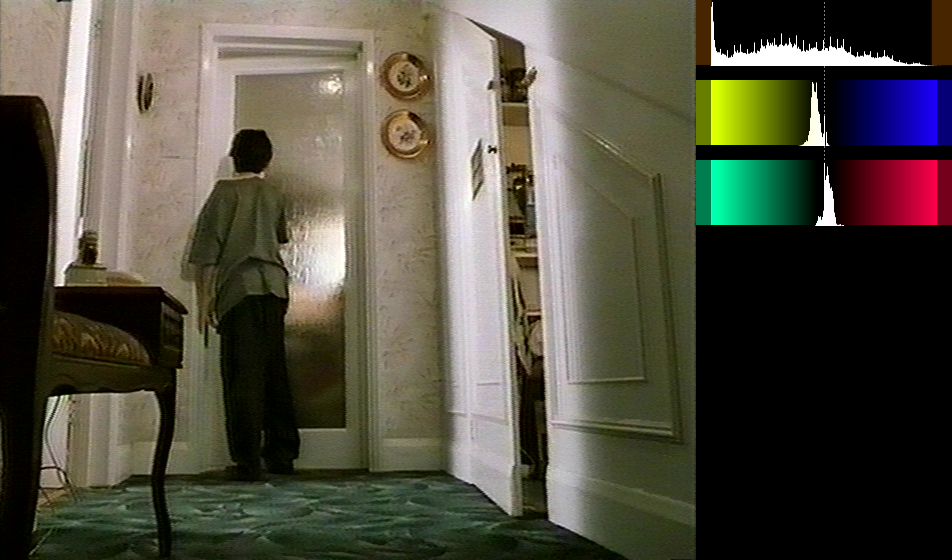

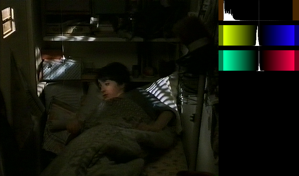

    In general the levels are sufficiently well distributed, but you may want to experiement if reducing brightness and contrast in the procamp can avoid some accumulation in the blacks close to Y=16 and reveals more details:

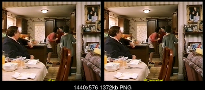

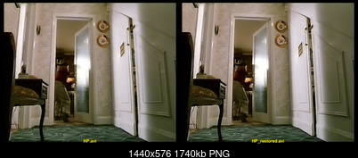

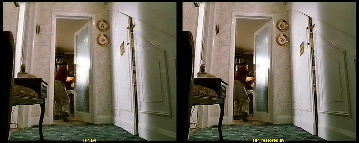

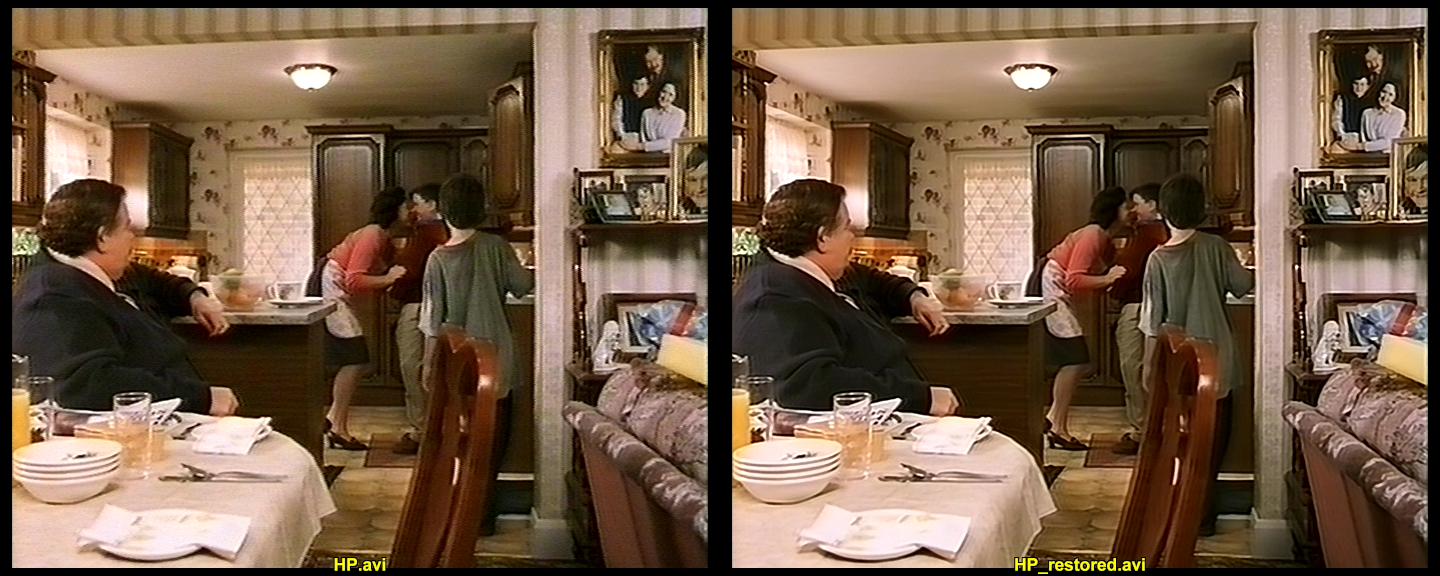

    Here my usual attempt of basic restoration, with just denoise and sharpening:
    HP_restored.avi
    and some frame comparison about it:
    with image slider: https://imgsli.com/MjMxMzcy
    with image slider: https://imgsli.com/MjMxMzc2

    I tried to set the levels using VD histogram I made sure the edge was not red and the blue was in the middle. I followed user Alwyn's tutorial from YouTube. https://www.youtube.com/watch?v=XYlNS3s0ZN0
    Lowering contrast crushes black level and lowering brightness can effect white levels, every tape is different the brightness and contrast can change from scene to scene outside scenes will be bright than a night scene it's very difficult to get the right balance.

    I like these I think you added a bit of saturation right?
    No, just denoise (TemporalDegrain2(degrainTR=3) and sharpening (LSFmode(defaults="slow"))

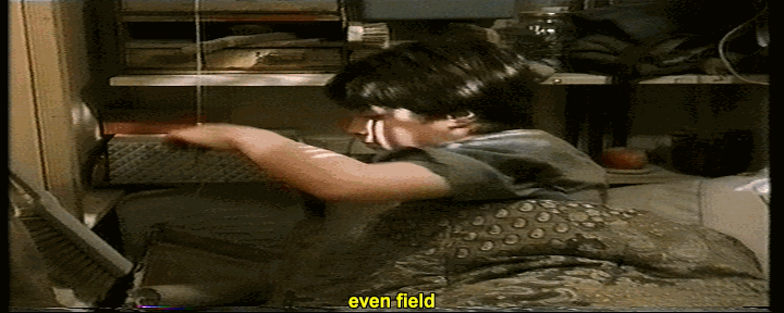

    This I don't understand you will need to educate me on this
    Are they progressive? If it is I can still see interlace lines in the picture

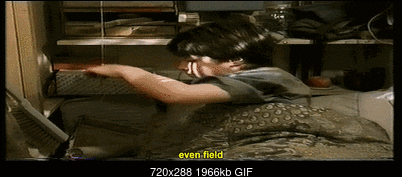

    First step, write a simple AviSynth script and open it in VirtualDub, or use Hybryd for the whole if you ar emore familiar with it:
    video_org=FFmpegSource2(HP.avi, atrack=-1)
    # separate fields tff
    video_org_sep_tff=video_org.AssumeTFF().separateFields()
    	# to check if progressive or interlaced
    return(video_org_sep_tff)
    Now step field-by-field and check if there is motion between the fields. If there is the video is interlaced, otherwise is PsF. There are many other cases (NTSC telecine, PAL phase shift, etc.), but just focus on this for now.
    Here a sample of what you should see:
    You can notice that the pixels inside the fields move in the vertical direction across them; that's because one field contains the odd lines and the next the even lines.
    This is always the first operation to perform on a capture, to understand the architecture of the source. Then comes the analysis of the levels and so on, but that's another story, maybe for the next post if you need.
    Last edited by lollo; 7th Jan 2024 at 06:09. Reason: replaced animated gif, now including field type subtitle
