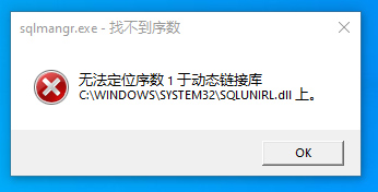

i played with the software a little bit more today. here's more info... the XVIEW software is part of a suite of programs used for those karaoke rooms that you can rent out by the hour. another part of that software is the database that keeps track of file names, descriptions, and whatnot. the database runs off of some version of microsoft mysql server that only runs in an older version of windows 10. if i update windows, there is an error about running SQLUNIRL.dll.
[Attachment 76046 - Click to enlarge]
if i run the ViewPlayer.exe file, i get the "class not registered". i've tried manually registering all the dll files with no luckLast edited by bladerelic; 5th Jan 2024 at 19:26. Reason: added info

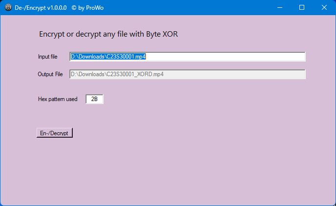

Thanks to Jagabo's excellent analysis, I have written a small portable program that can be used to decrypt your videos.
The app reads the first byte of the encrypted file (e.g. 3B as in Jagabo). Since we know that the original file has 00 as the first byte, 3B is the key for this file.
All bytes are then XORed, which can take longer for long video files. The output file is then decrypted and freely available.
However, if the original file does not start with 00 (e.g. an mkv file, then the key must be determined by XORing the first byte of the encrypted file e.g. 54 with the correct byte e.g. 01, in this case 55.
You can use an onlile calculator for that. https://xor.pw/#
It may be that my program is detected as a virus; I assure you that this is wrong. Of course, both the name and the byte manipulation are suspicious for virus scanners, but the program is clean.
I also used it to decrypt and attach one of your little videos from above.
NB
You can also encrypt any file (picture, video, documents etc), but remember the key or the files are lost.
