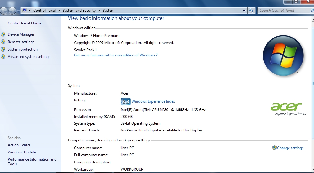

    and look at the last post (post 14) the problem is solved using Streamlink .However, I now have a different computer, and the saved audio file (file.aac) now goes to an inconvenient place (Windows/system32). How can I get the audio file to save, for example, on the root of the C drive? ( See screenshot 1 for the details of this computer.)

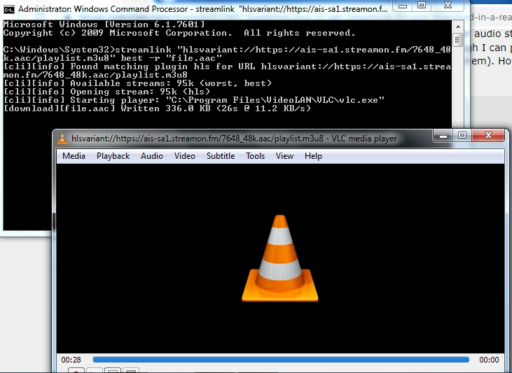

    streamlink "hlsvariant://https://ais-sa1.streamon.fm/7648_48k.aac/playlist.m3u8" best -r "file.aac"
    (screenshot 3 shows the Streamlink command line.)

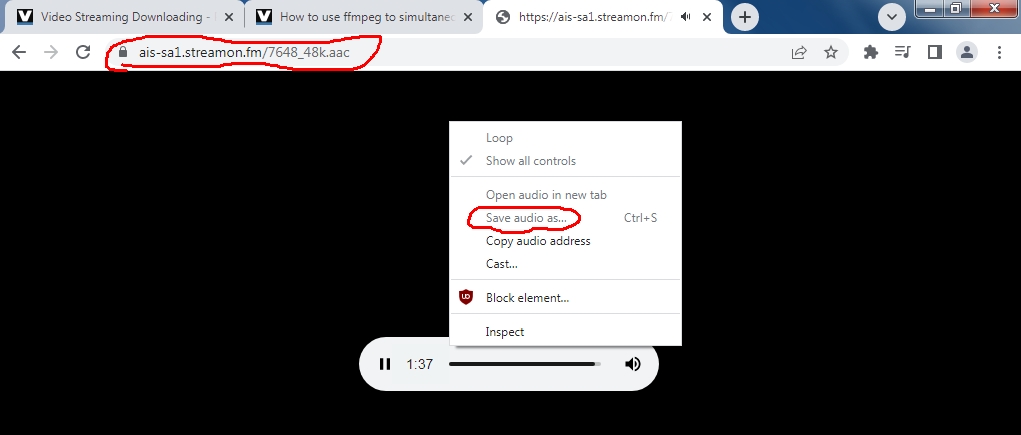

    Also, I have another question. With the previous computer, I could put an audio stream url in the address bar, play the audio and record the stream. However, on this computer, although I can play the audio stream, but the "Save audio as" is greyed out. (See screenshot 2 that illustrates the problem). How can I ungrey the "save audio" option and record the audio this way?

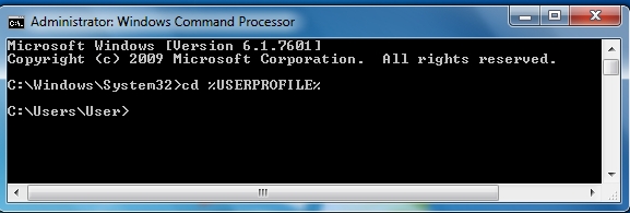

  2. In your terminal run:
    cd %USERPROFILE%
    or just avoid running cmd as administrator, which will default the working directory to %USERPROFILE%.
  3. Ok, thank you, that worked (cd %USERPROFILE%). The audio download on this computer will then appear in:
    C:\Users\User
    See screenshot 1

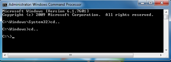

    Another way to change the download location (in this case to the root of the c drive) is to open the cmd and type in:
    cd.. <enter>
    cd.. <enter>
    See screenshot2

  4. Originally Posted by jimdagys View Post
    cd.. <enter>
    cd.. <enter>
    See screenshot2
    Well, of course, cd stands for change directory, so every cd command will change the current working directory.
