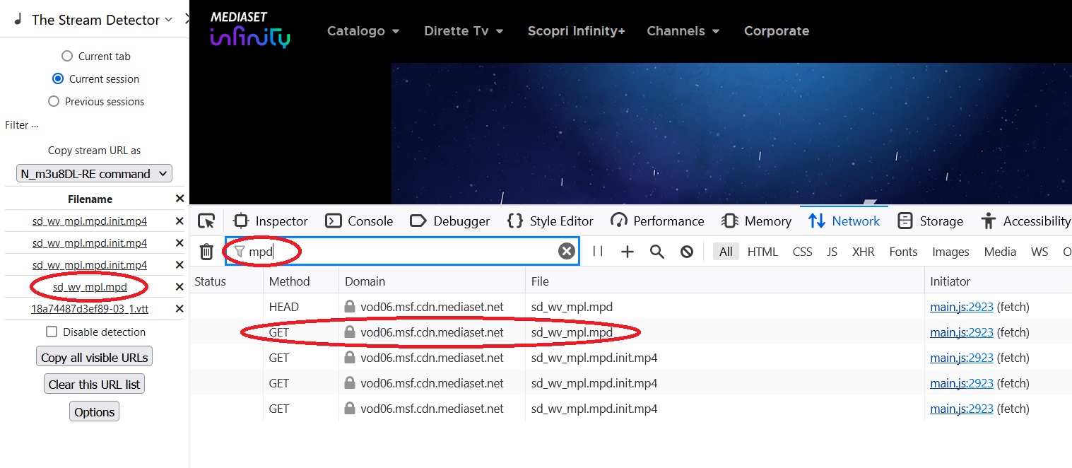

  6. Originally Posted by supergirl73 View Post
    I tried searching for URLs in the developer network table, but I can't find the link you gave me
    I also installed the stream detector extension, but honestly I can't use it, forgive me, but I'm a beginner, but if you have a little patience I'll get there
    You have to open the developer options (F12) before you load the page/video (or simply refresh). This is what it looks like in Firefox (as you can see I filtered for "mpd").

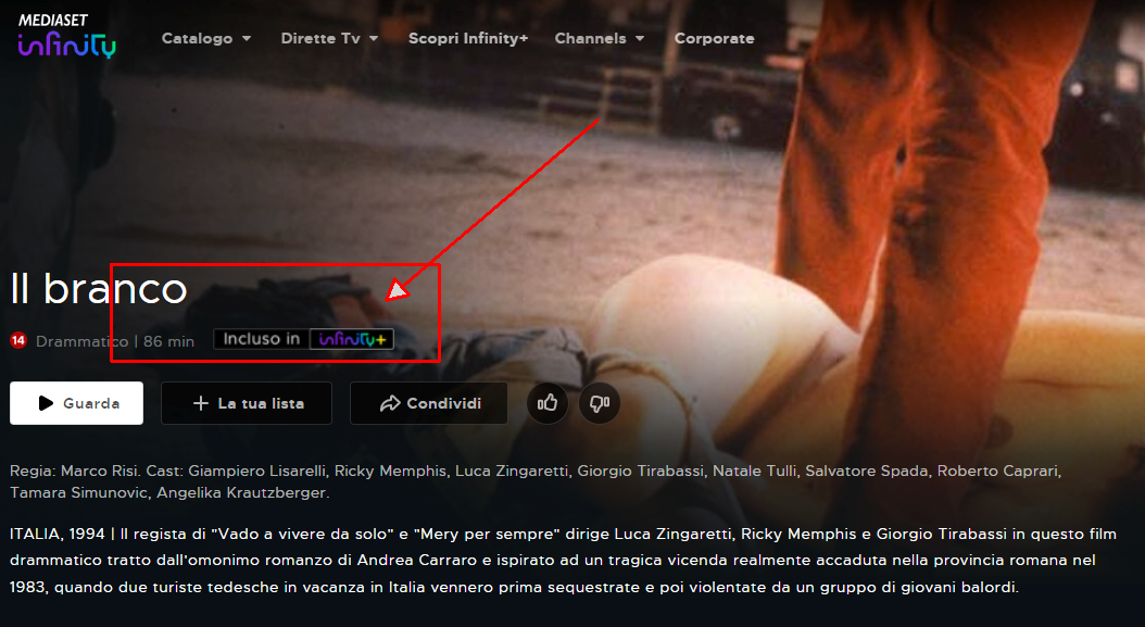

  7. this link isn't free to watch. need infinity+ account
    [Attachment 76032 - Click to enlarge]
  8. Originally Posted by lomero View Post
    ok...sorry

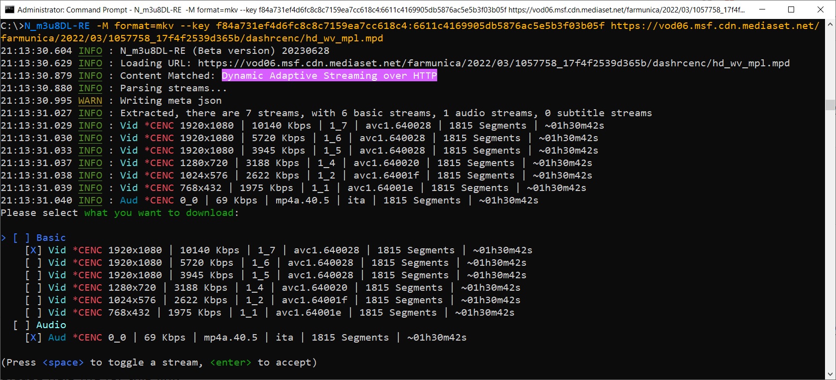

  23. Where can I see the various downloadable resolutions of the video?
  24. Originally Posted by supergirl73 View Post
    N_m3u8DL-RE displays them:
    [Attachment 76323 - Click to enlarge]
    Notice how I changed sd_wv_mpl.mpd (which is what you get from the browser) to hd_wv_mpl.mpd to get the high definition streams.
