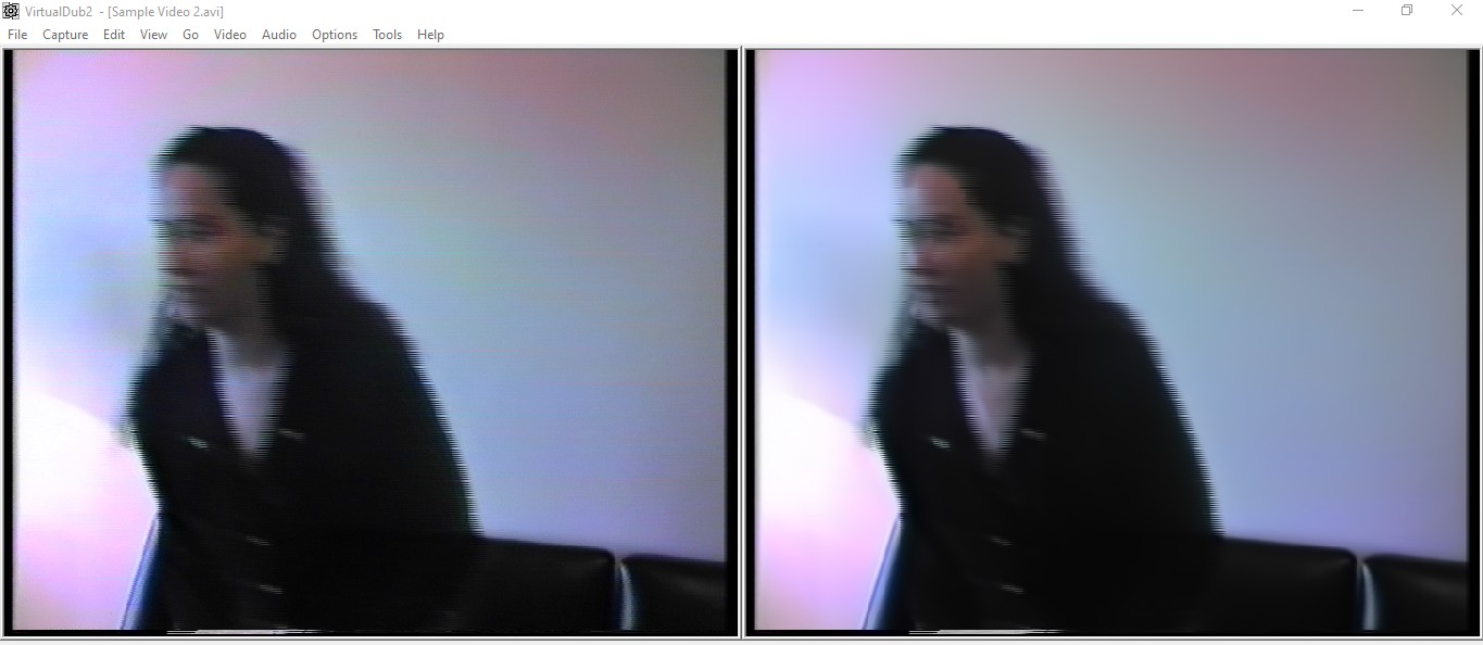

  20. If you play the samples as is that is what they look like on the tapes. The goal is to make the samples deinterlaced without the patterns appearing. Blend achieves that, but why? Blend combines two fields into the same frame, right? The patterns appear only when deinterlacing with any other method. Now, why do they appear even when not discarding the other field, say by doubling the frame rate with Yadif? Maybe combining deinterlacing methods can fix the issue, or some kind of filter? When the two fields are combined it forms a consistent colour. When one field is removed it leaves a pattern. I've never seen this before.
    I know that it can be fixed with AviSynth, but I am not ready to start learning scripting yet.
    On a side note could we please stay directly on topic?

    Goal? Not recommended to deinterlace your interlaced video. For DVD leave it interlaced, 25i, means 25 interlaced frames per second= 50 fields per second, perfectly DVD compliant. But we have been through this in your former thread. For some obscure reasons like "plays back too fast" you stick to deinterlacing to 25p it seems. So be it.
    What "blend" are you talking about? Which filter(s) did you use?
    Combining the 2 fields into a frame is called "weaving". On a progressive monitor you see the typical combing, unless it gets deinterlaced on the fly (real time) at playback time by the player/TV - which is what happens for DVDs. Player/TV deinterlacers are at least as good as yadif.
    Both fields are unfortunatley 'damaged' (rainbows and dotcrawl). There is no clean field.
    Step through the attached video and you will see that both fields are contaminated.
    Not really fixed without a compromise, but mitigated, yes. Learning Avisinth would be a good investment of your time. Until then someone else may chime in with some advice for a GUI.

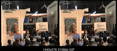

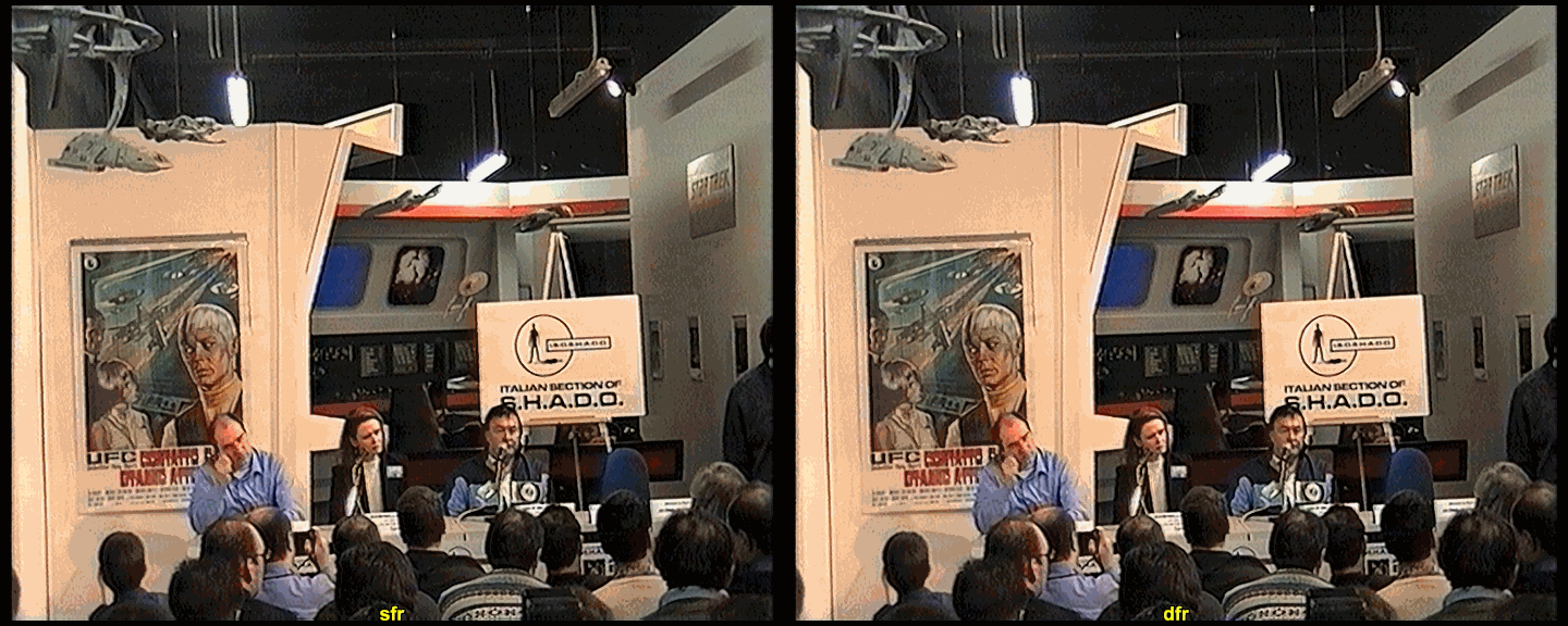

    And now an example, instead of your common blah-blah without facts. This is an interview to some actors, recorded in SVHS (not by me) and captured (not by me), that I am processing for distribution.
    The major part of the scene is almost fixed (very few object move) but there is some motion. And here a comparison between a processing with QTGMC at double frame rate and QTGCM discharging a frame.
    The result is obvious.
    P.S. in the comparison the single frame rate has been duplicated to match the double frame rate sequence.
    comparison (look the hand moving):

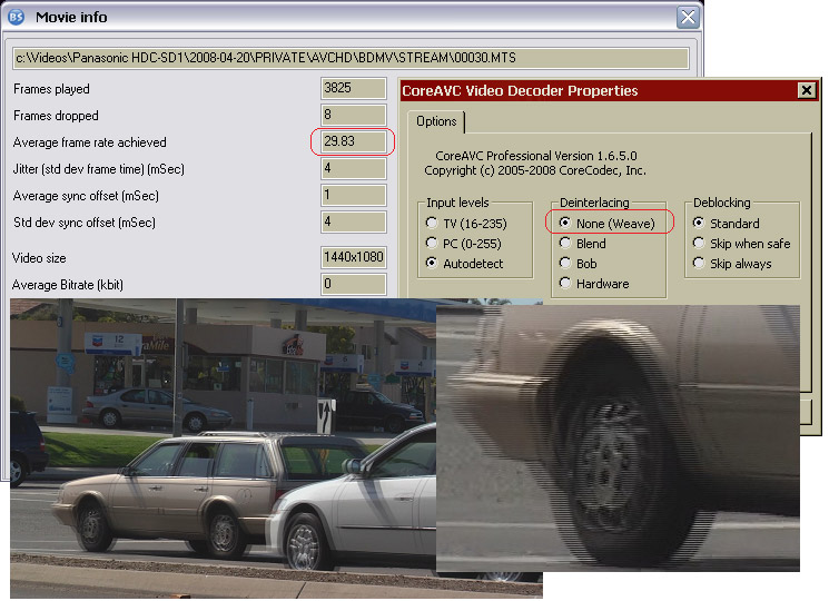

    Back when I used CoreAVC, it has clearly listed all the deinterlacing options, including None (Weave). Since the target display was a computer screen, you had to choose one of the deinterlacing options. The only flat-screen technology that could natively displayed interlaced video was Hitachi ALiS.

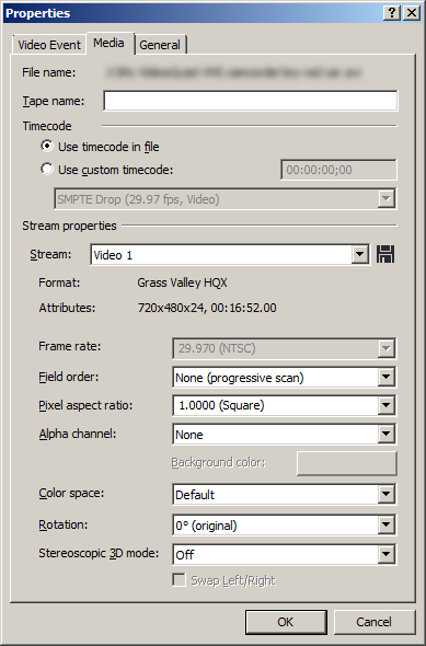

    Whenever I use video captured with VirtualDub2 on a Vegas timeline, Vegas reports it as progressive with PAR 1:1 no matter the codec, I suppose because AVI does not have a well-defined way to describe this in the metadata, or maybe this is just a VDub's bug. So I have to remember that it is interlaced PAR 10/11, or just visually check each clip, which is a nuisance.

  29. Guys, the OP's (Ferrari420) captured video is truly interlaced - as it should be, full stop.
    The OP should understand the consequences when deinterlacing it to 25p, and he should understand that 25i (=25 interlaced frames per second) on his DVD would preserve the motion smoothness, and he should understand that the corresponding 50 fields per second do not speed up the video but double the temporal resolution = improved motion smoothness. When he insists on 25p (=25 progressive frames per second) for whatever justified or unjustified reason he will have to accept a certain 'stroboscopic' effect for scenes with motion - unless he would artifically increase the motion blur by means of a filter to make it visually appear smoother but reducing sharpness at the same time, not exploiting the potential and quality of the capture. It can be done, but it's not really recommended.
    Still, this has nothing to do with the dotcrawl and rainbows of his capture examples, as both fields are equally affected. The reason for this may be his composite video, poor luma/chroma filtering, poorly screend cheap cables producing crosstalk, or it may be baked onto his tape.
