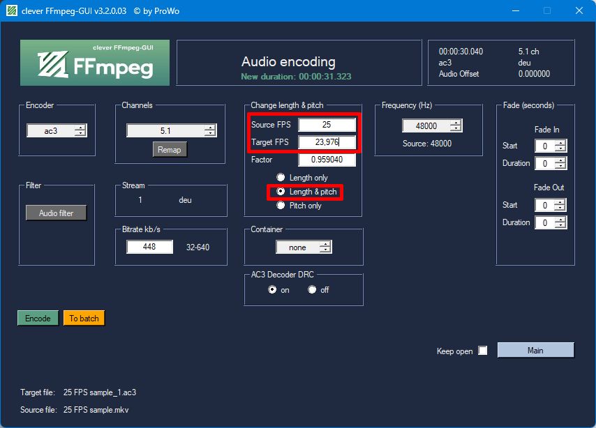

  2. You can use clever FFmpeg-GUI to change the audio, so the video quality isn't changed.
    [Attachment 75936 - Click to enlarge]

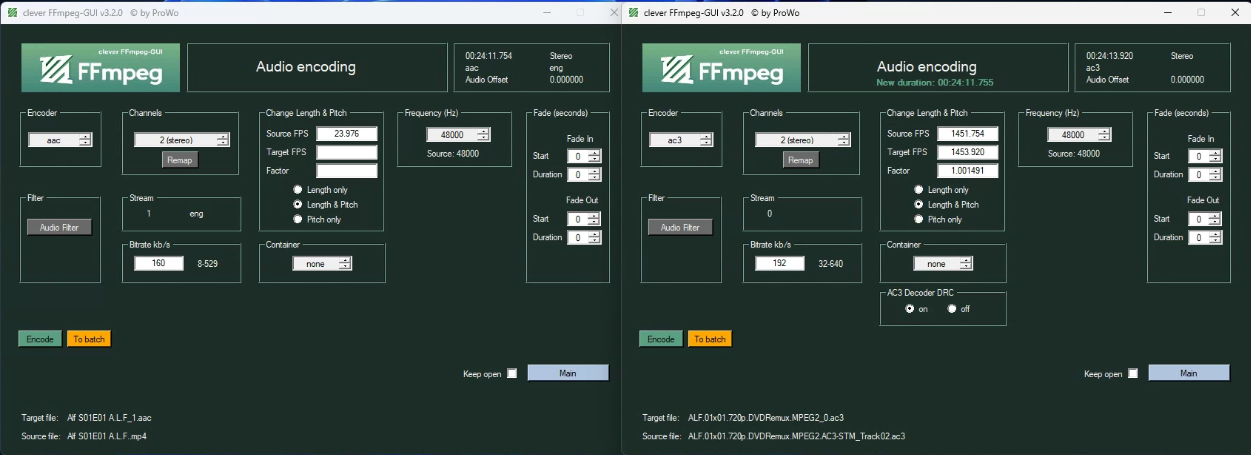

  3. The new duration should be 00:24:11.
    The content of both video files is exactly the same. From start to finish 1:1. Only 2 seconds difference.
    Why does this happen?

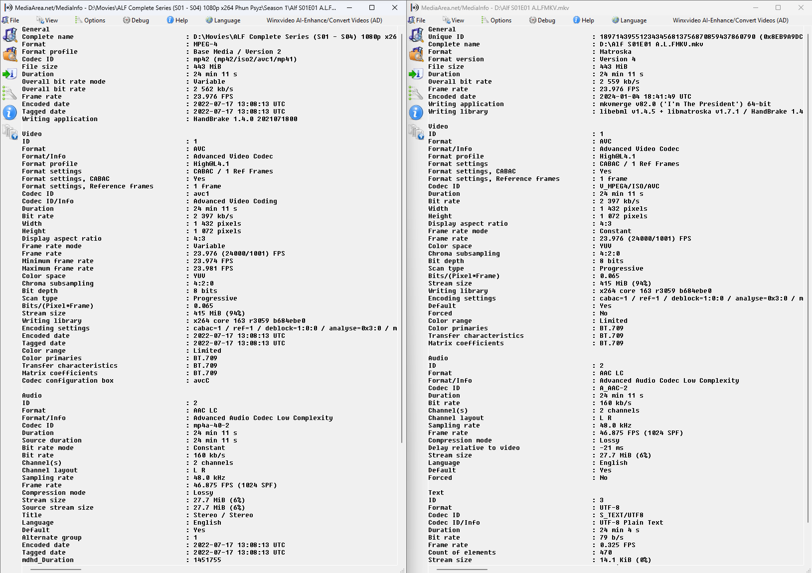

  6. Originally Posted by amxcs View Post
    Yes, by 2 seconds.
    And when I convert audio from 25 to 23.967, there is a difference of over 1 minute.
    As a test, I tried putting the audio from a 25fps video into the video with 23.976 at the beginning of the video it is fine, but towards the end of the video there is a discrepancy of 1-2 seconds.
    The second video (at 23.976 fps) is not encoded correctly. If the frames content is exactly the same, this video MUST have a longer duration than the 25 fps video.
    The first video displays 25 frames per second, the second 23.976 frames per second, which means that the second video takes longer to display all frames.
    The 23.976 fps video was obviously re-encoded from a source with a different fps without adjusting the duration, and frames were lost in the process.
    This 23.976 fps video also has a variable frame rate.
    Mux this mp4 into an mkv container and see what framerate is displayed in mediainfo.
  7. I think it's the same?
Name:	Screenshot 2024-01-04 231516.png
  8. No, it's not the same.
    Now mux the 25 fps audio to the new mkv video.
  9. Again 2 sec out of sync towards the end of the video.
    I've tried reducing the audio by 2 seconds or increasing the video by 2 seconds then it's synced but I'm not sure that's the right way.

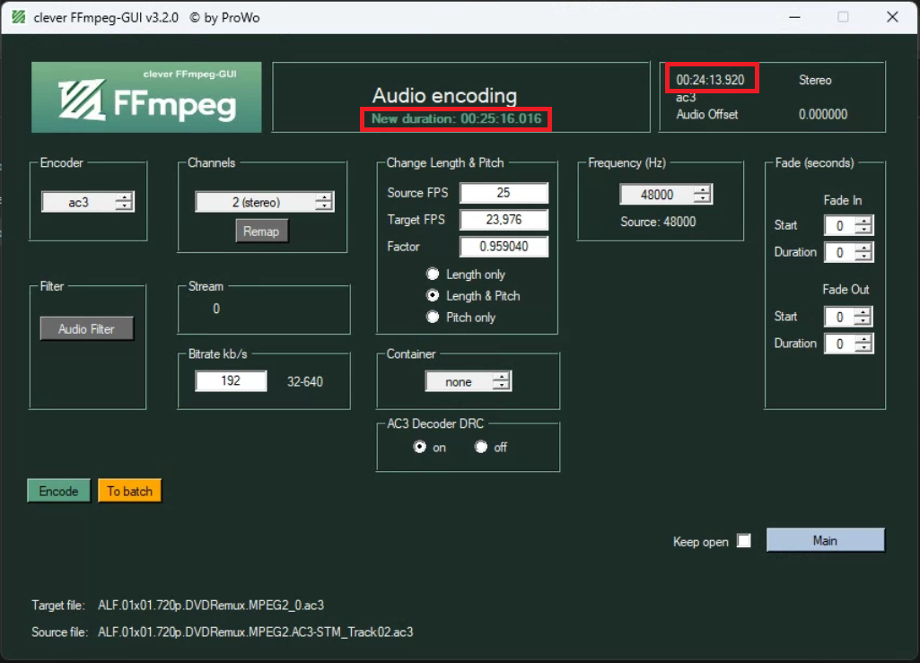

  10. Then try this:
    The exact duration in seconds of the audio stream of the 25 fps video is already specified in the upper field (24:13.920 is equal to 1453.920 seconds).
    Determine the exact duration of the 23.976 video (load the video in clever-FFmpeg-GUI and the exact duration will be displayed in the top right corner), convert to seconds and milliseconds (as above) and then enter this value in the second field.
    [Attachment 76020 - Click to enlarge]
    Then encode the 25 fps audio stream and mux it with the 23.976 video.
    The 2 second difference is now gone.
    This operation (see picture above) must clearly be carried out with the 25 fps video audio stream.
    If the audio is still not synchronized, you will have to adjust it manually.
    As I said, the two videos are not identical.
  11. Thanks! This is exactly what I needed!

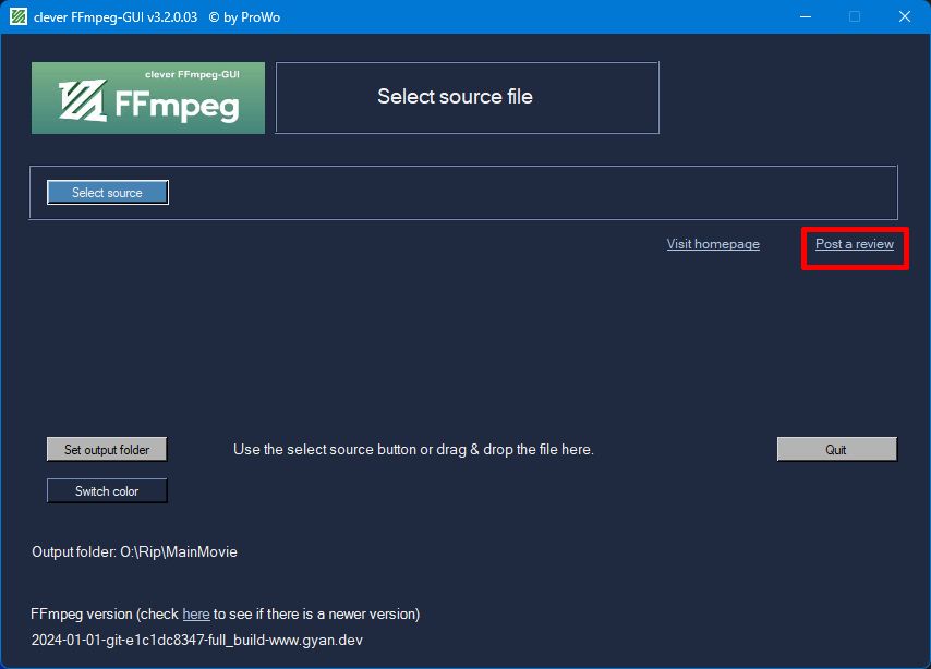

    Leave a positive review.
  13. Originally Posted by ProWo View Post
    Of course, but I don't know how?
  14. Originally Posted by amxcs View Post
    see here
    [Attachment 76031 - Click to enlarge]
  15. Done.
