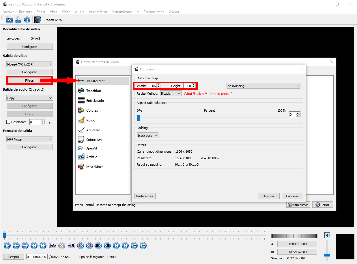

  1. I have video files with the wrong resolution: 1606x1080.
    The correct resolution must be 1490x1080.
    Which of these 2 options should I choose?
    [Attachment 75924 - Click to enlarge]
    [Attachment 75925 - Click to enlarge]
    Mar 2008
    Use swsresize, deslect "lock aspect ratio"., set your sizes, use preview to check

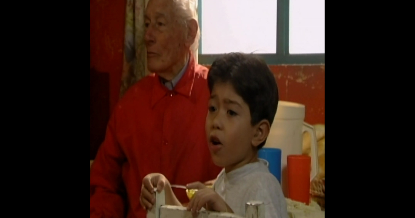

    I checked all the original downloaded videos and then the videos after I edited them with Avidemux (crop and output video format) and there is no difference in the quality.

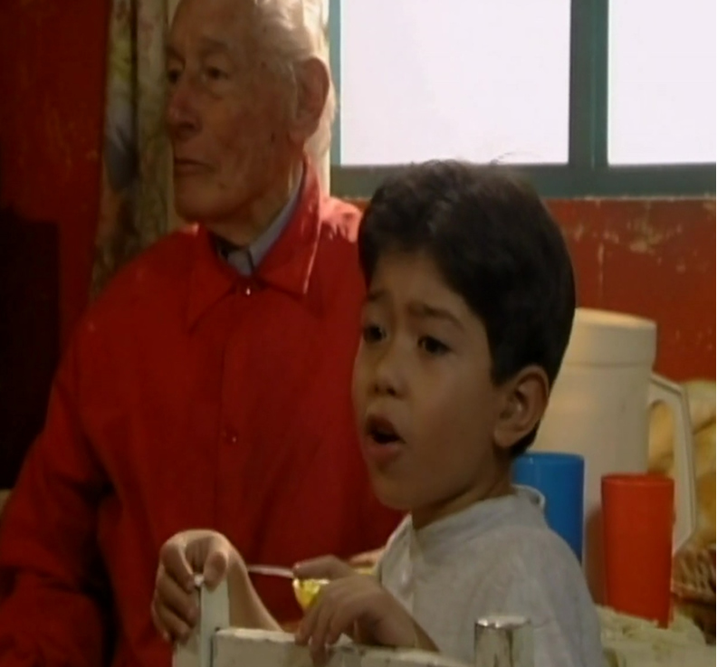

    VIDEO FILE EXAMPLE IN IMAGE FILES:
    This is the original downloaded video file (image):
    [Attachment 75942 - Click to enlarge]
    After I crop the black sides, I get a 1374x1080 video.
    Then I change the width from 1374 to 1440, but I keep the same height of 1080.
    And this is the final result:
    [Attachment 75943 - Click to enlarge]

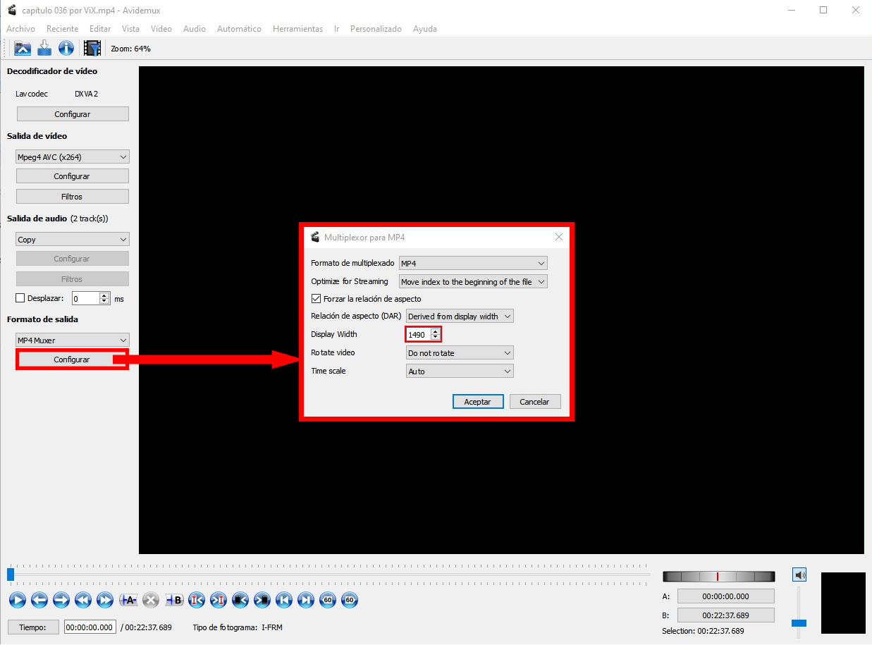

  7. This is how I do it....
    I just want to know if I choose the correct option and configuration in Avidemux.

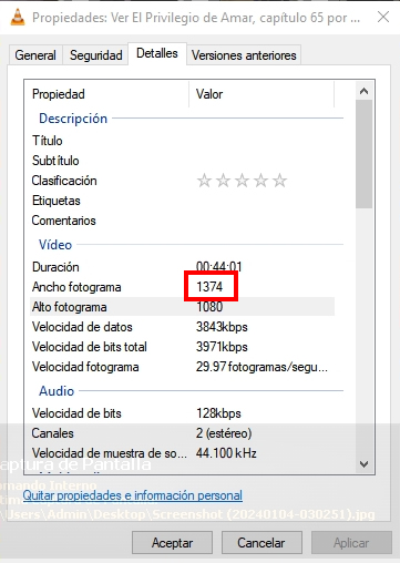

  8. The video files after all editions are ok, have the correct width and look good.
    But when I click on the property and details of the video file, I still see there the wrong width.
    [Attachment 75945 - Click to enlarge]
    Should I redo all these video files which I fixed the wrong way?
    Ok, they work anyway, but should I redo them, or doesn't matter... but just start editing the rest of the files with the right method - swsResize?

    It looks confusing to me, I've never used mp4 muxer/configure/change aspect ratio in such a situation
    like this; you're not really changing the aspect ratio, you're cropping the sides, which is not the same.
    A/R should remain at 1:1. (by this I mean square pixels); image should be 4:3 by the look of it
    Check your source and output files in mediainfo (text view) to see what it says about aspect ratio

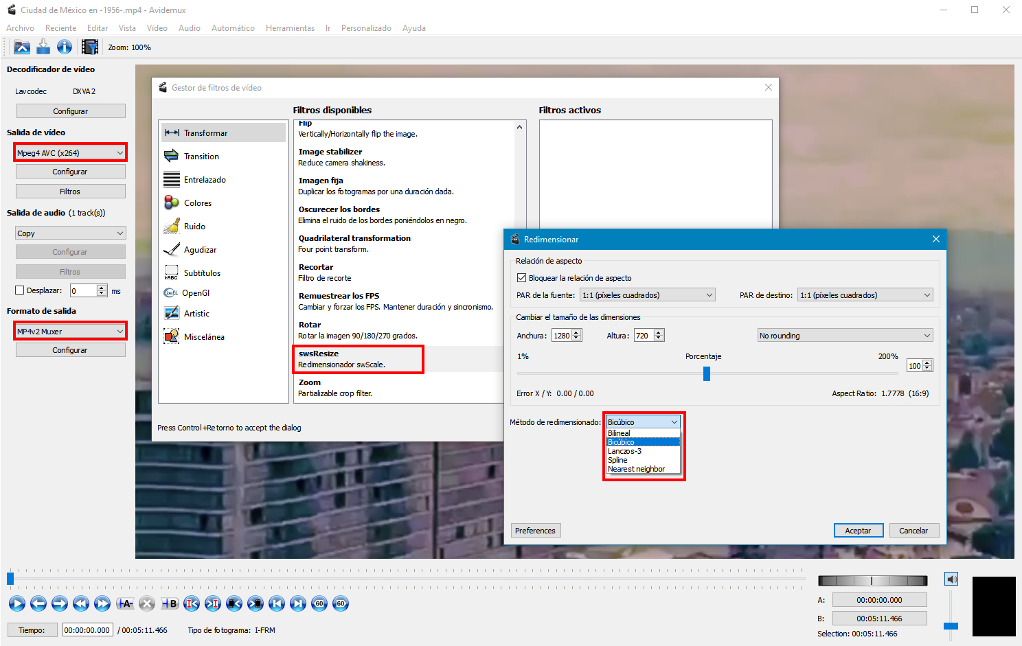

    But what about the rest of the configuration?
    Is it ok like on this screenshot?
    [Attachment 75946 - Click to enlarge]
    Mar 2008
    Yeah that's a bummer, but for full compatibility, it's better this way.
    The way to proceed is to crop best you can, then resize to make it 4:3 a/r using swsresize.
    This way you end up with square pixels - that's always safer
    Do one and check it in mediainfo

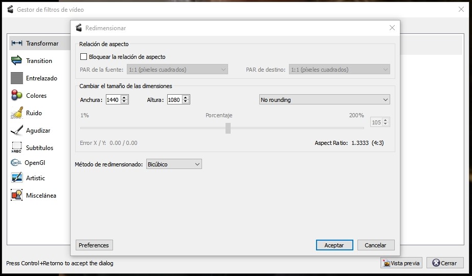

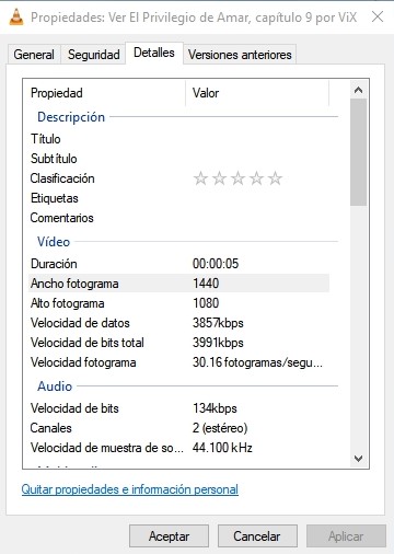

    Ups... When I deactivate the "block aspect ratio", the "square pixels" option is not available anymore...
    Is it ok?
    [Attachment 75947 - Click to enlarge]
    But the final video file shows the correct width in the property's details: 1440x1080...
    [Attachment 75948 - Click to enlarge]
    Mar 2008
    Yes that's OK, it'll default to square pixels. Doesn't it look right when you play it back?
  18. Originally Posted by davexnet View Post
    yeah, it is ok after I save the option and close the window, but when I open this option again, it is already 1440x1080 and the "square pixel" option is available and activated.
    thanks a lot

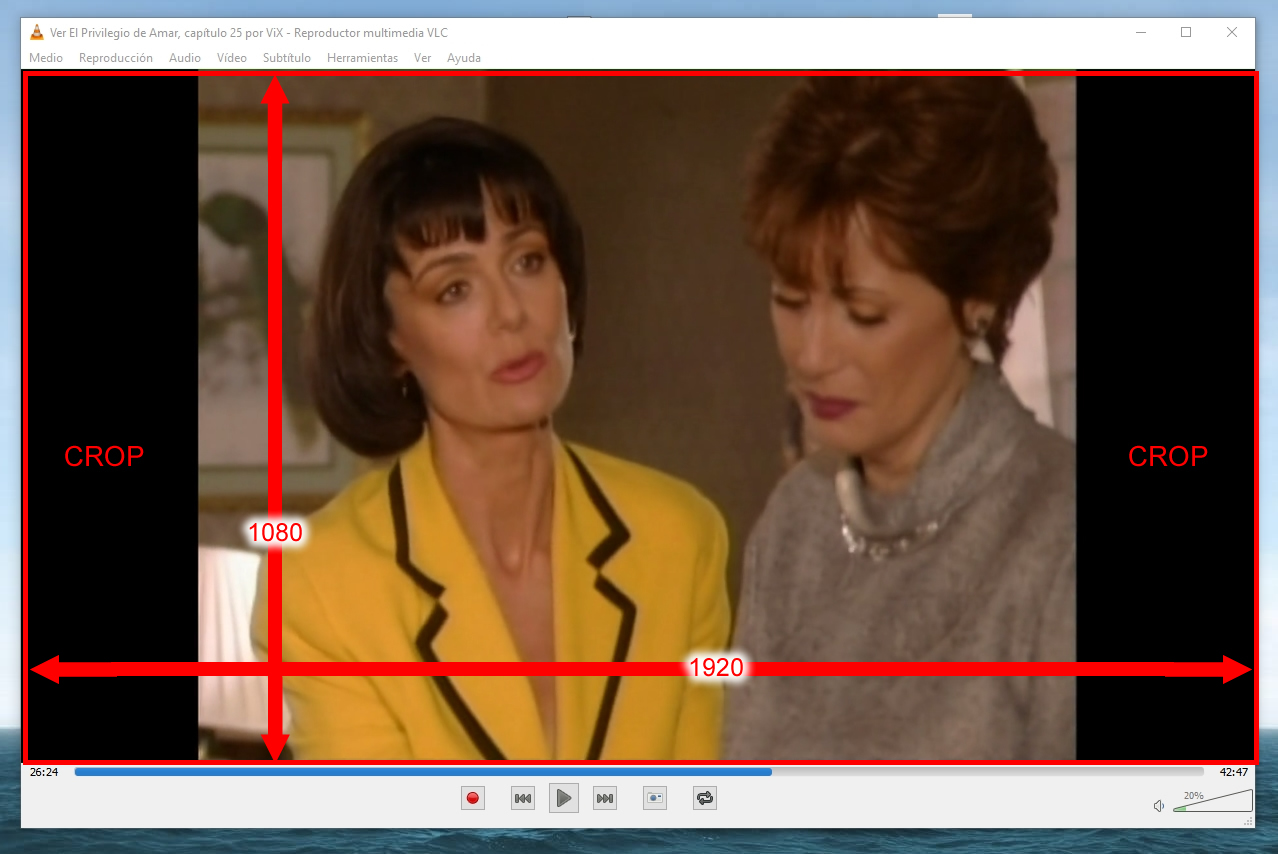

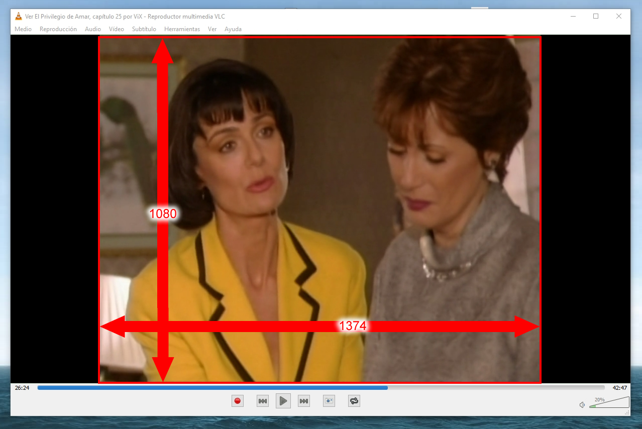

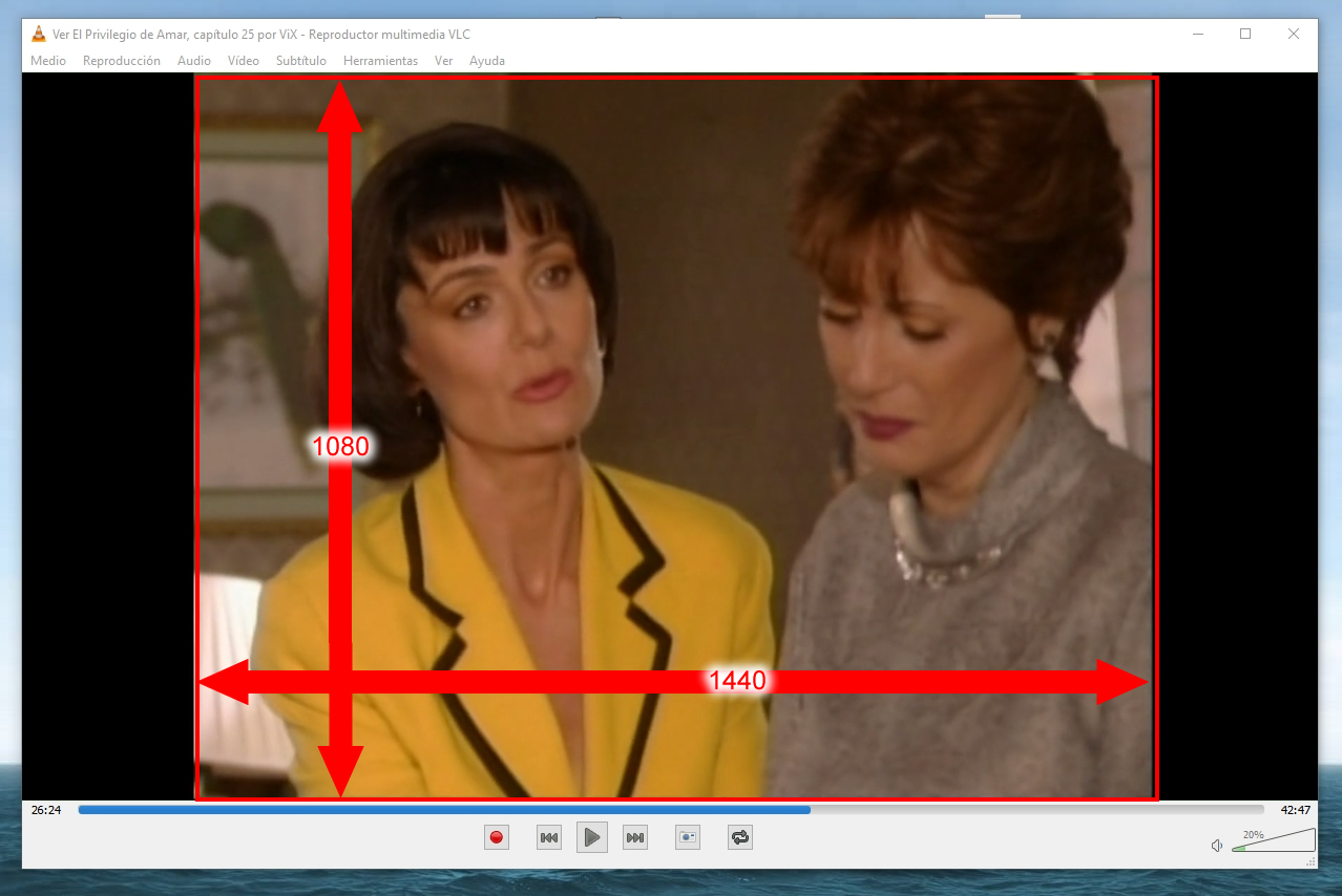

    The streaming platform ViX digitalized some old series without keeping the aspect ratio.
    For example, this series must be 4:3, but they cut the video frame, added black sides, and then stretched the frame to 1920.
    See this red border - this is the frame.
    [Attachment 75971 - Click to enlarge]
    They did it badly and said, "This is the 1920x1080 video".

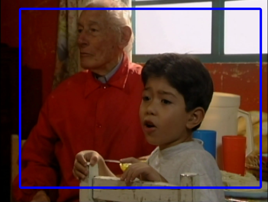

    So, I cropped the black sides and got a very narrow video image.
    See the red border now - this the the frame after I cropped the black sides.
    [Attachment 75969 - Click to enlarge]
    Then I just changed the width, making it wider, to get the correct video image.
    It was 1374 and I made it 1440.
    [Attachment 75970 - Click to enlarge]
    Sometimes the correct width must be 1440, sometimes 1520, sometimes 1430, etc...
    So, first of all, I try to find out the correct width and then add it manually...
    That's why I don't need to keep the aspect ratio... because the initial aspect ratio is not good..

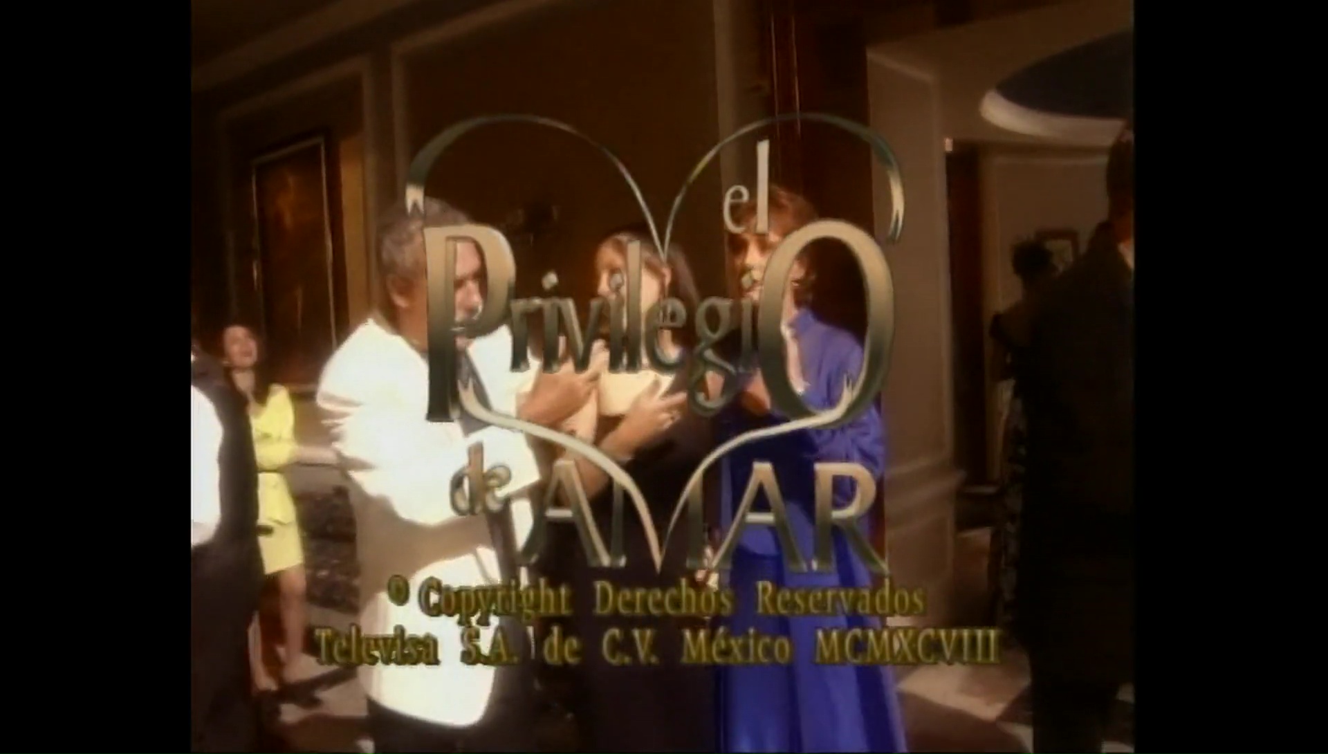

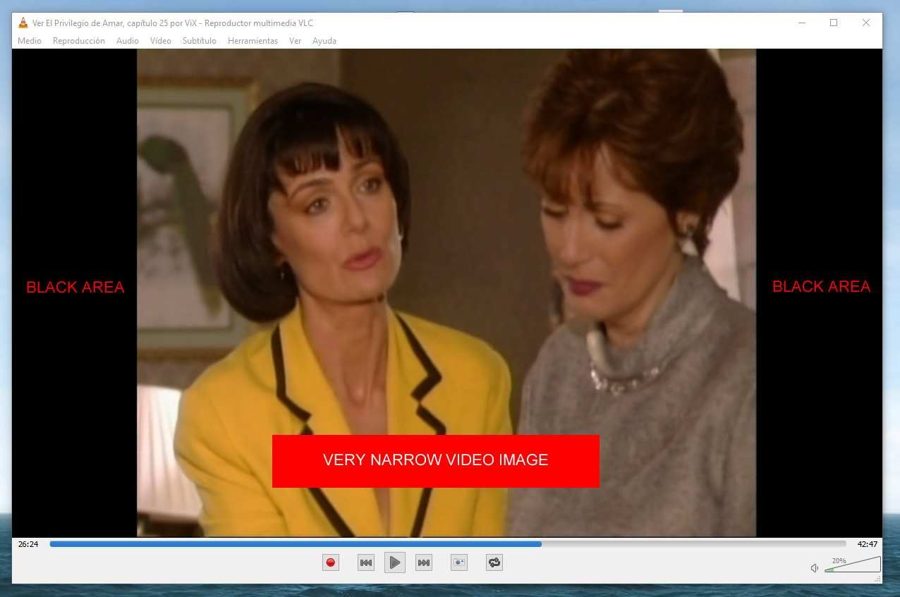

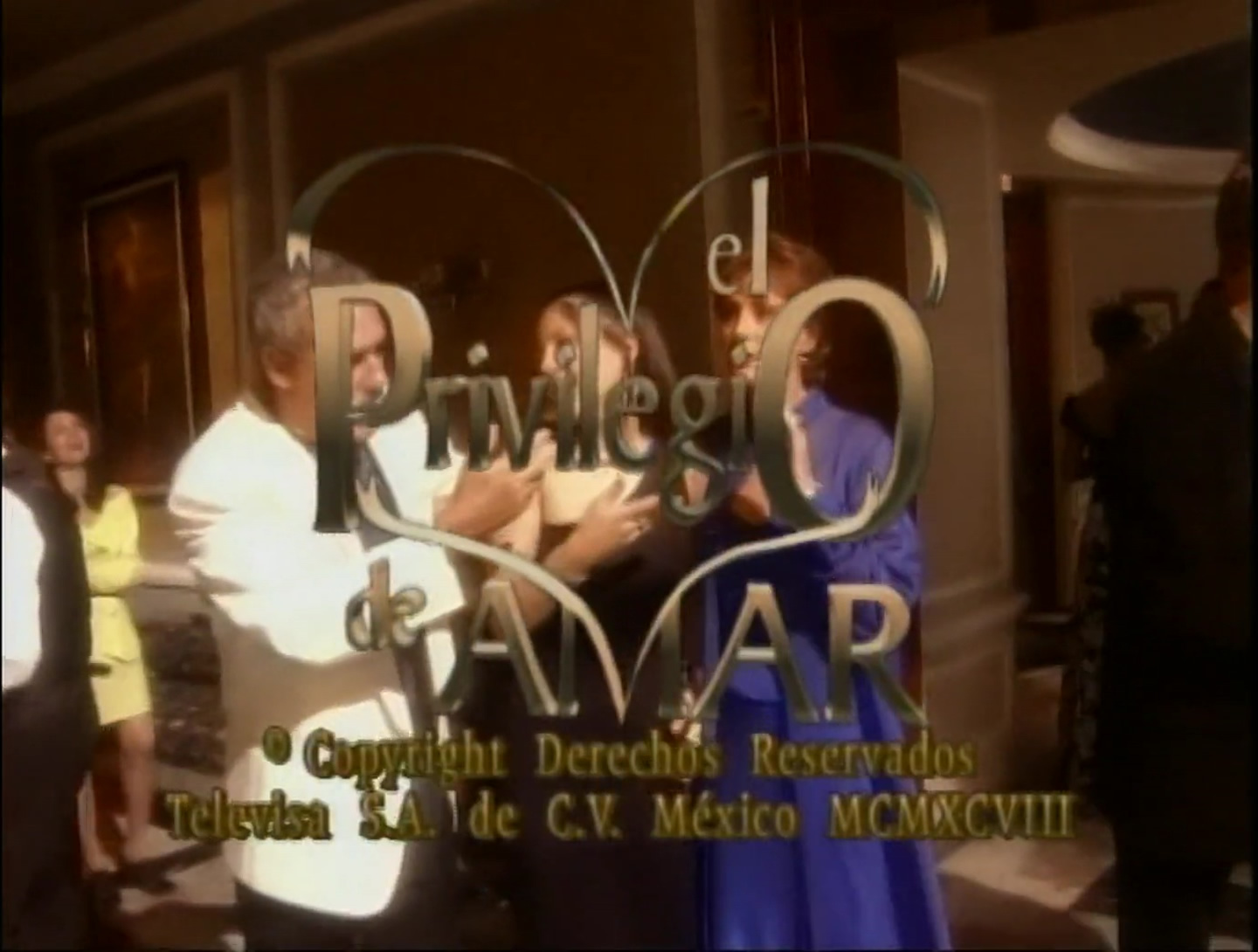

  24. This is what I get from the provider:
    1. Black areas
    2. Very narrow (or sometimes very stretched) video image
    [Attachment 75973 - Click to enlarge]
    So, the problem is not only the black sides but also the wrong aspect ratio.
    I had no idea how to correct the wrong aspect ratio, and used to do it with "video output format" instead of the "swsResize" method.

  28. This is how ViX, digitilizes their videos:
    They take a good TV format video and mark any random area as the active area:
    [Attachment 75974 - Click to enlarge]
    Then they cut this active area and sometimes stretch it, sometimes making it narrow:
    [Attachment 75975 - Click to enlarge]
    Then they add black sides:
    [Attachment 75976 - Click to enlarge]
    Then submit it to the streaming platform and say "Our dear viewers, here's a 1920x1080 HD video for you"
