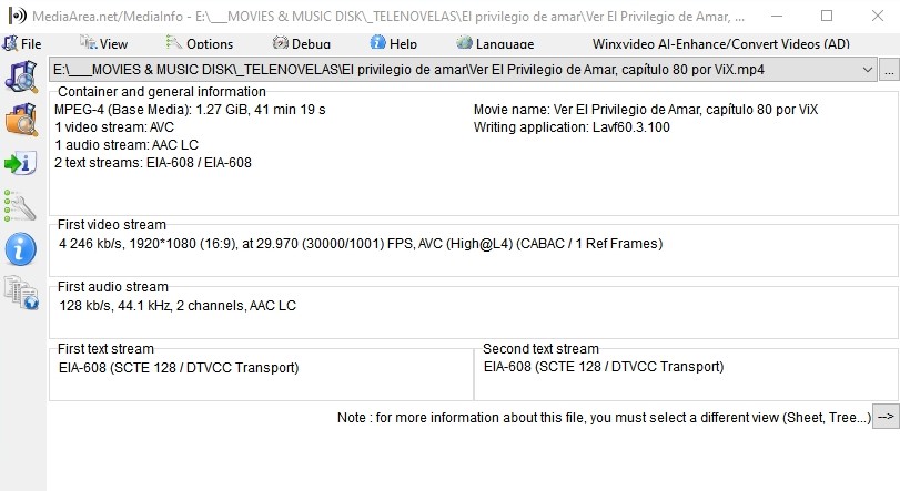

    This was the original file:
    [Attachment 76001 - Click to enlarge]

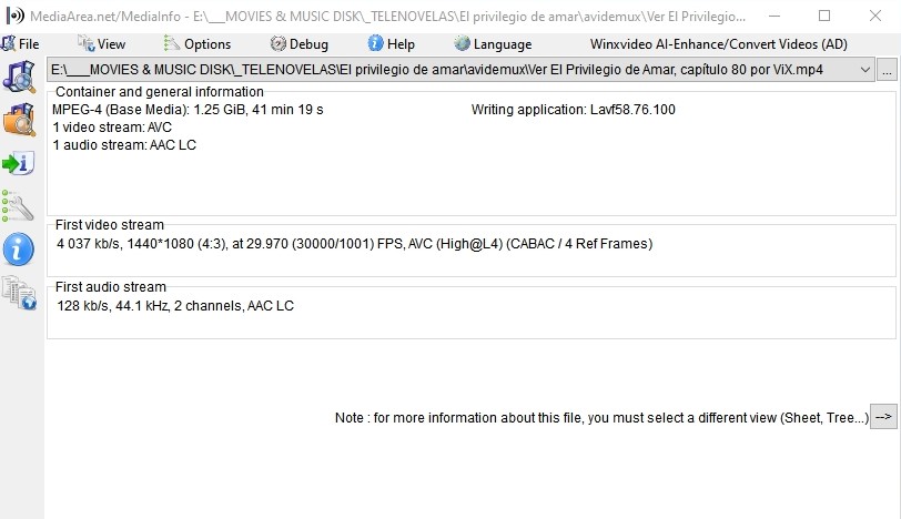

    This is an already edited file.
    [Attachment 76000 - Click to enlarge]

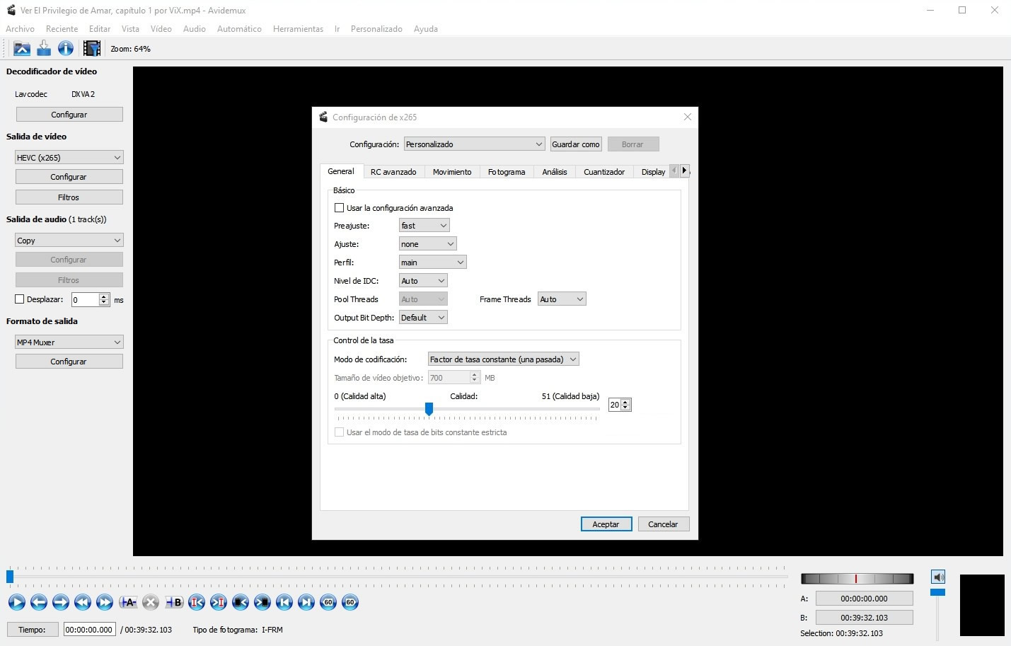

    You could also try HEVC (x265), should be fully compatible with devices newer that 6 - 7 years.
    Should give some savings on size vs. a similar x264 quality
    Set it up like this:
    See these results:
    This is the original video, as it was downloaded from ViX.com
    1,3 GB video file and the overall bitrate of 4324
    [Attachment 76011 - Click to enlarge]
    This is the same video, but x264 + crop + swsResize:
    1,2 GB video file and the overall bitrate of 4024
    [Attachment 76010 - Click to enlarge]

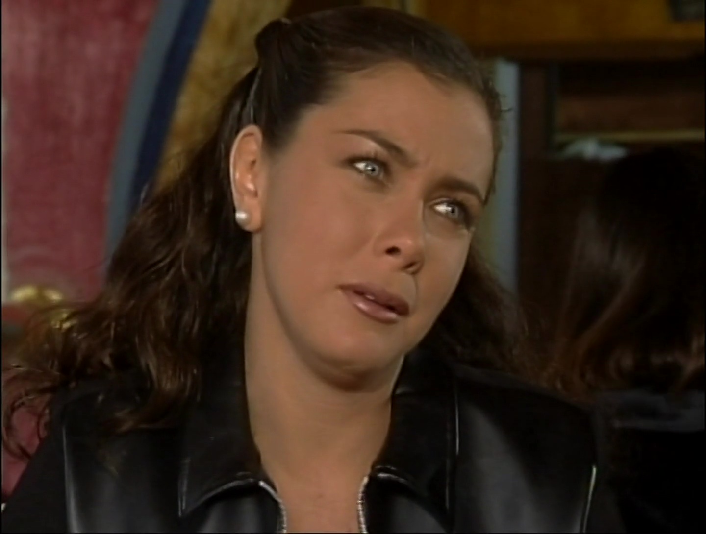

    I opened them both with 200% zoom, I cut the part with the face, it looks the same in both images.
    https://forum.videohelp.com/attachment.php?attachmentid=76014&stc=1&d=1704430717

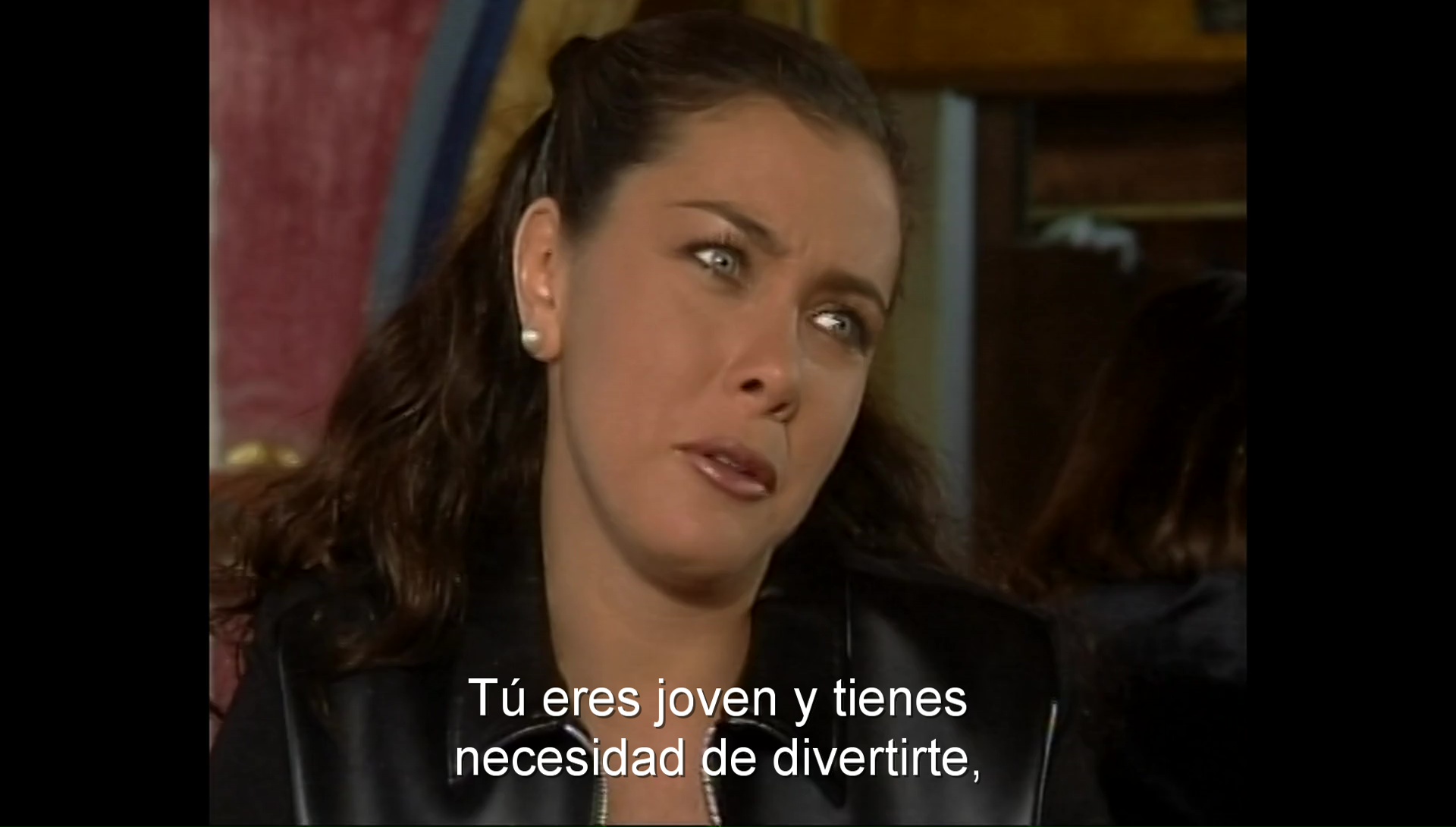

    HEVC (x265) + crop + swsResize
    Mpeg4 AVC (x264) + crop + swsResize
    Originally downloaded from ViX

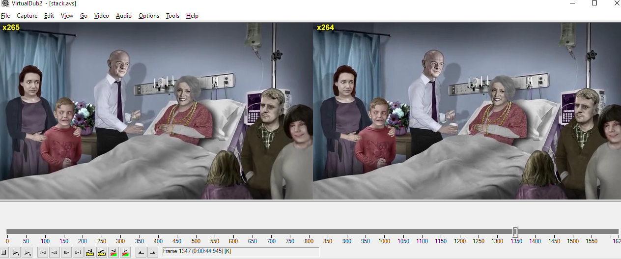

    Are you familiar with Avisynth? You could code a simple script to put the two videos
    next to each other and look at the same frame from each at the same time
  14. Originally Posted by mayazir View Post
    Have a look at these three, see if you can see what I mean
    No, but I can open 2 files with a normal player, I use a VLC player, and sync both videos.
    I usually do it to see the difference, it is not so difficult to sync 2 players.
    I didn't notice any plastic effect on x264 and x265 files.

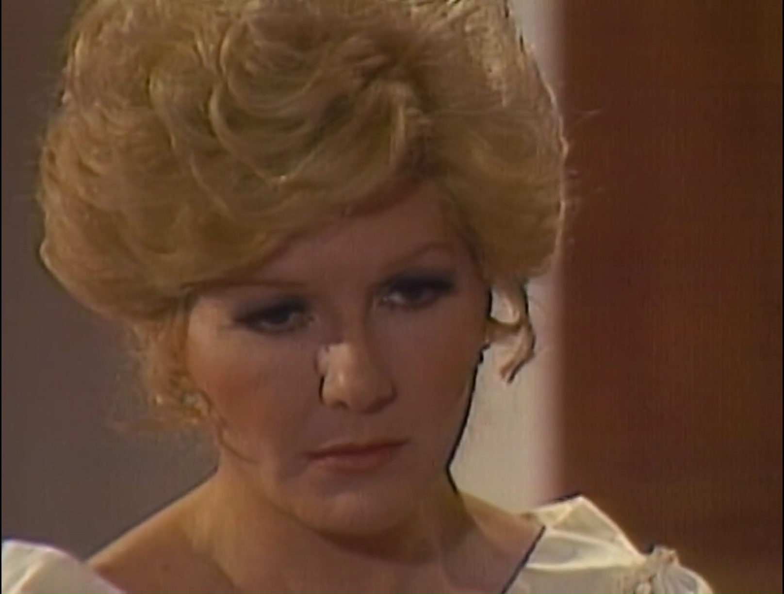

    For example, this one is 4200 bitrate.
    [Attachment 76042 - Click to enlarge]
    And this one is 5600 bitrate
    [Attachment 76043 - Click to enlarge]
