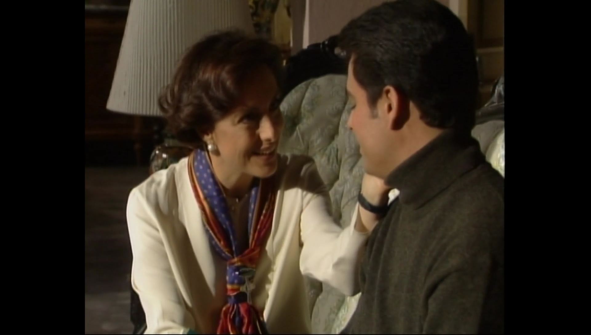

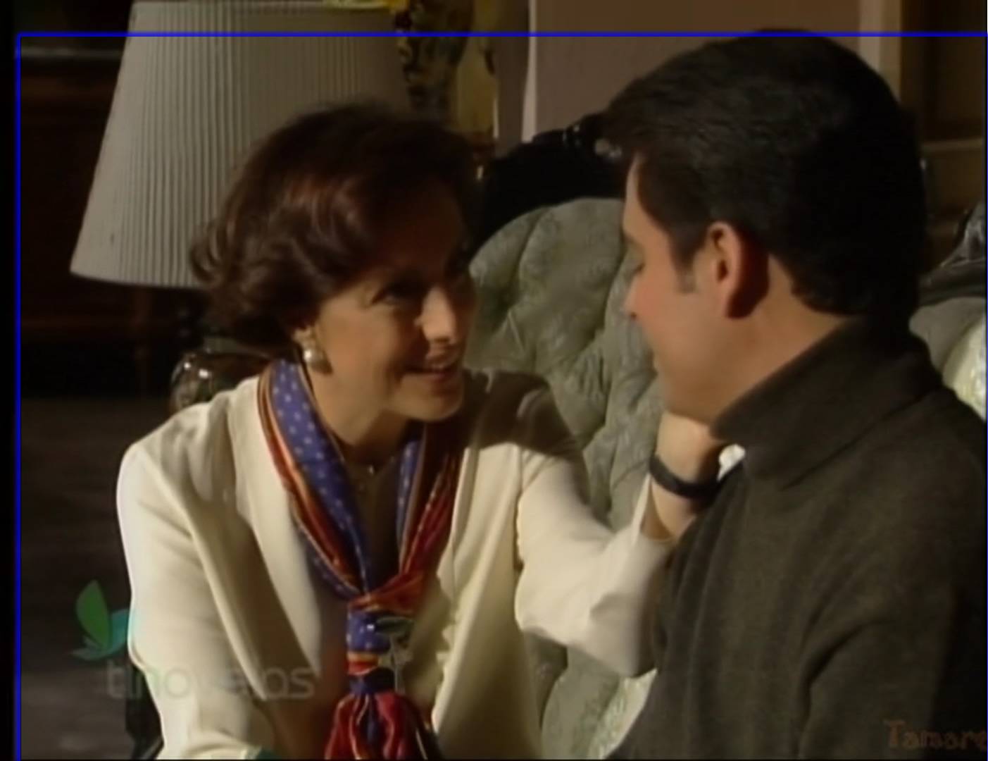

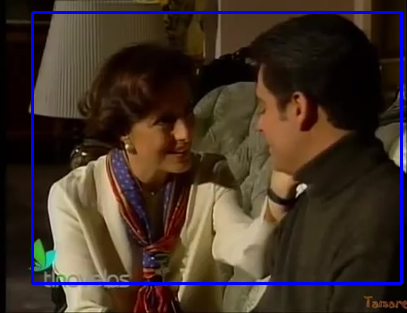

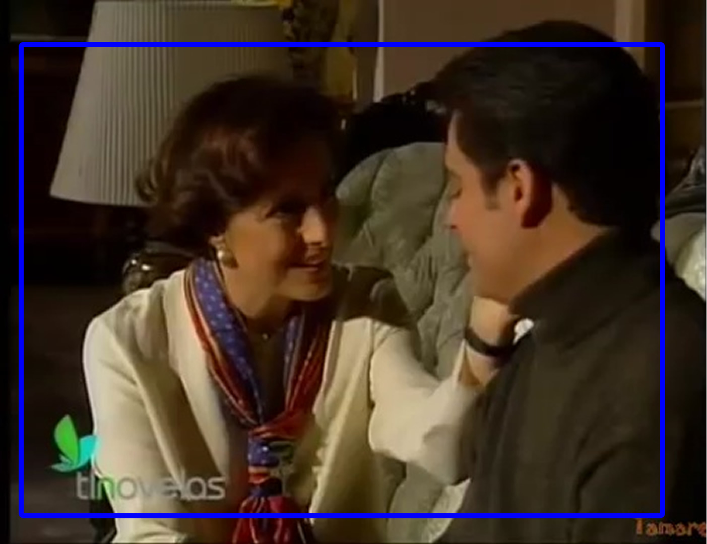

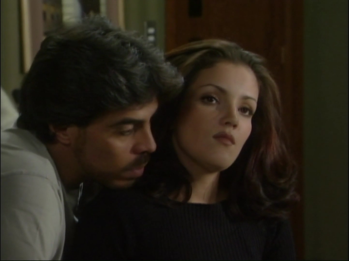

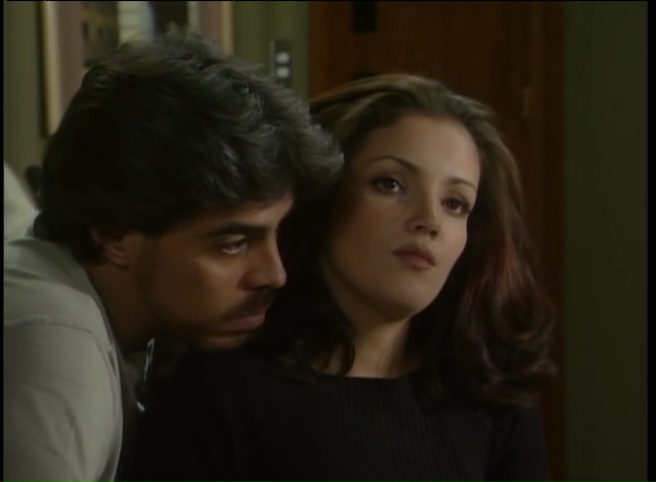

    Here you can see the original TV format screenshot:
    [Attachment 75977 - Click to enlarge]
    Here you can see the screenshot of the same episode from ViX:
    [Attachment 75978 - Click to enlarge]
    And here you can see how I put the already fixed (it was very narrow) 2nd screenshot on the TV screenshot and marked the active area with a blue border:
    [Attachment 75979 - Click to enlarge]
    And this is not the worst choice of the active area, for example, this episode is ok, but there are a lot of episodes and series where the active area is chosen randomly. I use this image to give you examples of how they chose the active area for other series or episodes:
    [Attachment 75980 - Click to enlarge]
    Or this way:
    [Attachment 75981 - Click to enlarge]

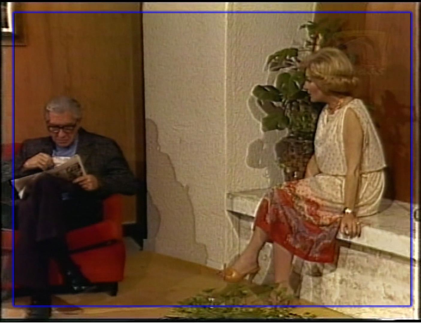

    Here I show you the example of another series with a marked active area, see the difference between the TV format and the ViX version.
    I used the same moment screenshot from the video from ViX and the video I have from the TV version, I put the ViX screenshot (with some opacity) on the TV screenshot and they matched in the same moment:
    [Attachment 75982 - Click to enlarge]
    I talk about the series or movies I know well and you may not know about how it was originally done, but I know it.
    I can't submit here any video as an example, but if you want to see the videos, and if you are from the USA or Latin America, you can see them on ViX.com In other countries, you need to use VPS.
    Check these series to see what I am talking about:
    El privilegio de amar
    La mentira
    La usurpadora
    El juego de la vida
    I have no idea about the rest of the series, I only wanted to have these.
    But I think all old series on ViX are digitalized the same wrong way.

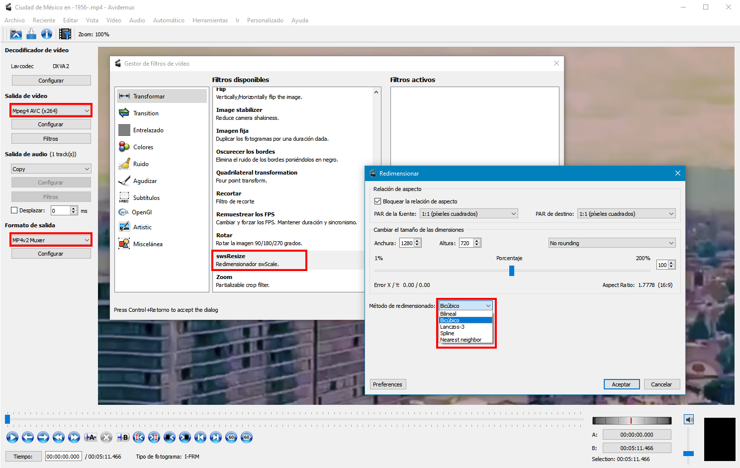

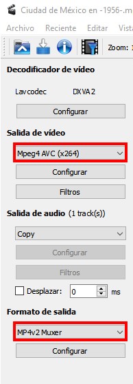

    So, this is the screenshot, should I change here something else or it is ok?
    I don't want again spend 1 month and edit 300 videos again and then pay attention I could do it better.
    [Attachment 75985 - Click to enlarge]
    I mean these:
    [Attachment 75986 - Click to enlarge]
    and this:
    [Attachment 75987 - Click to enlarge]

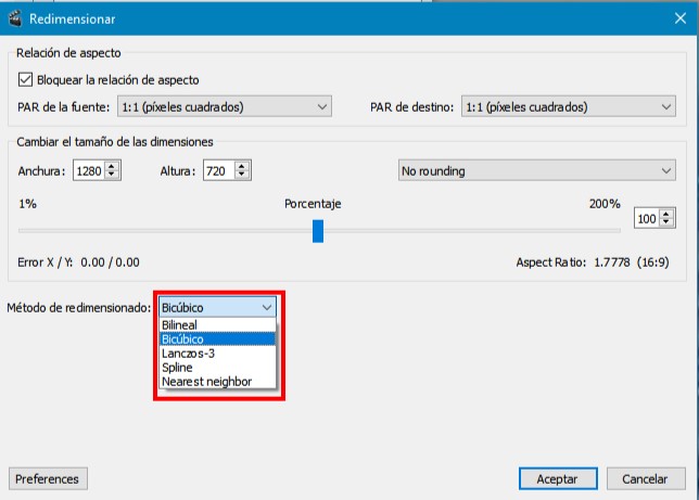

    Mar 2008
    Did you you try any of the other resizers? Bilinear will be softer, lanczos and Spline slightly sharper.
    What about your x264 settings? Did you open the settings and make any adjustments?

  13. Originally Posted by davexnet View Post
    This is what I need - suggestions for better quality.
    I tried x264 just because it looks familiar to me.
    Should I try another format?
    The original file is mp4
    Ok, I will try bilinear and other ones.
    I modified a lot of videos using x264 and bicubic (as on the screenshot) and then I made screenshots of the original video from ViX and my edited version and they look almost identical. I tried also with another soft but the best quality was with Avidemux.
    I am not a pro and don't work with video files, only if I want to edit some movie for my collection, and in this case, I only check the visual difference.
    But I have no idea if I should pay attention to something else choosing the best method for this kind of edition.
  14. Member DB83's Avatar
    Jul 2007
    Another format is not going to help. You are at the mercy of the original encoding as was downloaded.
    When you come to encode in avidemux you can limit further loss of quality by chosing a CRF of 18 to 20.
  15. Originally Posted by DB83 View Post
    Yes and No. That will simply resize. The corrupted active video may still be corrupted but you will have more scope by un-checking the top box and then you can simply change the horizintal without changing the vertical

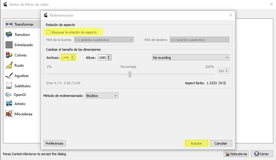

    Do you mean the swsResize?
    First I deactivate the "keep aspect ratio" box.
    Then I put the correct width, which I already have previously calculated:
    [Attachment 75988 - Click to enlarge]

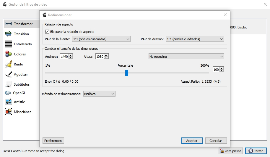

    Then, I open swsResize again and see the deactivated box is already activated again but with the width number I put there.
    [Attachment 75989 - Click to enlarge]
    Do I do something wrong?

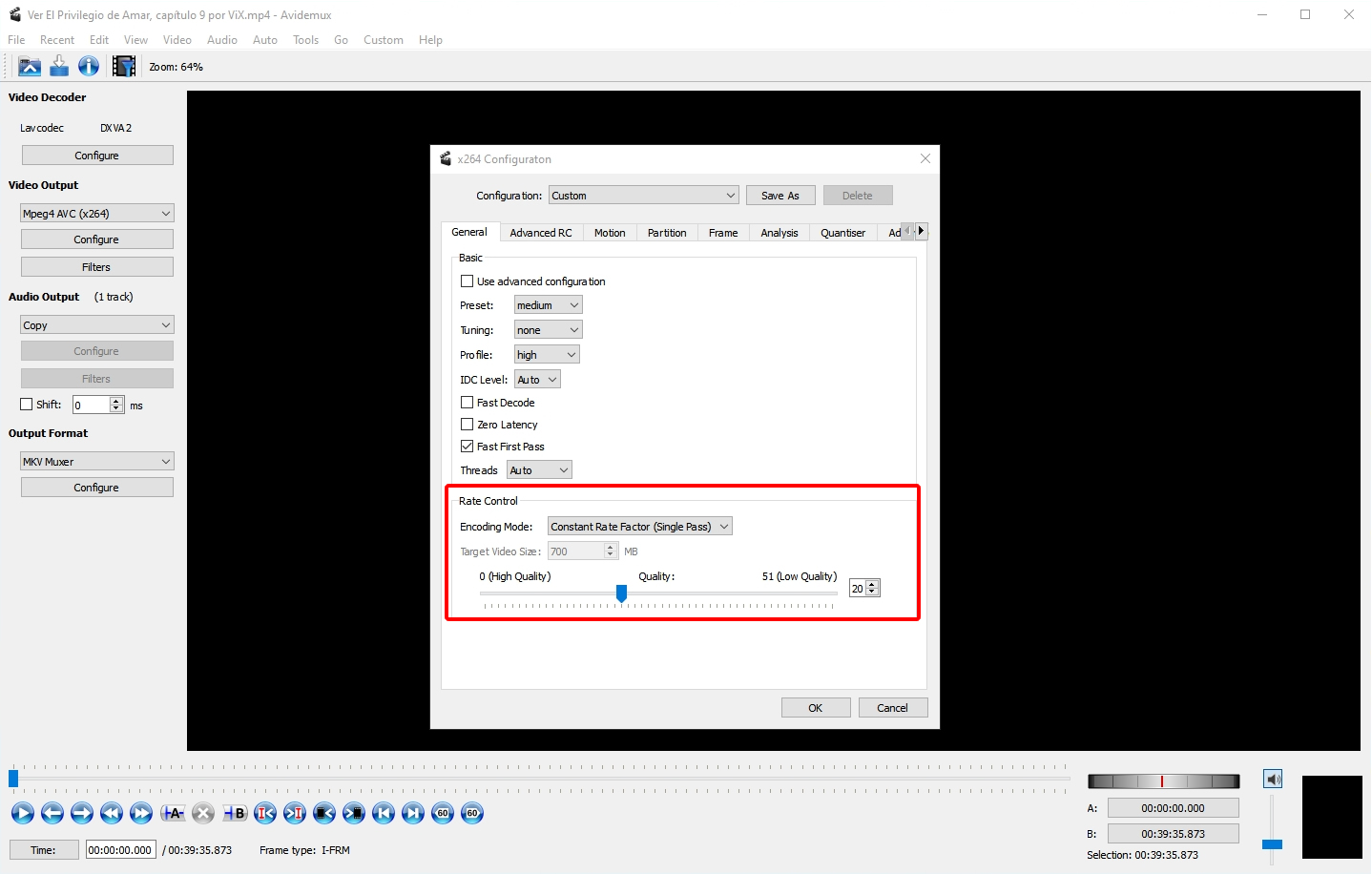

  16. Originally Posted by DB83 View Post
    So, MPEG4 AVC x264 is ok? And no need to try other options?
    Where and how can I do it?
    What is CRF?
  17. Member DB83's Avatar
    Jul 2007
    Under Video Output, click on 'Configure'
    Select "Constant Rate Factor" under 'Encoding Mode'
    Move the bar or select the desired number
    Hit 'Ok' takes you back to main screen to save your video

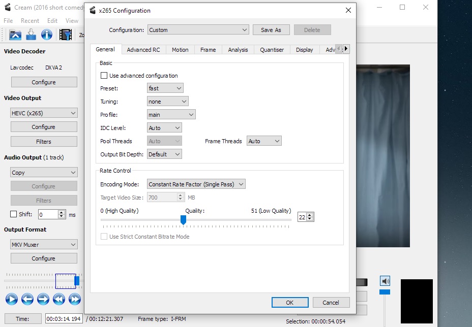

    You could also try HEVC (x265), should be fully compatible with devices newer that 6 - 7 years.
    Should give some savings on size vs. a similar x264 quality
    Set it up like this:
  19. Originally Posted by DB83 View Post
    It was 20.
    Should I make it less?
    What is the best?
    Why do you say 18-20 if I can make it 0 for example?
    [Attachment 75992 - Click to enlarge]
  20. Originally Posted by davexnet View Post
    I will try this configuration.
  21. Member DB83's Avatar
    Jul 2007
    You can make it less. 0 will substantially increase the video size without any percieved increase in quality due to the already compressed original. 18 is a reasonable compromise.
  22. Originally Posted by davexnet View Post
    But the Output Format must be MKV or it was a default one and you just forgot to change it?
    I thought if the original file was mp4, then the output also better was to put as mp4
    [Attachment 75993 - Click to enlarge]
  23. Member DB83's Avatar
    Jul 2007
    mp4 and mkv are just containers. Our friend, I guess, did not pay attention to the output format. x264 andx265 are the actual codecs that do the work.
  24. Member
    Mar 2008
    mp4 or mkv is fine (doesn't matter about the source) as long as the container supports the video/audio codecs and your devices
    can play them. Mp4 has the benefit of being better supported in Windows 10 (thumbnails, etc.)

    BTW, one of the series I downloaded weighs 1,43 gb each episode of 45 min.
    Each video is 1920x1080, but after I cropped the black areas, the video became 1444x1080 and started to weight 1,43 BG.
    Here is the screenshot of the video quality:
    [Attachment 75994 - Click to enlarge]
    I have the same series and the visually the same quality... almost.. but almost the same... very close to the original.
    Each episode weighs around 250 MB and is 654x480, but when I open it a full screen, it has almost the same video quality as the one downloaded from ViX. Here is the screenshot of the video quality:
    [Attachment 75995 - Click to enlarge]
    How could they do it?

    and another important point is to choose the right resize method - bicubic, bilinear, etc (better try them all).
    and the most important is to do all changes at the same time and only save the final result after cropping, resizing, and adding an extra audio track if needed.
