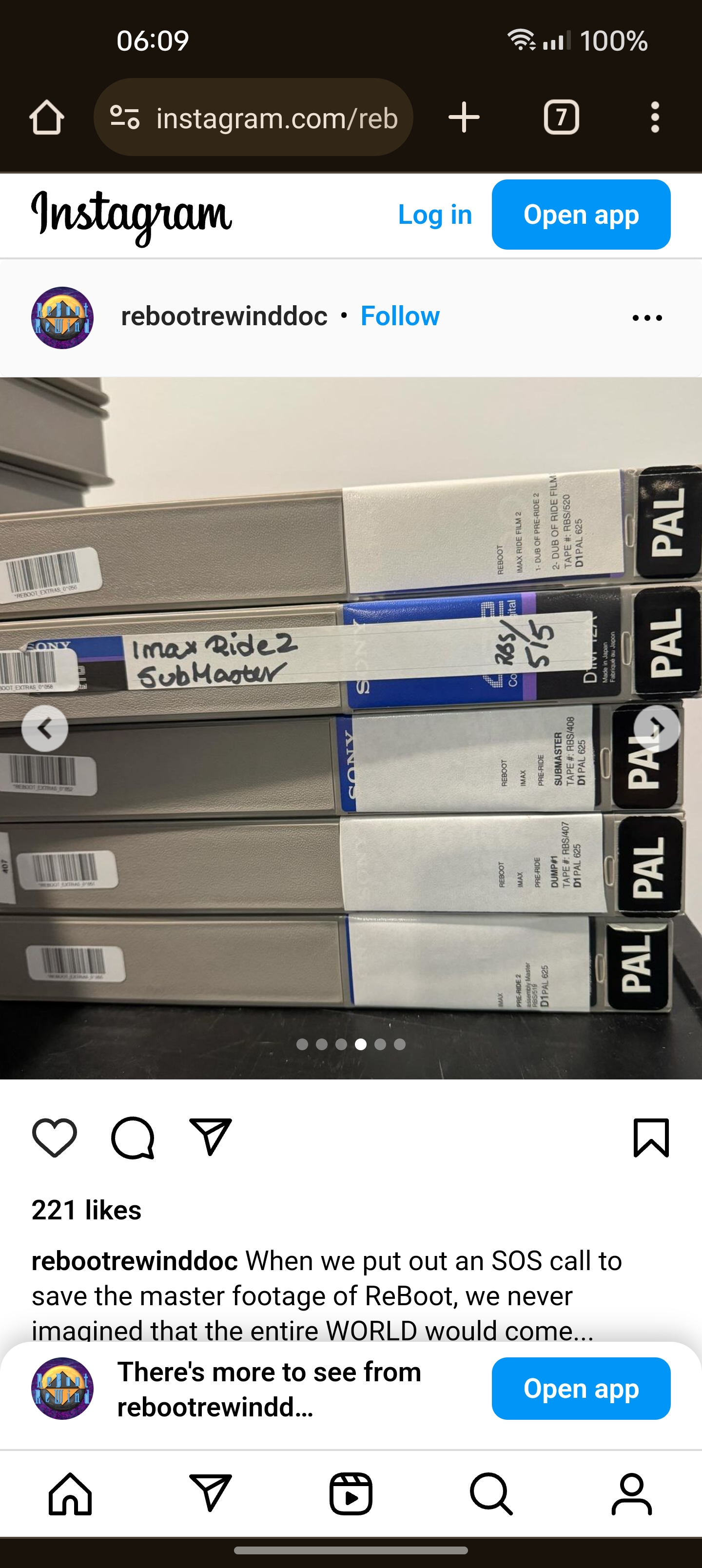

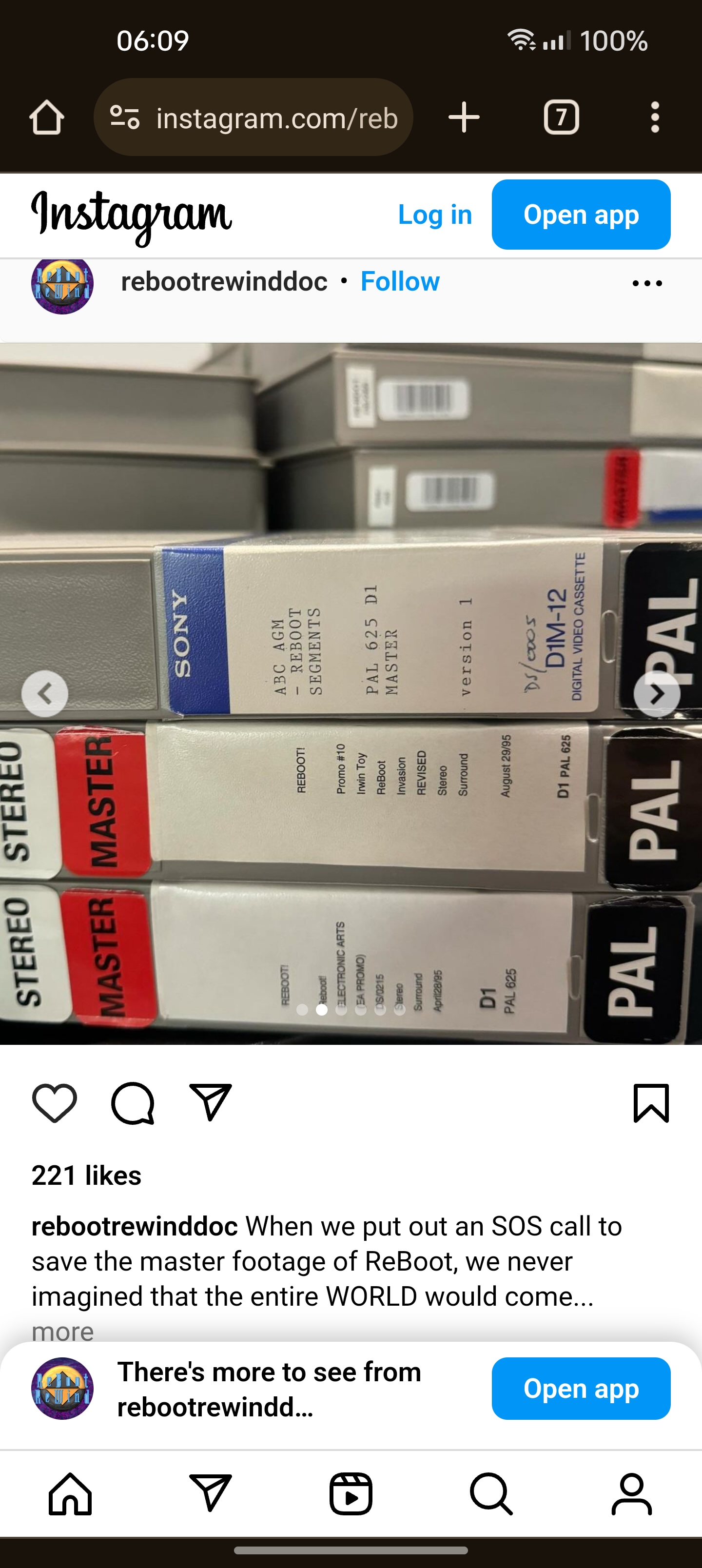

    From the picture in the link above, the tapes look too small to be D1, Though D1 did have smaller sizes for 30min and 6min. Do you mind posting some screenshots of the tapes themselves to see if I can identify them?
  5. I am not the person directly involved, just trying to do a good deed.
    I took these screenshots from their Instagram (here's the link in case you want to look directly)
    https://www.instagram.com/rebootrewinddoc/p/C1M8EoJrHCa/?img_index=6
    Guy I spoke to on Reddit just said they need a Bosch unit (specifically referenced the BTS DCR-500) because the Sony units would require modification to play them. So maybe they are a weird size?
    Also, from what I understand they're in Quebec.

    It may have something to do with speed, Even Sony had 3 versions of each model, The only thing the Bosch models have and Sony don't is the dynamic tracking of the video heads, Other than that, pretty much Bosch is made for European PAL market and Sony for US and Japan NTSC market, nevertheless, I believe both brands supported PAL and NTSC, Here is the breakdown of all models:
    Sony:
    DVR-1000 - First model, very bulky, requires processing unit attached to the main tape transport.
    DVR-2000. Off-Speed ​​version DVR-2000/OS, Second Off-Speed version DVR-2000SP.
    DVR-2100. Off-Speed version DVR-2100/OS, Second Off-Speed ​​version DVR-2100SP.
    Bosch BTS:
    DCR-100 - First model, very bulky, requires processing unit attached to the main tape transport.
    DCR-300
    DCR-500
    Note that some models differences are just in I/O availability for audio and video, But what they really need to transfer their tapes losslessly is the SDI out port only, SDI streams the full 4:2:2 YCbCr 720x576 video un-altered with up to 4 audio channels all in one BNC cable.
  7. So they are going to have to find a Bosch unit.. preferably a smaller one. I imagine they're even more rare than a Sony unit?
    Edit: now that I think about it, I wonder what the reason is they need a Bosch specifically? I'll ask the dude on Reddit.

    That series was made in Quebec, so should be NTSC as original masters, but since those say PAL, they are either systems conversion masters meant for overseas distribution, or (rarer) those are re-renders in PAL format.
    I agree, these should be treated carefully and professionally, both technically and legally.

    Me too, I don't understand why they insist on finding a deck that is harder to find than a unicorn, Plus as mentioned above, even if they find one it will need a serious maintenance and calibration, those are not plug and play machines like VHS, They require broadcast know how. The format stored on tape is not obscure, it is rec.601 SD digital that we all know, About 70GB/hr in a lossless compressed format, They can take the tapes themselves to a service and ask for raw footage with no encoding, Put the files online and let the nerds be creative, They can make good looking 4k 4:3 files out of them.
  12. This is what I got back:
    From what the former MFE tech guys have said, it'd be better for the tapes and playback if they used a BTS DCR-500. The Sony model MIGHT play it, but it may not be 100% correct.
    So maybe the tapes are degraded and the variable speed is important?
    I imagine they should/will probably find a professional.

    I believe it is more of the Bosch's dynamic tracking capability than a speed issue, If speed is different you don't get any signal. This is why you let people with the right gear handle this. Usually people who are versed into transferring these formats have good technical knowledge about them vs the consumer market where anyone with a Walmart VCR-DVD combo is open for business.
    I left them a message to come here and discuss their needs so we can assist them better, Also we would like to hear from any technician was involved in this format.
    Made in Vancouver, but it's originally PAL. Why? The co-founders/co-creators of MFE/ReBoot were from the UK and as such knew PAL had benefits over NTSC for animation. A larger resolution (720x576 vs 640x480) and the 25fps progressive framerate was closer to traditional 24fps of 2D animation.
    So ReBoot and all other MFE shows were originally rendered in SD PAL, and converted to NTSC for broadcast in Canada and other regions using that format.
    You and they are fooling yourselves if you think the legal wrangling is going to be that easy. Just because those were "found" (perhaps even abandoned) doesn't make them not still the property of the original production company.
    They found them as in MFS allowed them to go into the archives and the tapes were there. Why MFS didn't put out a post at some point between the "purge" by their former President and now stating the tapes were safe and secure, is anyone's guess.

    Ok, didn't know that about the production (makes sense), was going off of Wikipedia info which said Quebec (maybe that's where the masters are stored now?). 25fps vs 24 would not even be an issue now, but that was the era of transition so it was probably prudent, especially with expected worldwide distribution.
    Ok, so they are ASKING for just a D1 machine, not asking for assistance transferring (which *would* require shipping), and they are very likely not going to assign dupe rights to others, regardless.
    That narrows the options quite a bit. Would have been better to be forthright up front. Edit: I see, you did state that originally, but then got led off on a tangent.
    I would say there are 2 ways for them to go:
    1. Get a (close to ) working Bosch DCR-500, and pay to have a certified engineer fully restore and tune it up. Very expensive unless they already have an in-house engineer of that caliber (and then it is still expensive).
    2. Convince them to change their mind and ship (using bonded shipper that has experience with master tapes), going to a commercial transfer place (NOT consumer-focused!!) in UK/EU that has one of those kept up Bosch units. Would probably make sense for them to contact other remaining production houses to see where they recommend. Would also be expensive but probably not as much as restoring a resold unit in the wild.

    No, Actually D1 NTSC is 720x486 60i, meaning 60 fields a second, PAL 720x576 50 fields/s. The CGI interface could render 30 or 25 progressive frames a second but it has to be split into odd and even fields since the format does not support progressive, this is 1986, progressive was only possible on film, But it's still interlaced until de-interlaced after transfer by blending the two fields. I'm not really familiar with how those graphics machines work but once the tapes are transferred into files it's easy to examine the fields.
    Anyway, the Last two versions of Sony machines DVR-2000SP and DVR-2100SP are capable of playing back the following field rates: True 60 f/s (fields a second), 59.94 f/s for NTSC, and 50 f/s, 47.952 f/s, 49.95 f/s and 48 f/s in PAL.

    That's what I was trying to explain to them on other platforms, Not only the transport of such a heavy machine is a problem, the cost too, no one is willing to give away a priceless machine like this, A lot of collectors are watching for these rarities and are willing to pay a lot of money for them, especially the D1 format, it is a very special format, this is the format that defined analog video capture and rec.601 that we know today, It's like the foundation of the constitution.
    Make an appointment with a transfer facility, one of them can take the tapes there with some hard drives, stay one or two nights until the transfer is complete and go back, Once the files are on HDD I'm pretty sure a lot of folks are willing to help with processing the files (de-interlacing, upscaling and encoding to a playable format).
    Also I don't get why only the Bosch units can work, Sony made revisions to their last two models as I explained in my above posts, They can playback several frame rate of the PAL format.
  30. Member Cornucopia's Avatar
    Yeah, I remember when they came out in the mid-late 80s, they were ~$180k for the machine alone, not counting peripherals. And then there would be the need to keep them in top shape (specialize engineers).
    Even at 1/20th of that price (not likely because they hold their value) you would still be talking $9-10k, and still need it to be tweaked upon destination.
